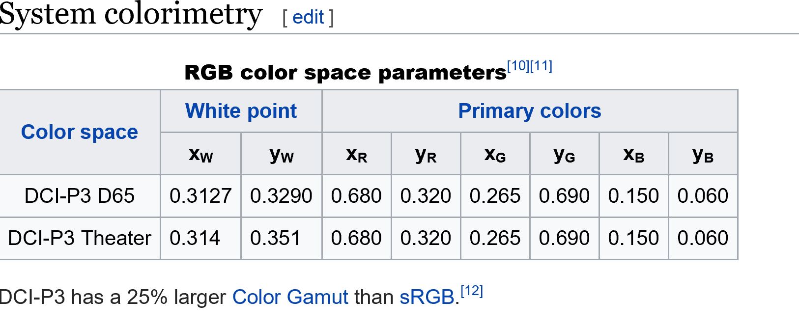

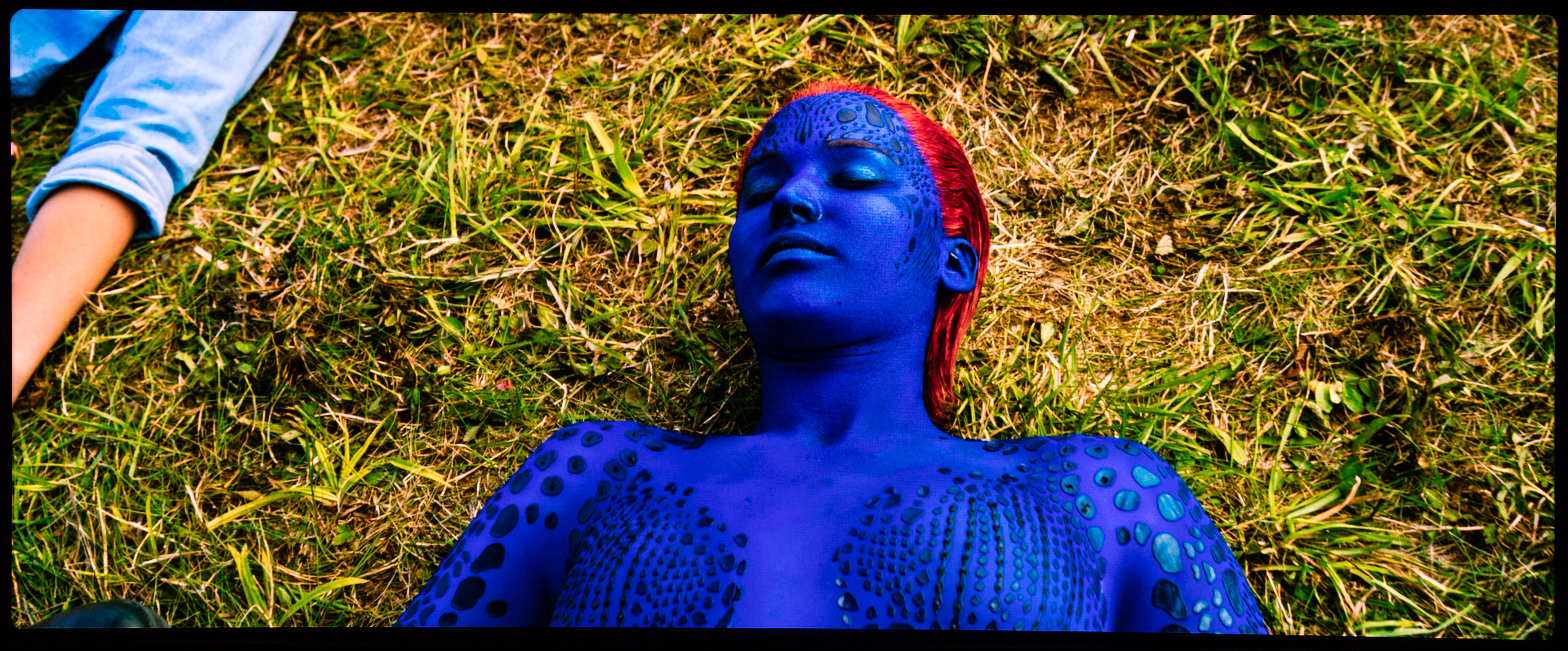

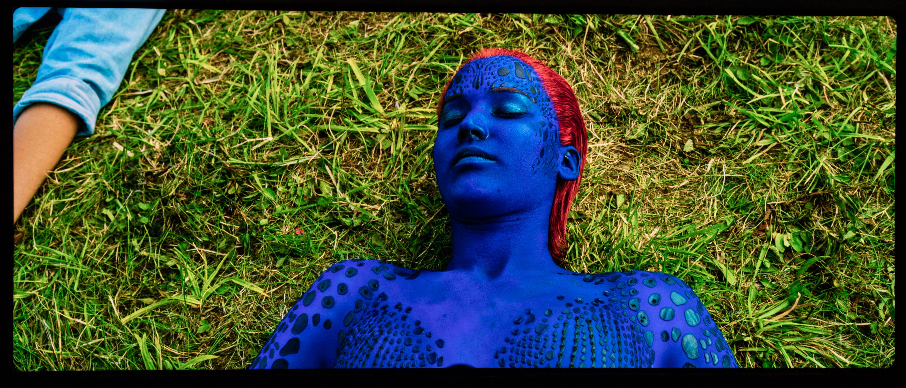

    I found out that there are 2 different DCI Color specs there!
    The coordinates are 100% the same but the white points are different!
    See here a picture.
    So when I change the white points to D65 bingo now the color looks almost 100% perfect.
    So looks like all UHD Disc are made for the DCI P3 color with D65 and not for the Theater DCI P3 Standard.

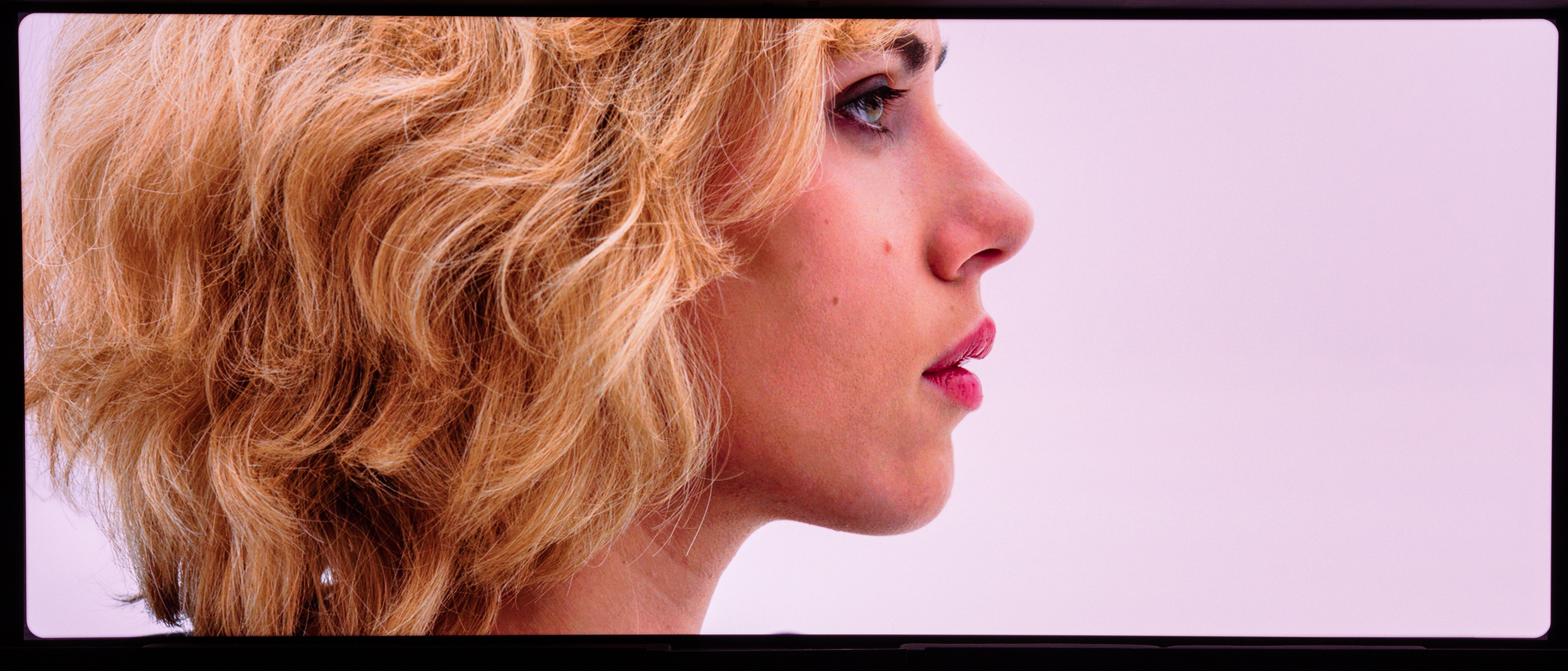

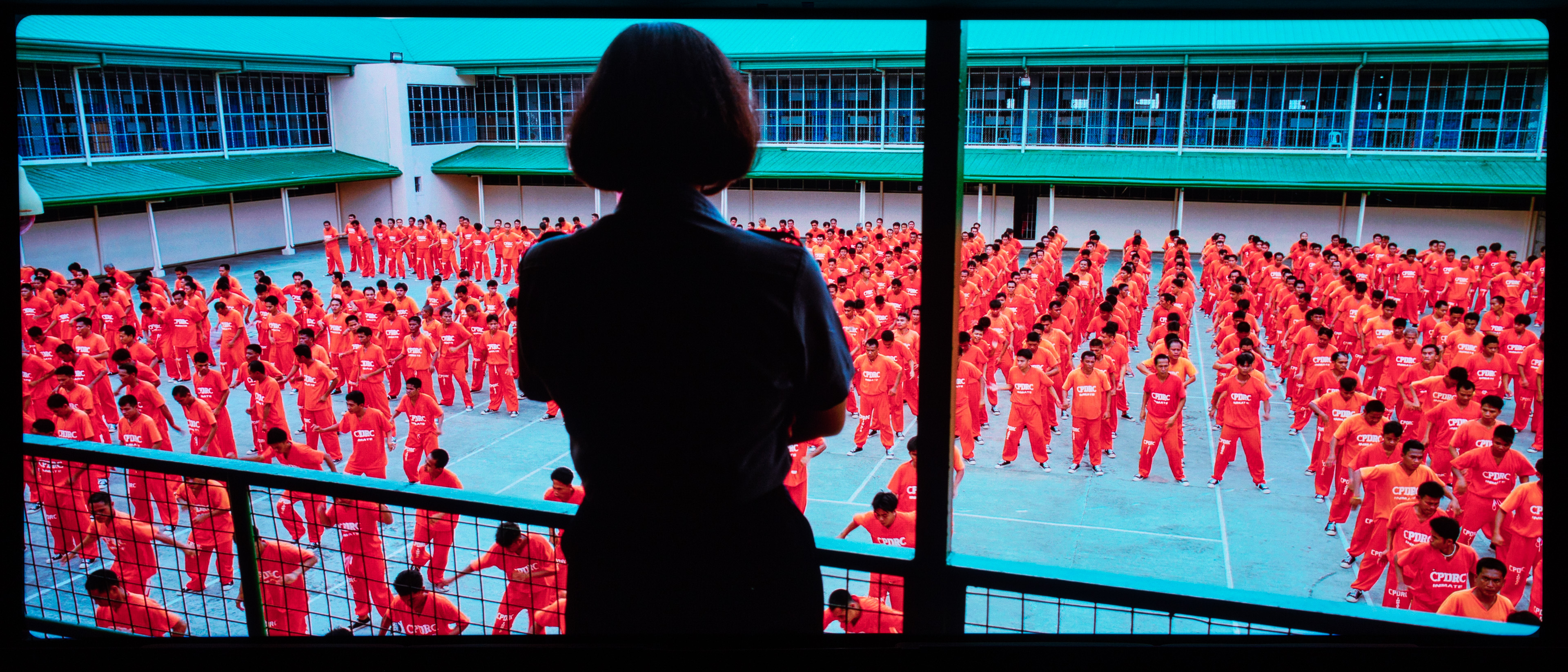

        The difference in color temperature really makes a difference, very visible. Good post.
          Hi Wolfgang - Great to be able to follow your successes again.  My Thor is supposed to ship on 03/03/2017.  My new screen ships on 02/28/2017.  I have started a thread on Avsforum about my build out.  It is titled The Mouse House Theater.
            Hi Nick nice you join here!
            Yes Cinetom its a visible difference even if the first picture include some more adjustments about HDR Gama curve and so on.
            Because of this I post this new 2 pictures as they show ONLY the difference between the 2 white points from both DCI P3 Specifications.
            Also here in this forum the pictures are much better.
            The preview is much bigger for many that just need a small look its may be fine to watch only the
            preview and when you go to + you can see the pictures in for sample 4k resolution
            with no further compressing!

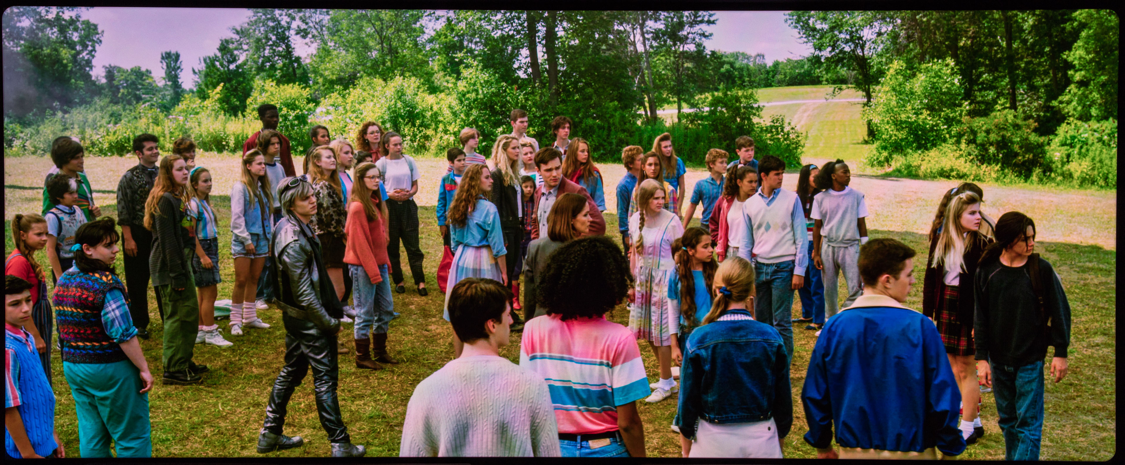

                    We watch yesterday the movie "Miss Peregrine's Home for Peculiar Children" first in the 3D BD version and later i have check the UHD Disc quality.
                    First this is a very rare movie in UHD that use the 1.85 Format as most other are using the 2.35 Format.
                    The picture quality from the 3D BD version was outstanding but also the UHD 2D 4K HDR Rec. 2020 version looks very good.
                    Some of the early parts of the movie was perfect to show the top Ansi cr. the Barco Laser Pr. have.
                    It was one more time a good example what a good 3D BD and a good UHD Disc can show at home and this Discs was a perfect tool to show how important a good Ansi Cr. is.

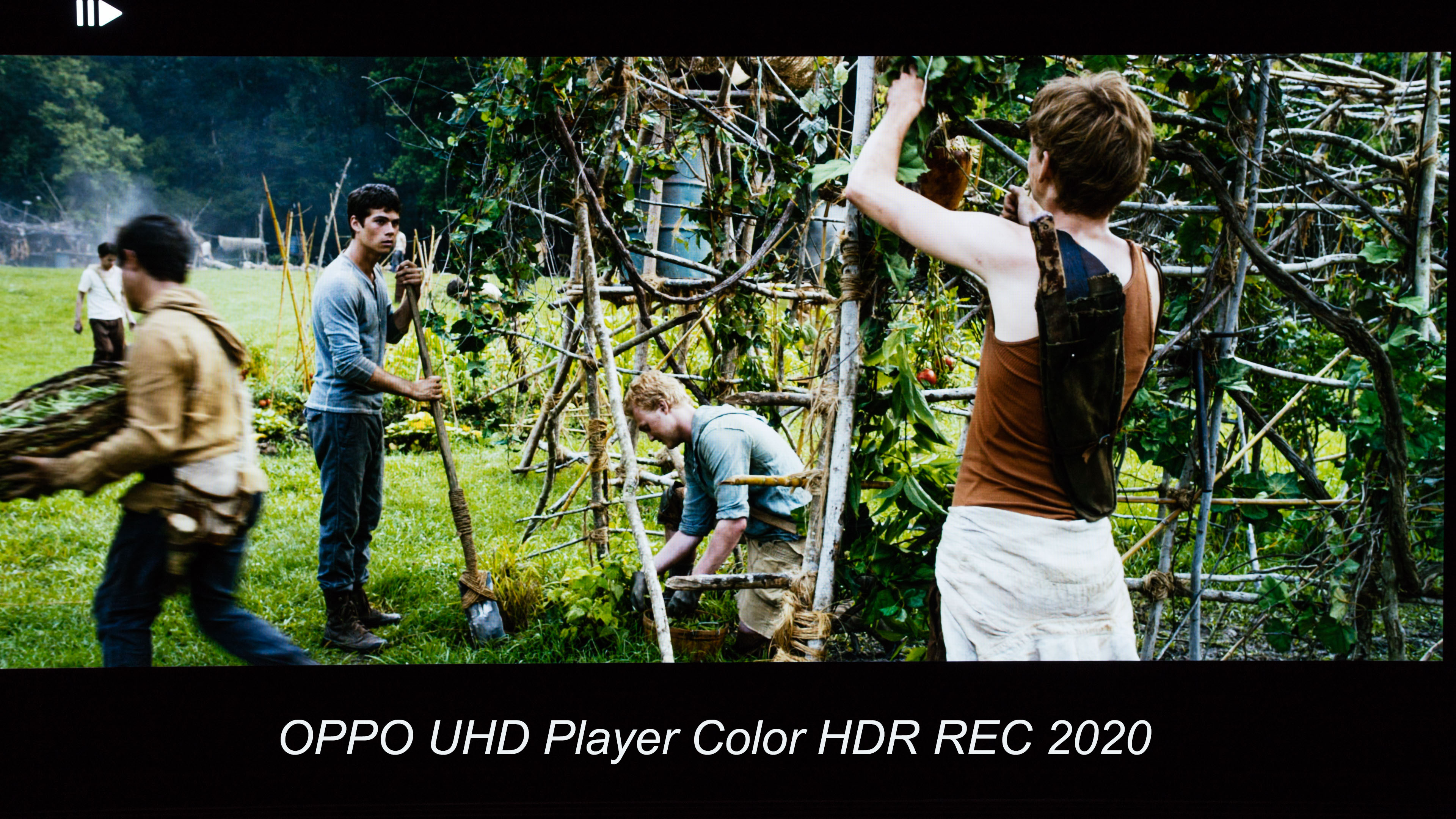

                              Some months ago I got the OPPO UHD Disc Player but as this was full of different bugs I return it.
                              Now I got it back as the dealer promise me that most of the bugs I complain ( for sample 24.00P output and not the right 23.976P) are solved.
                              So it test UHD BD in 2D and 3D and yes I can confirm the running now at the right frame rate with no micro stutter at all.

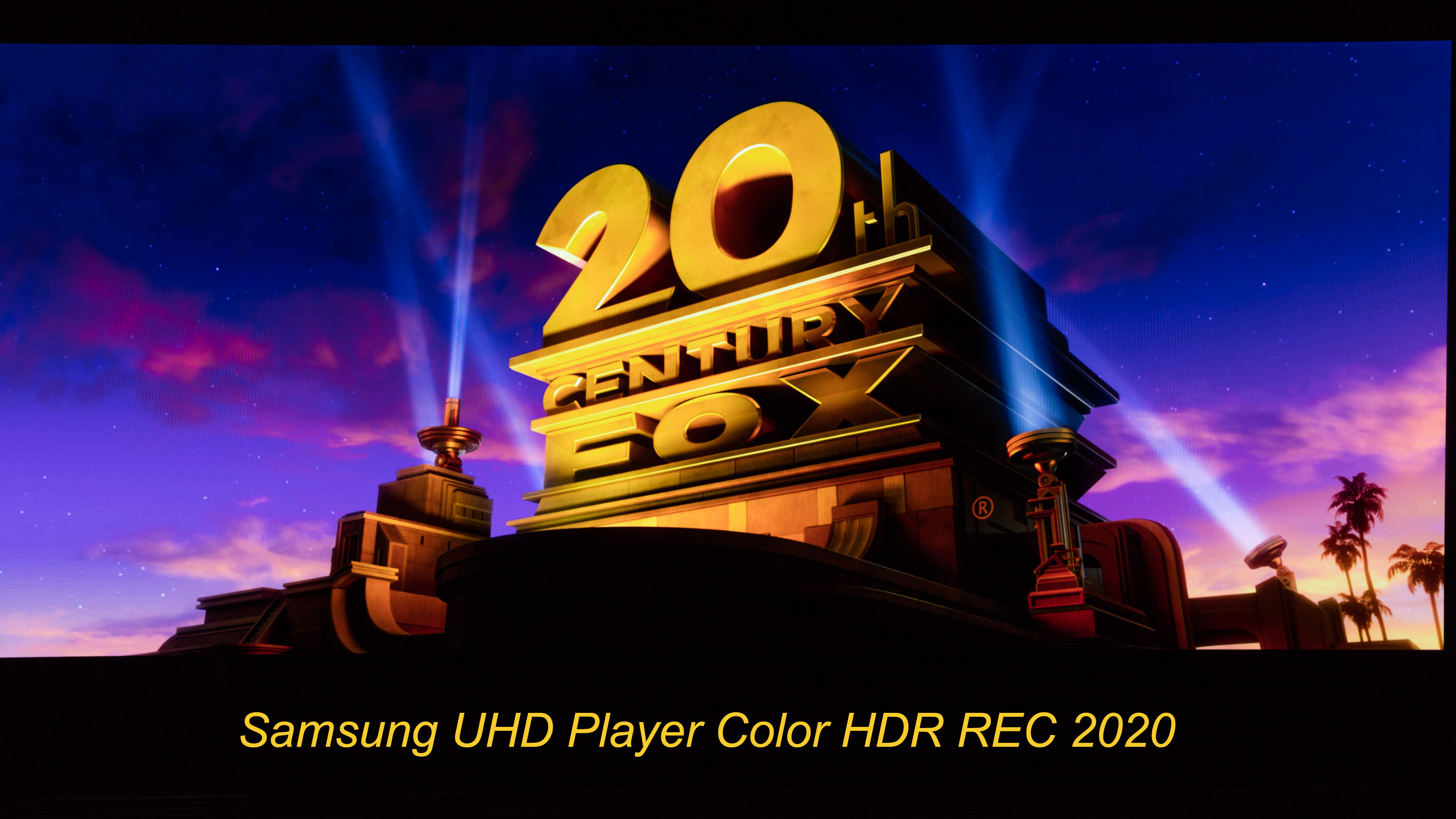

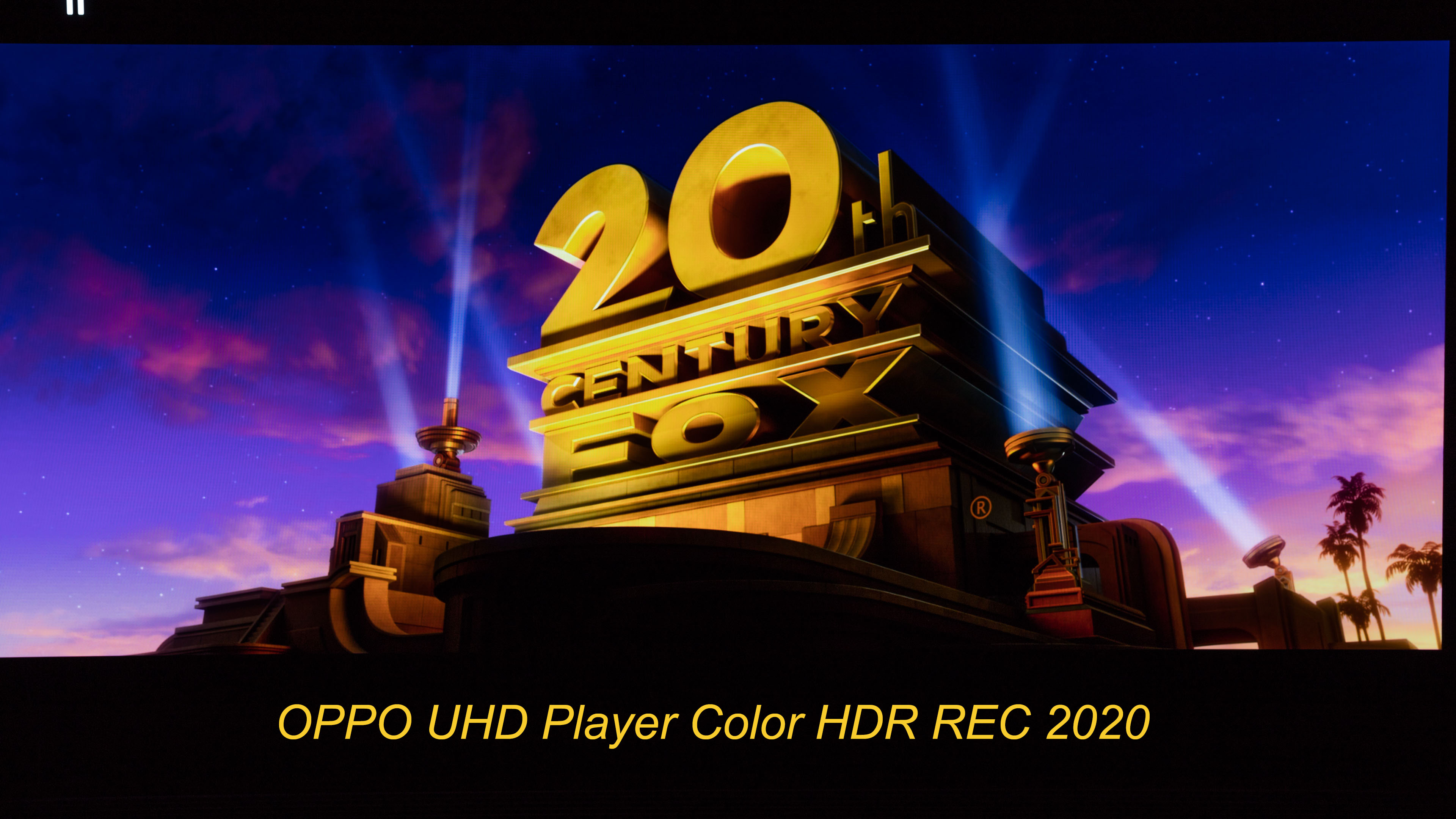

                              What was funny to see is how different the OPPO UHD Player output colors compare to the Samsung.
                              Please see here 2 sample picture where you can compare easy how much different color both Player show.
                              The Samsung have too much Red that was complained since some time compare to the very natural
                              looking colors from the new OPPO UHD Player.
                              Best you can see it in the 20th Century Fox Logo but if you watch close you can see it in the other Picture as well.
                              I cannot understand how people with a high end Projector can report that they are fine with the Samsung UHD Player!
                              At one side they talking about Projector calibration like crazy for 1 % more or better color accuracy and on the other side they use a UHD Player that have a far bigger color bug  a Projector can have  and they accept it and run such a UHD Player in there High End system !
                              I will never understand things like this.
                              May some of this people should take a close look about my pictures to realize the difference.
                              Before anybody will ask YES I have the latest Software in the Samsung.
                              Pictures was taken with the Canon 5DSR a Zeiss Otus 28mm Lens and the
                              LG 4K 77" OLED and therefore pictures have some kind of interferences visible.
