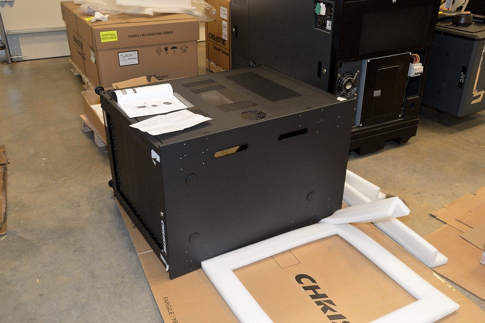

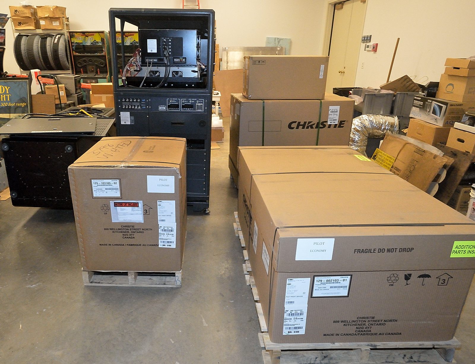

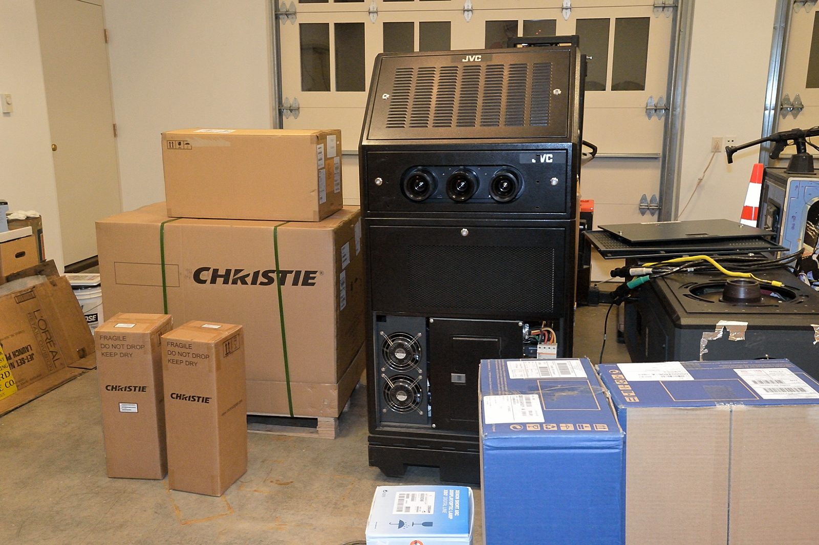

Then, the delivery truck arrived:

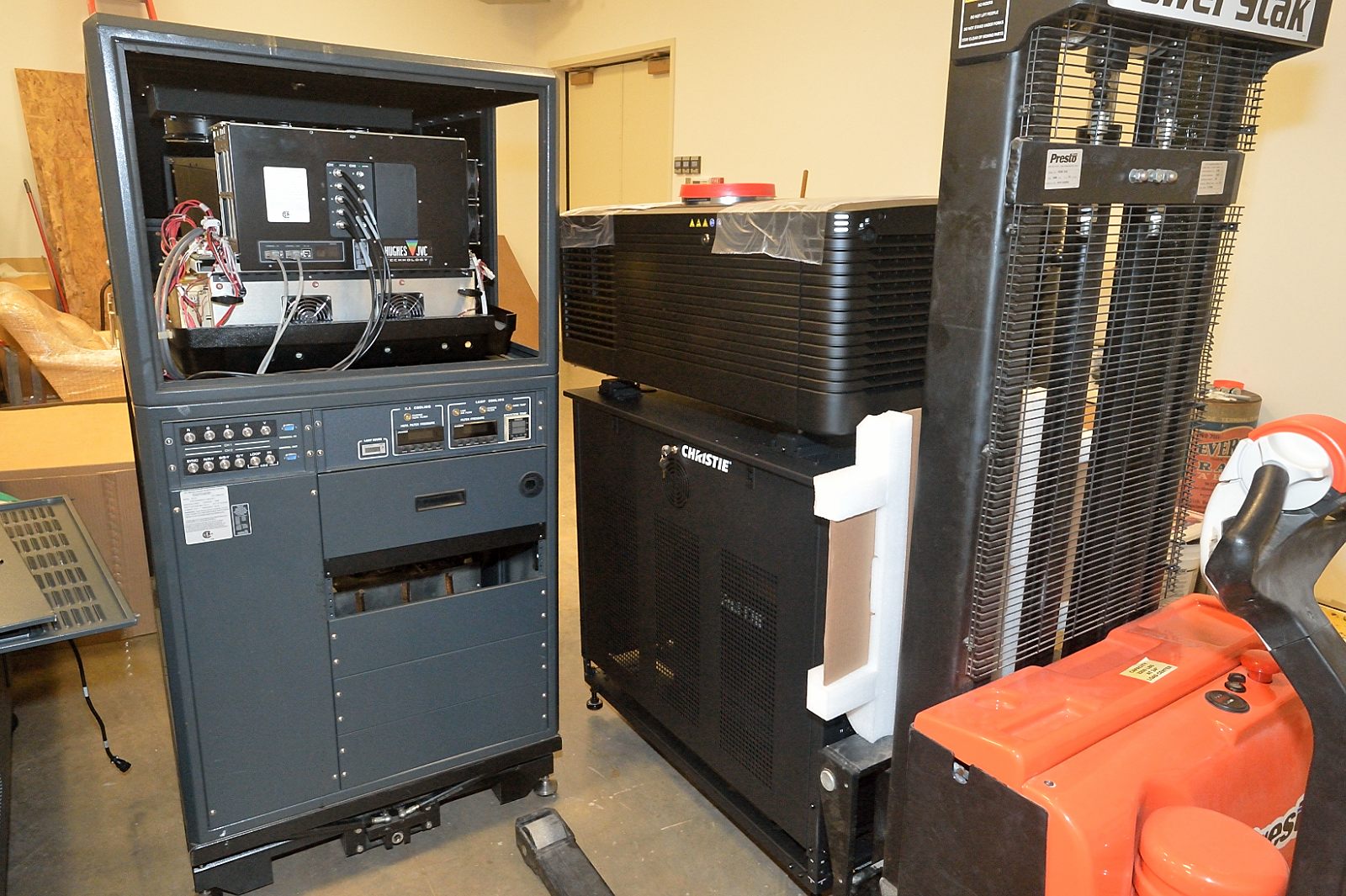

The black objects next to the Christie Boxes are what is left of the Hughes-JVC after it was picked over for parts...
More to follow, but I've got boxes to open!!!

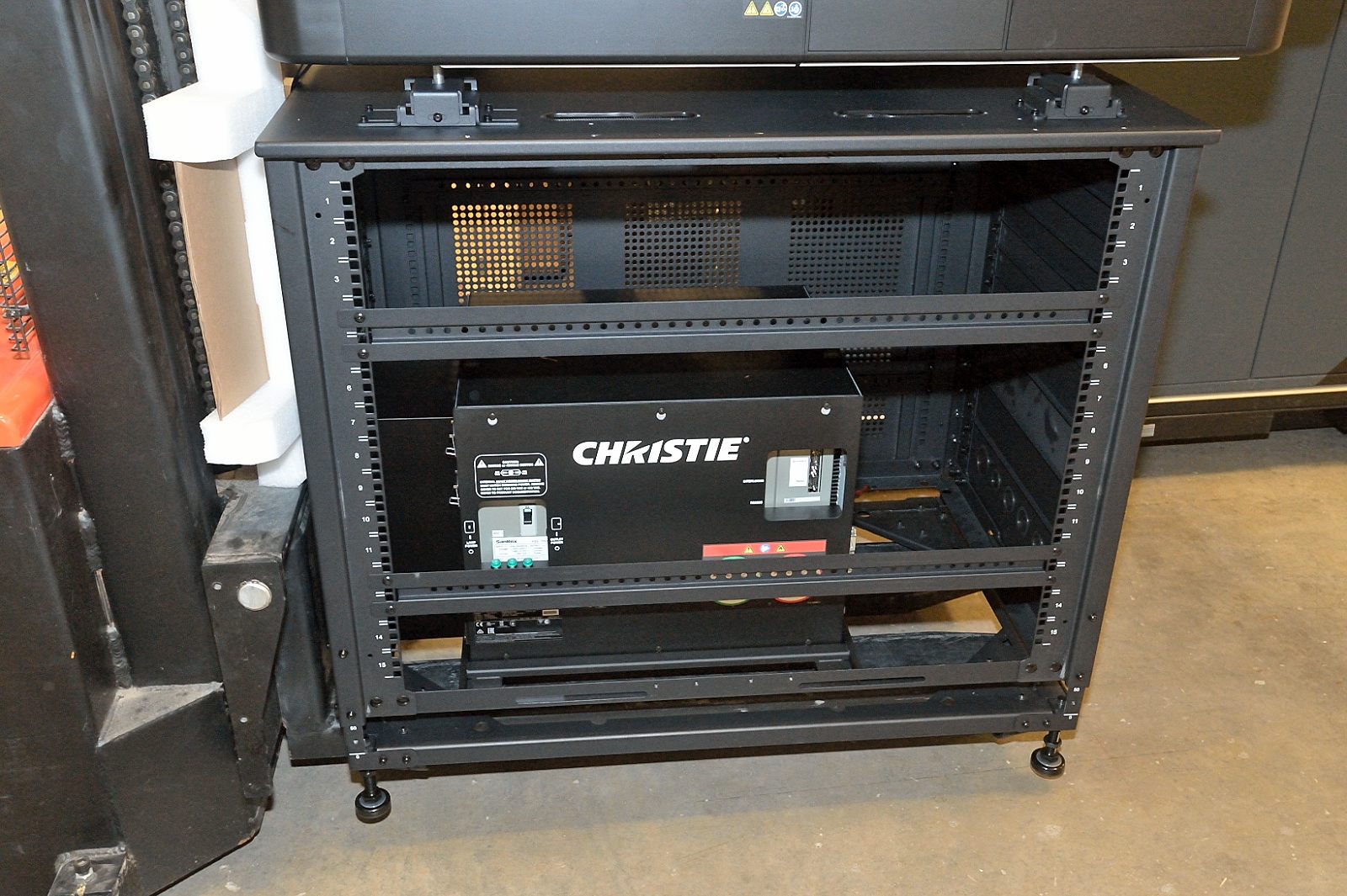

Congrats. I love Christie you will be very happy with the CP-4230. They were smart, their pedestals include both leveling feet and casters.<\q>
Even the 1998 Hughes-JVC (this projector replaced) had that setup. They took things one step better by also engineering slots to allow a pallet jack or forklift to be able to slip underneath for moving.

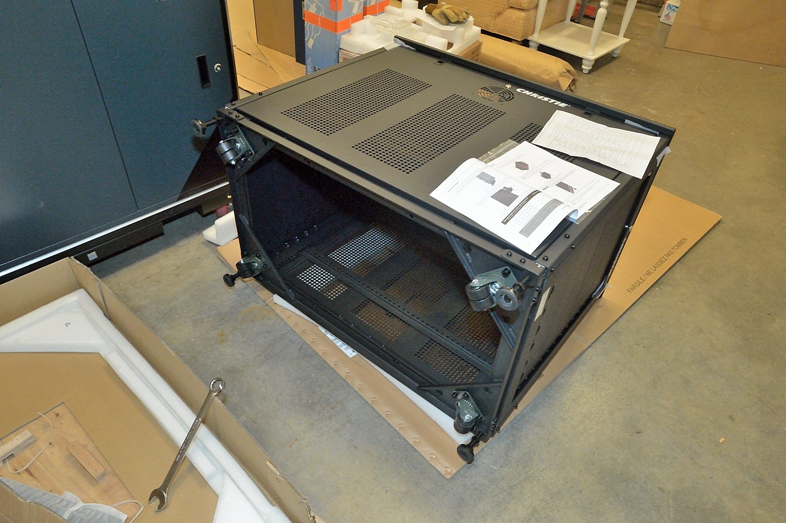

The only thing I am not happy about so far is that the documentation for the stand was not updated to include any references to the 4230. They have a list of projectors for one locking foot layout, and another list of projectors for an alternate layout. Without the 4230 listed, which one do you go with? I just went with the same layout as the 2230. With regard to setting the stand height, they make a special mention to adjust the height for the 2230, but the optics are not the same on the 4230, so what do you do? Also, I know it seems stupid, but the documentation has no pictorial guide as to which way the foot locks are supposed to be oriented, or even which end of the stand is the "front"!
Obviously, given enough care and time I can (and did) figure it out, but why do they make things harder than they should be...
Another day, another struggle dealing with the horrendous instruction manuals. A lot of trial and error...fortunately only one re-do...
Today I proceeded to un-crate and place the 7kw lamp power supply into the projector stand.

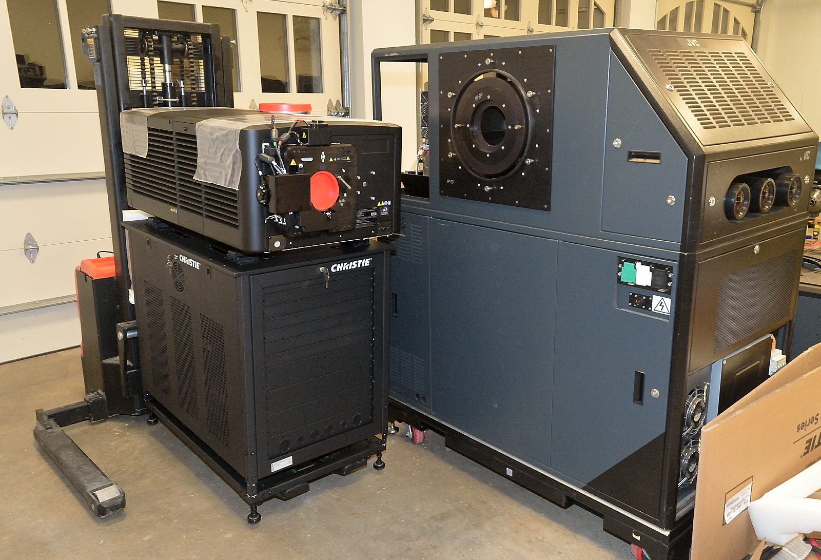

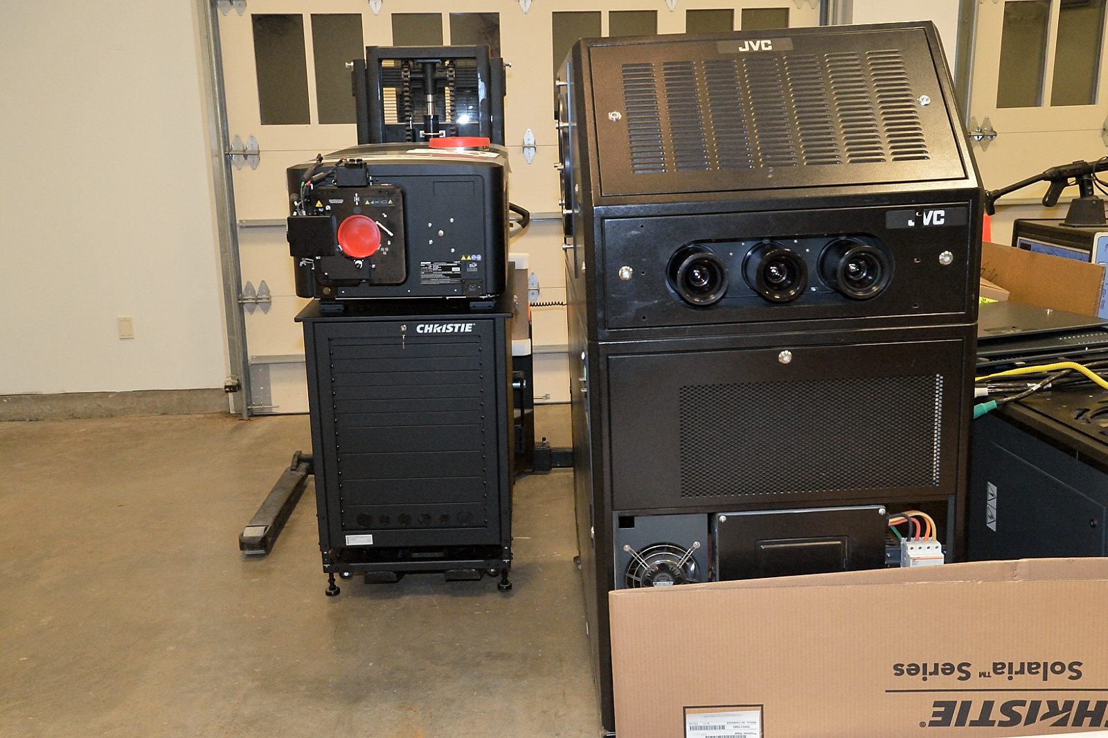

The rest of the night was spent un-crating and very carefully unbolting and then lifting the projector off of the shipping pallet, and then onto the stand. Thank goodness for power stackers!
It's interesting to note the size difference between the 1998 Hughes-JVC unit and the new one.

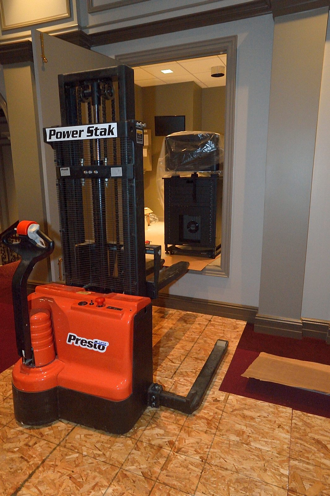

I agree about having a lift of some sort. Not worth the risk hurting our backs or hiring and paying 5 guys who bang this stuff around. I finally broke down and bought a manual hand crank type but after seeing your "Presto" ( top of the line ) I just ordered a "Vestil" SL-118-AA, thanks for the mention it gave me the push to get the real thing.

I just ordered a "Vestil" SL-118-AA,<\q>
The only problem with "straddle" type stackers like these is that you can't get right up to a location unless there is clear space underneath. I built my booth with a removable wall section to allow for projector replacements, so the challenge is getting the projector into the booth when only a little bit of the forks extend past the straddles.

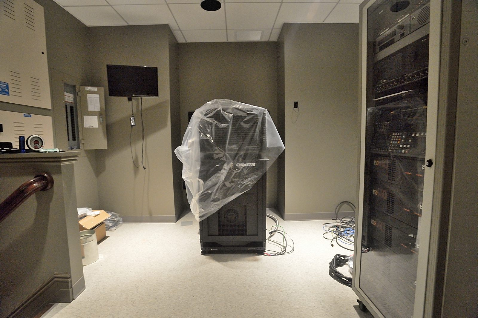

Despite my son not showing up this evening to help me move the projector to the booth, I was able to successfully complete the job anyway.
By carefully placing cardboard between the forks and the stand base, I was able to slide the projector off the forks inch by inch.

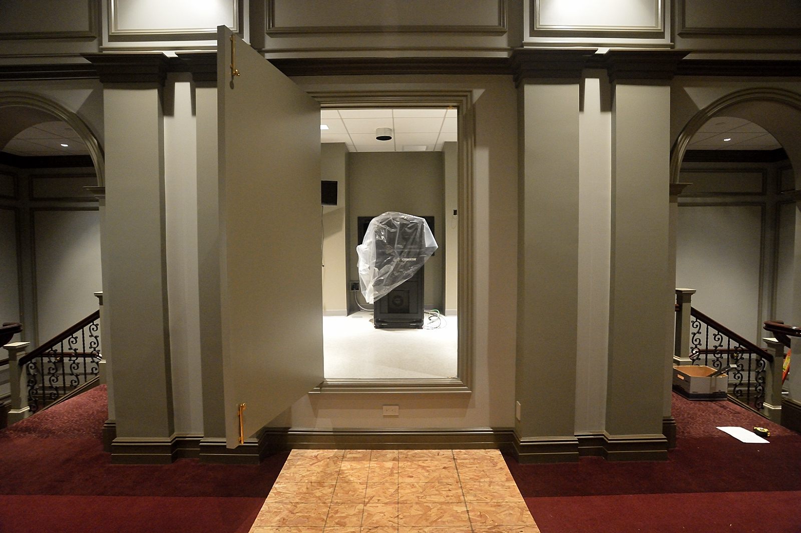

In place finally. (Note the wall that opens up just for this purpose).
Ready to begin UPS, NAS, and power wiring installation.
The booth wall is buttoned up again.
