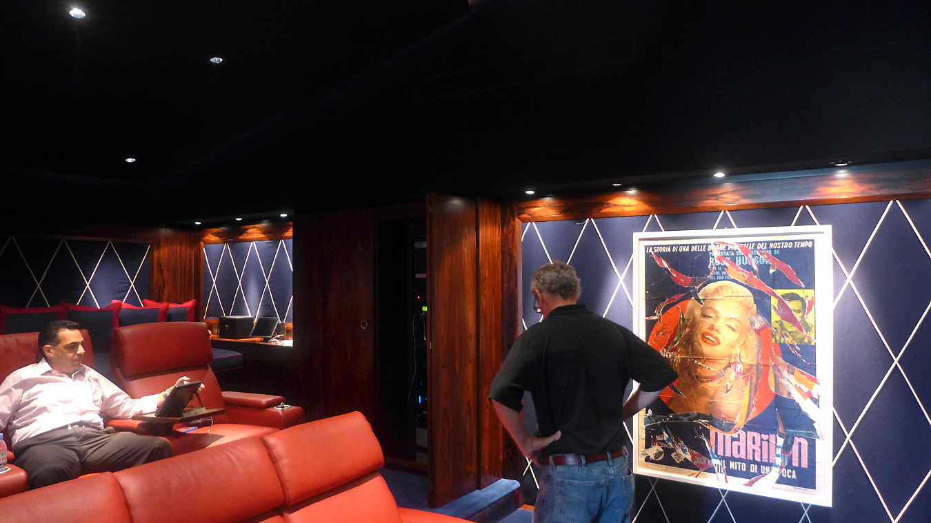

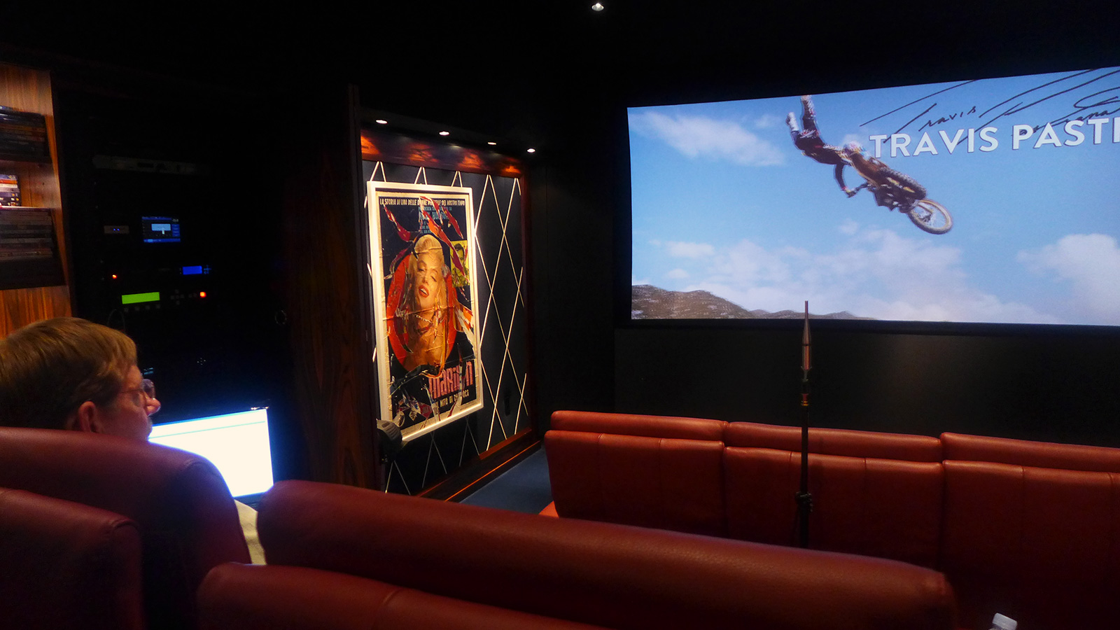

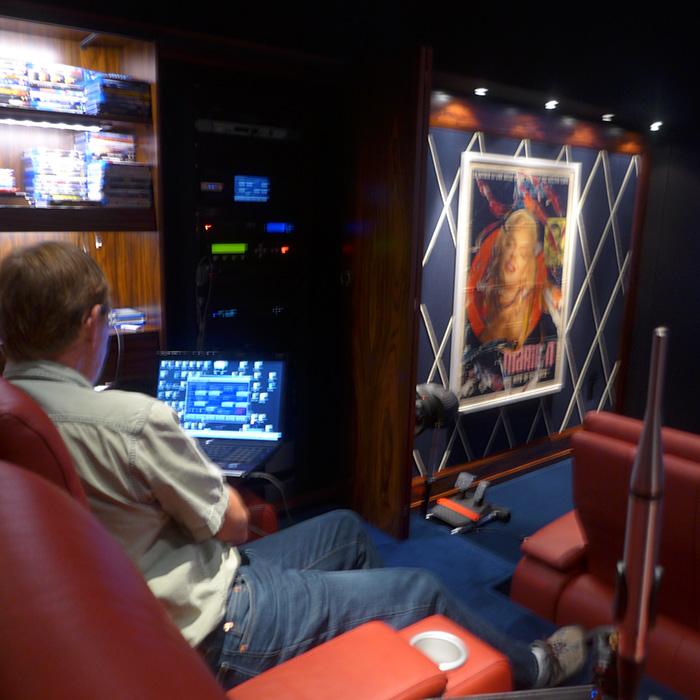

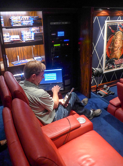

            Tomorrow we will be visiting to upgrade firmware and time align and show Mike Smith of Datasat for immersive audio future upgrade planning.

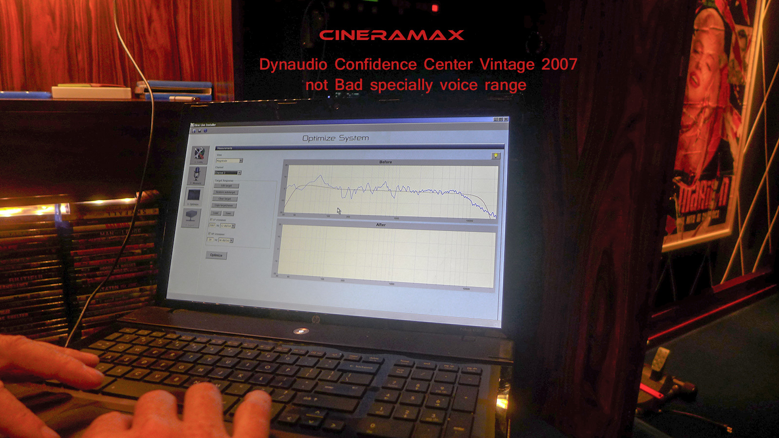

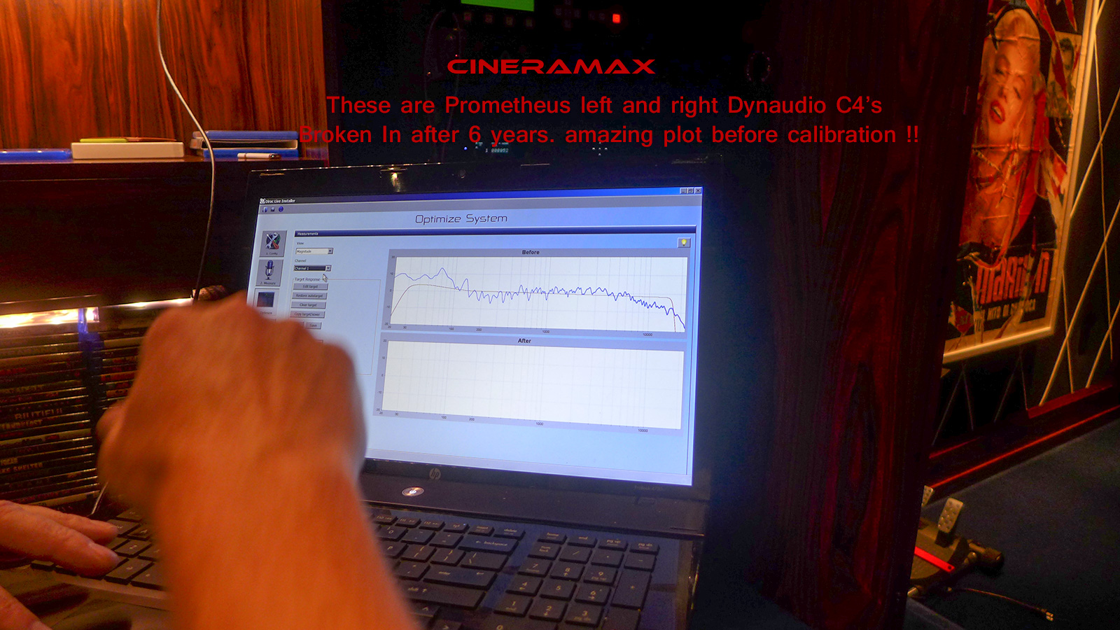

              The bass always have been sloppy and laconic, but he pressure in the room sinks the middle of the room like in a time delay fashion, if you notice the target base line was hitting 200 and then he slid it back to like the 155-160 region, this fixed what all along even the top acousticians thought was a condition of the 90 year old wooden mansion.  Well Mike tighten that bass and time aligned it dead on where it sounds like a top room.

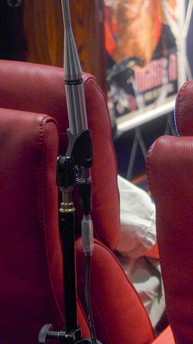

              Also tightly packing the mics around one seat made a huge difference not only in that seat but the general mlp area, when those of you upgrade to dirac 2 I recommend setting a memory for just one seat.
              More Detail to come with actual plots that surprised me how nice the room design works with the speakers.
              At that time I was focusing on DCI Projection but apparently I had the skils to do great acoustics and select/site  great speakers to where:
              You Will see the plots...
                see pics
                  What this guy did to eliminate a problem we thought was a non fixable thing blew me away.
                    Those curves not only attest to the flexibility with which dynaudio confidence series sounds good no matter where placed, but as to how well they age, 7.5 years of breaking in , like wine they got better, those plots from the MLP don't lie.
