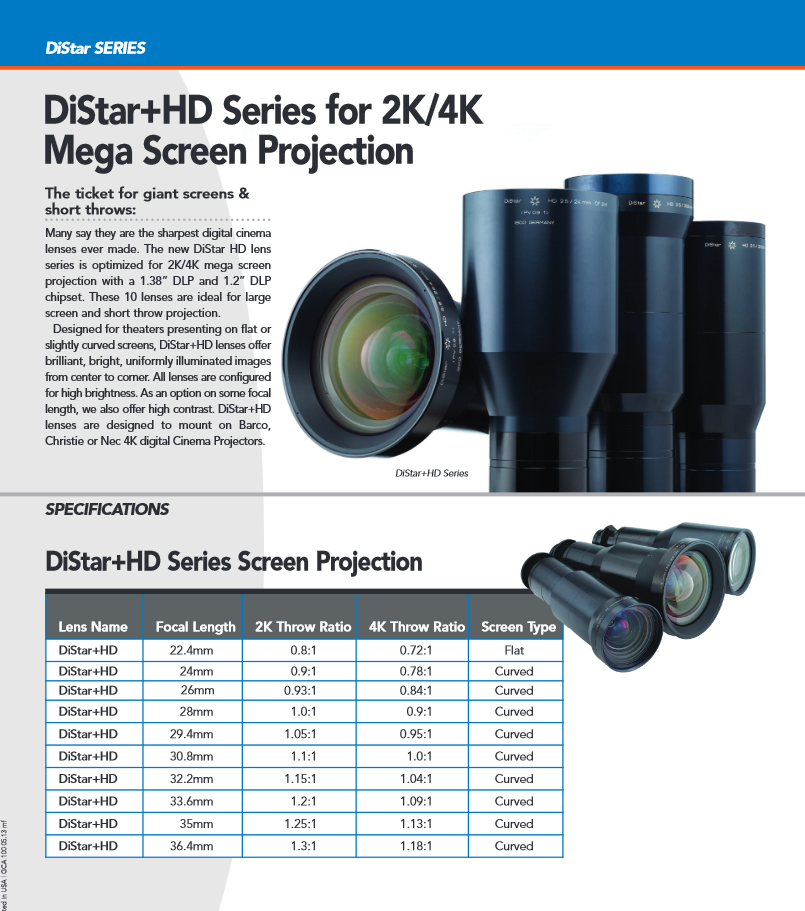

    Here is one starting point for short throw lenses. These lenses list for 30, the zoom variant from Hyperion will list for 40.
    Barco makes a decent 1 to 1 4k lens from the non dci side, am sure Christie has the same.
    NEC leads the charge for maximum unsharpness, they should heed this advice.
    Imagine you engineer a large format install and then the screen does not focus, details like this are all important yet no one seems to care.

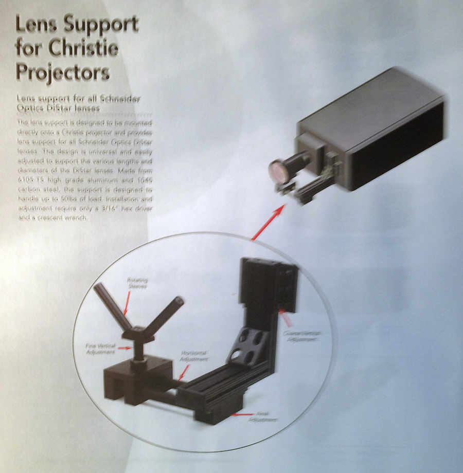

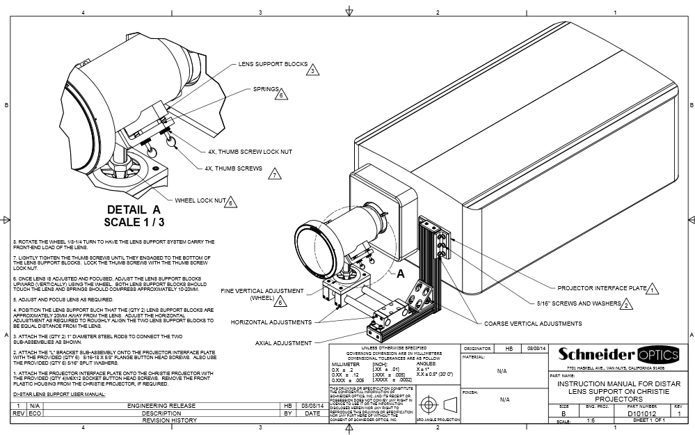

    Also these lenses are heavy and will vibrate thus reducing resolution. As I predicted before a new range of lens stabilizers are needed.

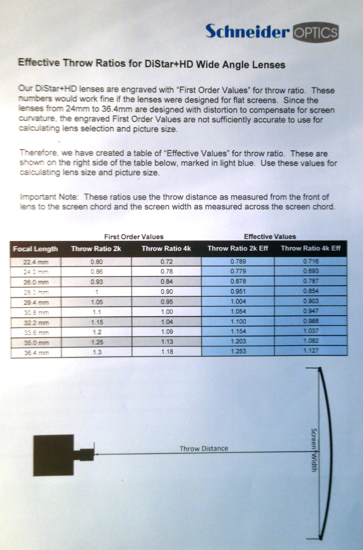

      Not to leave Schneider with an egg free face, I am mad as hell that they don't have solutions past the 1.18 td (first order) in 4k, the majority of home cinema wall to wall installs will require from 1.2 to 1.35.
        Nice to see a high end lens on the market, Ive never had the pleasure to compare one to a cinema 2k lens. As you said they are going to have to expand the offerings well beyond 1.18.
          Hi Pixels, for a flat screen the case is even worse because the effective rate isĀ  1.127.
