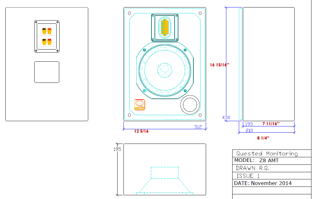

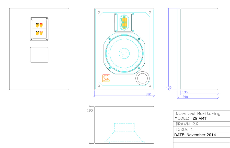

    Attached is drawing of new cabinet, the Z8.
    Bass driver is an 8” version of the 10” fitted in the LT10 and LT20.
    HF driver is an AMT.
    We will be making the same size cabinet but with a dual-concentric soft-dome HF unit.
    One or the other would be good for the Aegir ceiling and either side of the projector. You don’t have to decide now as the cabinets are the same size. I will make more tests when the first batch arrive, we only have one prototype at the moment, I suspect that the AMT version will be more suitable.
    If you would like the connector panel in a different position, no problem. You could also have Neutrik connectors if you prefer.
    This is the little speaker that could, maybe usable for all channels in a multichannel system including LCR.
    The coax version has 90 degree dispersion perfect for ceilings and utilizes the high power tweeter from the studio monitor line.
      expect the US List Price to be $3,510 each.  (It is an actively-driven product so will require processing and 2 amplifier channels).

            What looks like a great alternative to the LT-20 the Z-16, The high power alternative to the LT-8 the Z8, ZEILING The low ceilings timbre matched hemispherical dispersion coaxial speaker using Quested Studio Monitor tweeter,the Zub (the sound defies it's size (looks like a sealed design-no ports?).
            The AMT is smaller than the one in the LT10 and LT20, more suited to smaller rooms.

            Dimensions in Inches:
            Z8                          PROJECTED PRICE AS PER ABOVE $3,510
              7"11/16" DEEP
            12" 5/16" WIDE
            16"15/16" TALL
            ZUB                DOWN TO 16HZ UN -EQ'D
            15"3/4" DEEP
            19"1/8" WIDE
            29"1/8" TALL

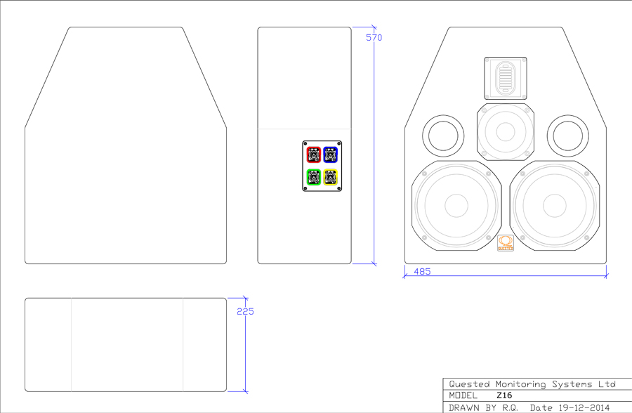

            Z16
            8"7/8"    DEEP
            19'1/8"  WIDE
            22"7/16" TALL

                              Then we have 3 Z16 (Quested will get their first units next Tuesday so no measurements yet) Each one will eat up an entire AP300-4 , 2 x 300 channels for the mid and high each, the other 2 channels get bridged to 950 for the the dual woofers.
                              so there will be 3 AP-300-4 just for the lcr at ISE Trinnov Demo
                              Rather than spl I believe the advantage of the z16 over the z8 will be smoother musicality plus 2-3 db of headroom, if you plan on playing music using Auromatic through the 16-24 channels I think best to spring to the z16 (my opinion based on LT-20/LT-10).
