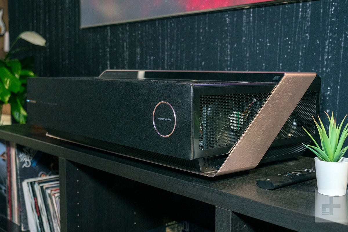

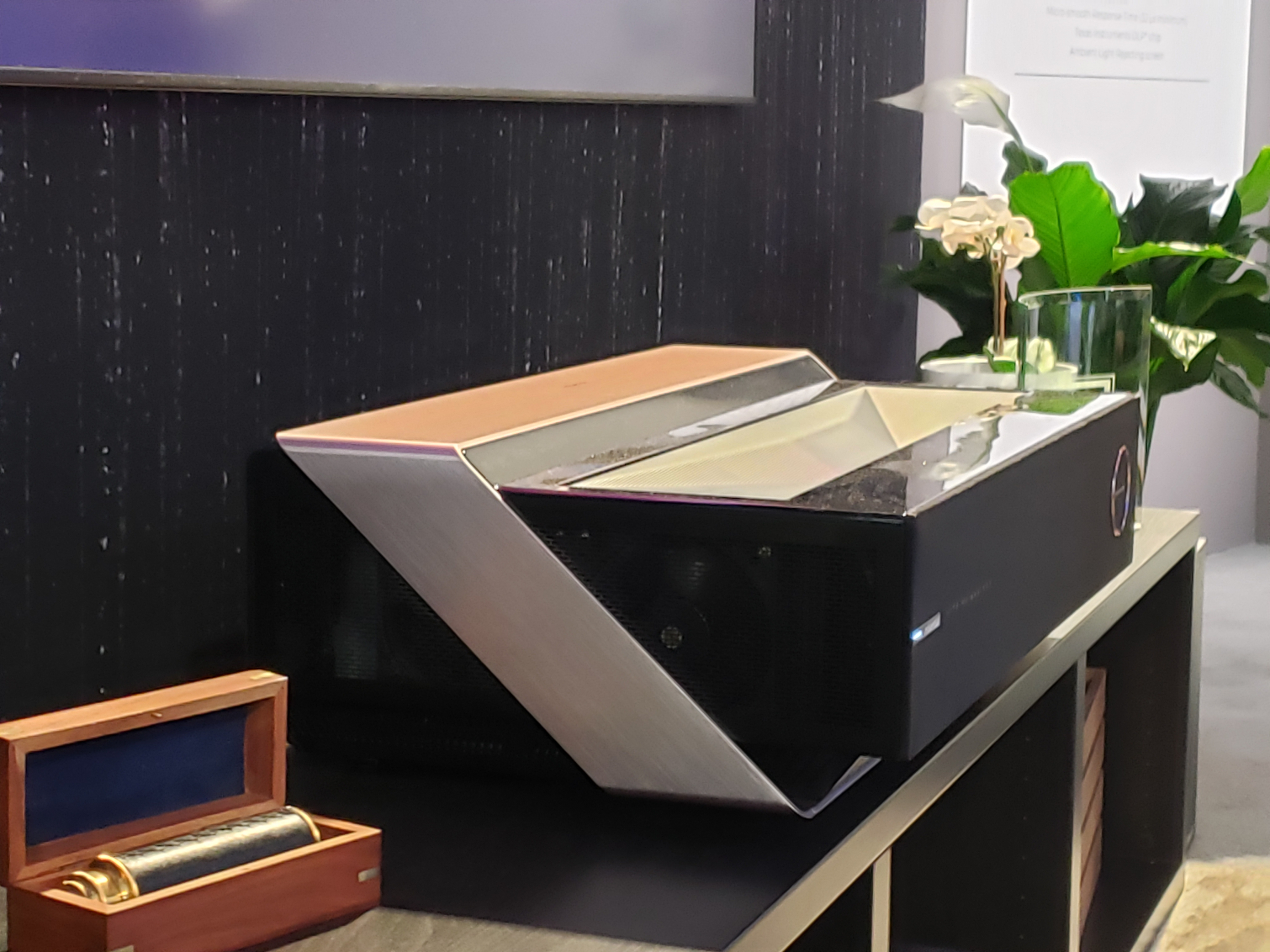

    They say 3,200 lumens Ultra short throw.
    Curious if it is really 3 rgb laser for 16K.
    Some people seemed to like it.
    From what I read it is r+b+phosphor for green, they use the brand TriChroma Laser TV and red and blue laser interchangibly. TCL uses that Chinese laser oem,i keep forgetting the name of. Coretronics demoed r+b ust at ISE two years ago, claim of P3 gamut. Standard gamut being Rec.709. Blue phosphor only is less than 709. Roughky brightness blue only 6K, R+B 5K, Filtered to P3 4K. All manufacturer number, so real world less. So which of theCoretronic customer bought into this? Dell was first, but blue only.
    Can't find the US release having its executive talking about R+B, but the general release does speak of three indepent lasers. Of course this can still be blue, red, blue+phosphor.Most likely given Green laser issues/cost. This is not a Christie CP4325.
    The Hisense booth proudly displays the 4K Smart TriChroma™ Laser TV (100L7T), the latest addition to the award-winning series that uses the foundational elements of color - red, blue and green. The outcome is a near-infinite array of colors, including Pure White. The TriChroma Laser TV has an X-Fusion Laser Light Engine™ that combines three independent lasers to accurately display a wide array of colors and hues, reaching 96.6% of the rec.2020 color space. A TI DLP® chip enables blazing fast motion speeds with a 32 micro-second refresh rate for 8.3 million pixels, creating an unrivaled viewing experience that must be seen to believe.<\q>
