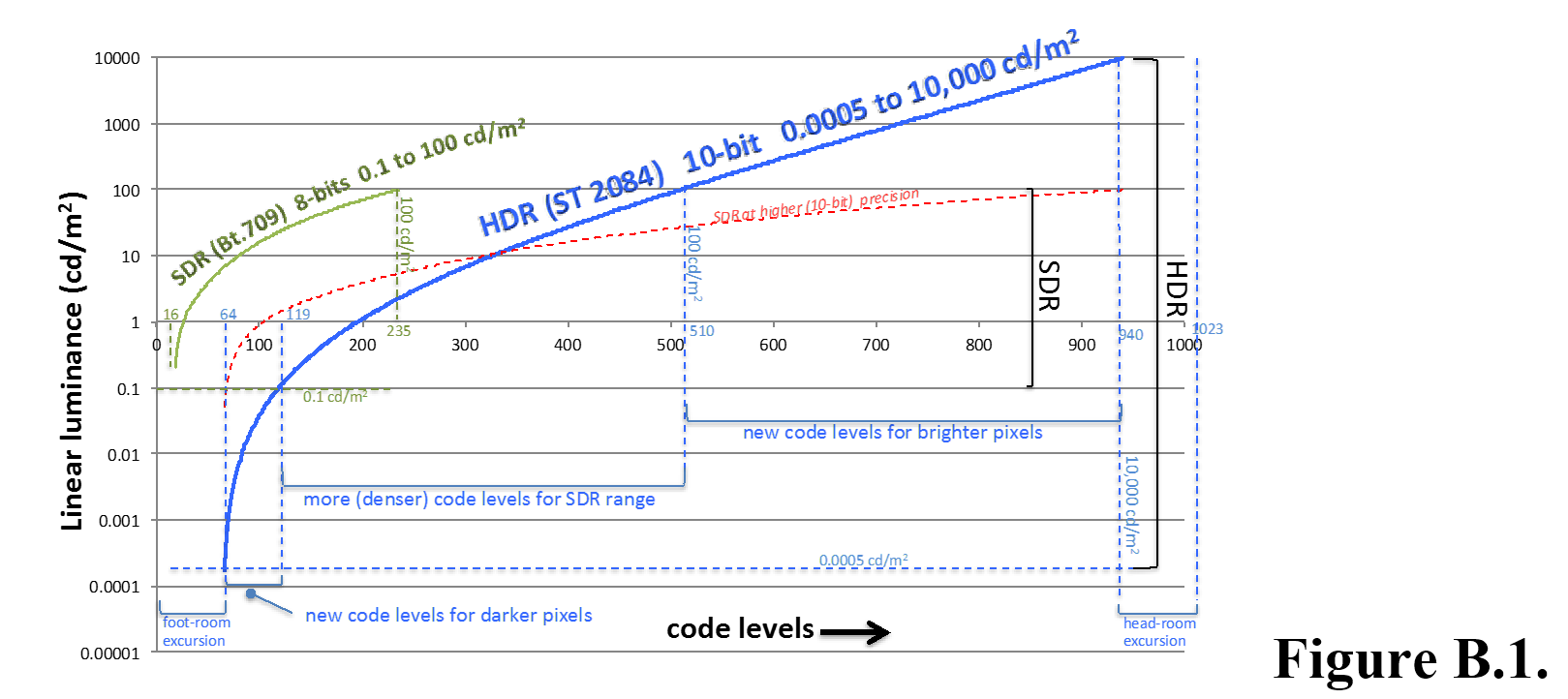

      Examples of the Transfer Functions
      Traditionally, a transfer function is described as a mapping between input and output in the real-valued (floating point) range [0.0, 1.0]. As an illustrative example, Figure B.1 compares an 8-bit SDR system capable of representing 0.1 to 100 cd/m2 with a BT.709 style transfer function (green curve) to a 10-bit HDR system capable of representing 0.005 to 10,000 cd/m2 with another transfer function (SMPTE ST 2084). The plots in this figure are approximate plots. They do not capture the exact form of the curve and are shown for illustration purposes only. In the figure, the integer code levels are along the horizontal axis and linear light values (scaled to log10) are along the vertical axis. This illustrative mapping includes traditional code level range proportions to accommodate both foot-room (“negative” samples below the [0.0, 1.0] real-valued range) and head-room (samples above real-value 1.0).  Due to design properties, the 10-bit HDR transfer function shown here assigns approximately twice as many code levels [119 to 509] as the traditional 8-bit SDR transfer function assigns [16 to 235] in the SDR range, while providing a similar number of new code levels [510 to 940] to extend brightness.  New code levels [64 to 118] are assigned for darker intensities below 0.01 cd/m2.
      In a sense, the 10-bit HDR system illustrated here distributes the extra 2-bits over traditional consumer 8-bit “SDR” video by assigning approximately 1 extra bit of precision within the traditional SDR intensity range, while applying the other extra bit to extend the curve to intensities greater than 100 cd/m2. For comparison, the 10-bit SDR transfer function is also plotted (red dash curve).
      Figure B.1. Mapping of linear light values for SDR and HDR representations
