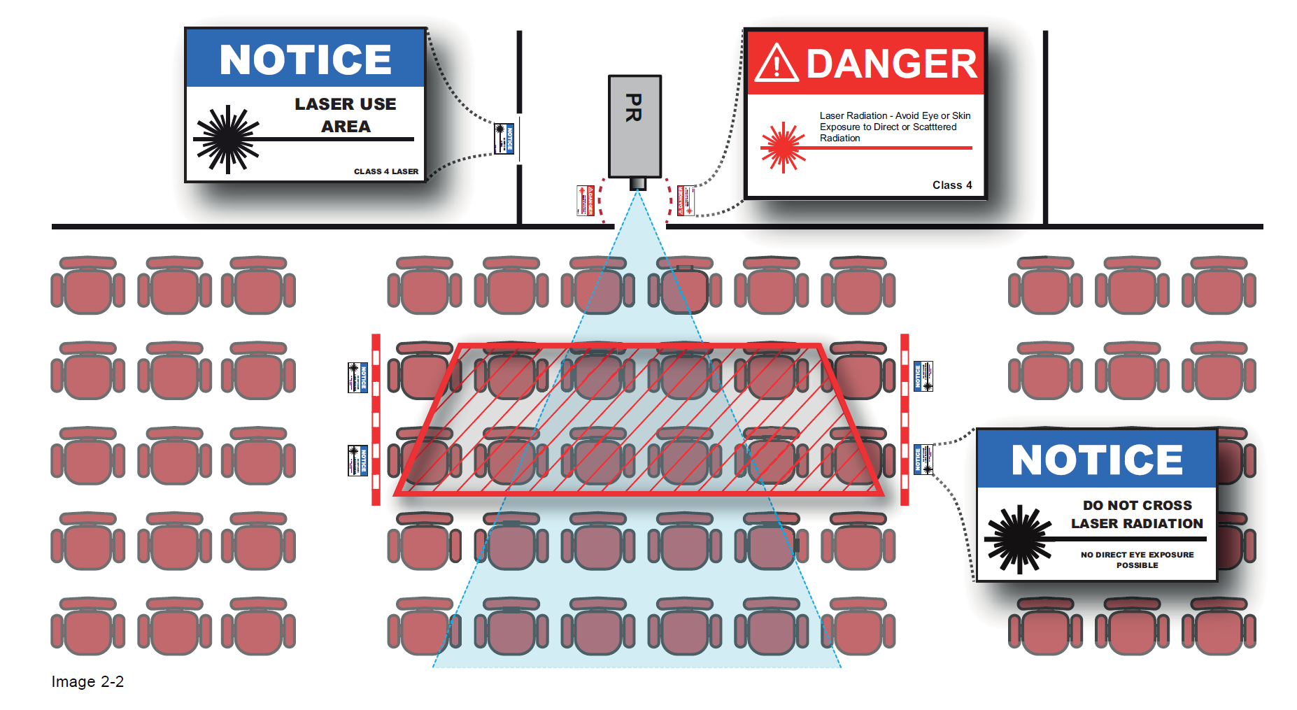

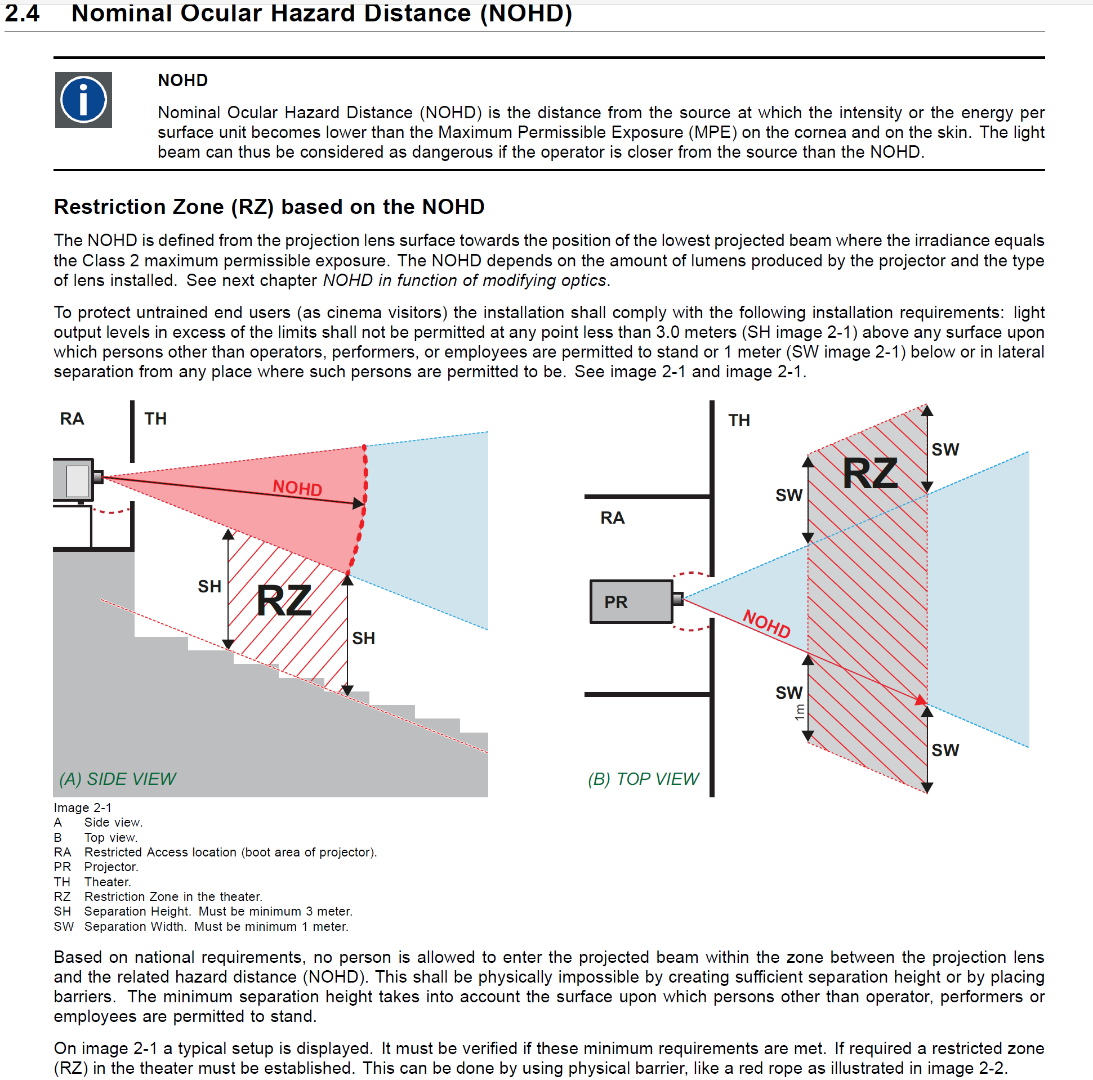

At Infocomm, Barco was taking the ruling seriously. In their laser-phosphor retrofit demo, they placed the projector on a tower and made sure the beam was 8’4” (2.54M) above the floor so that no one could inadvertently look into the beam. Panasonic is marking its laser-phosphor projectors as class 3R laser products. And on the show floor, there were many other laser phosphor demos, but in almost all cases, the projectors were mounted high enough to comply with the ruling.

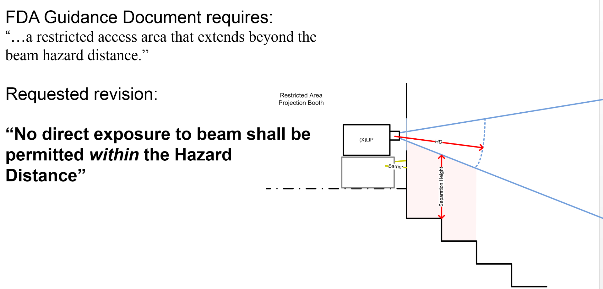

While these efforts were well received and accepted in Japan and Europe, US regulators, namely the FDA, didn’t quite see it that way. In its ruling earlier in the year, it did not use the language that other agencies and LIPA provided and it referenced out of date EU regulations (the new one was approved but not issued). As a result, RGB and Laser Phosphor projectors are still considered laser devices and must obtain a variance for use in commercial application. That may be fine for a theater where an RGB laser will reside, but that also means a laser phosphor projector in a meeting room, symposium, or digital signage venue needs a variance from the FDA. That means limited access areas at a minimum.

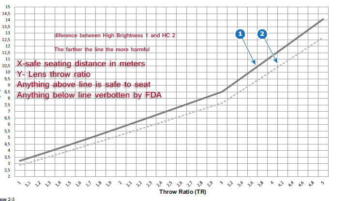

The result is shown in the figure below. Under the IEC guideline, projectors with an output of 8,000 lumens and above are considered Risk Group 3, while the FDA guidelines set that limit at 3,000 lumens. That’s the difference between a specialized segment and the mainstream market.
