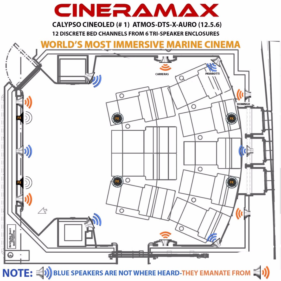

I am trying to utilize the existing 7.1 cabinet cutout infrastructure intact yet accomodate a full blown full immersion system with many a channel and for it to be a trully format agnostic cinema handling the 3 codecs plus ome crucial steered width channels a la meridian 561/861.
So speakerwise it's likely a very special purpose layout as in a condo there would be freedom to deploy more inwalls and in ceilings, yet is a very interesting experiment in using dual mono speakers that create a solid phantom cneter image out of 2 enclosures, like the swiss super high end Goldmund Epilogue, the Artisons we used in soho beach house, or the custom leons we used in One Hyde Park throughtout. This time I will be using what I consider to be the finest Custom speaker makers: James. Their capacity to customize stuff is really the standard setter, plus they sound great and their quad speaker dispersion coverage should provide decent phantom images, plus they are marine as well with no corrodable elements. Not that that is an issue since the temperature in that cinema is 65 farenheit. Damned coldest cinema I have ever been in.

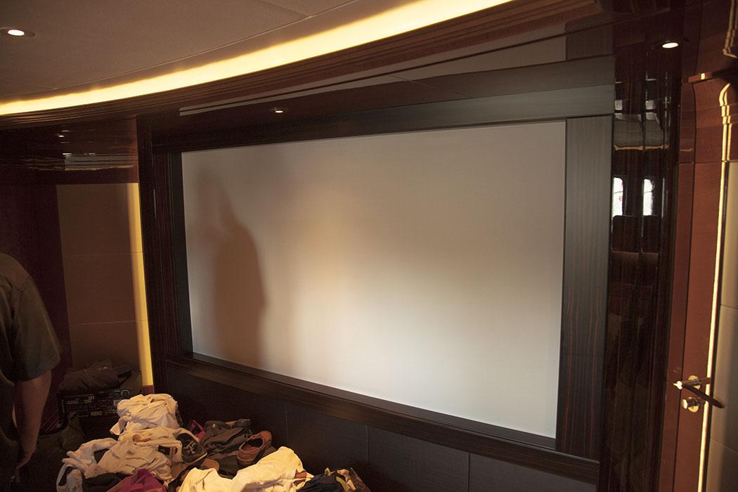

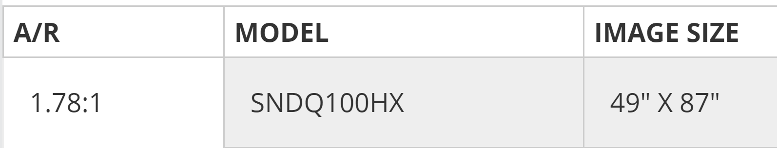

So here is the screen 100" Stewart that is in place used by a c-3x sim.

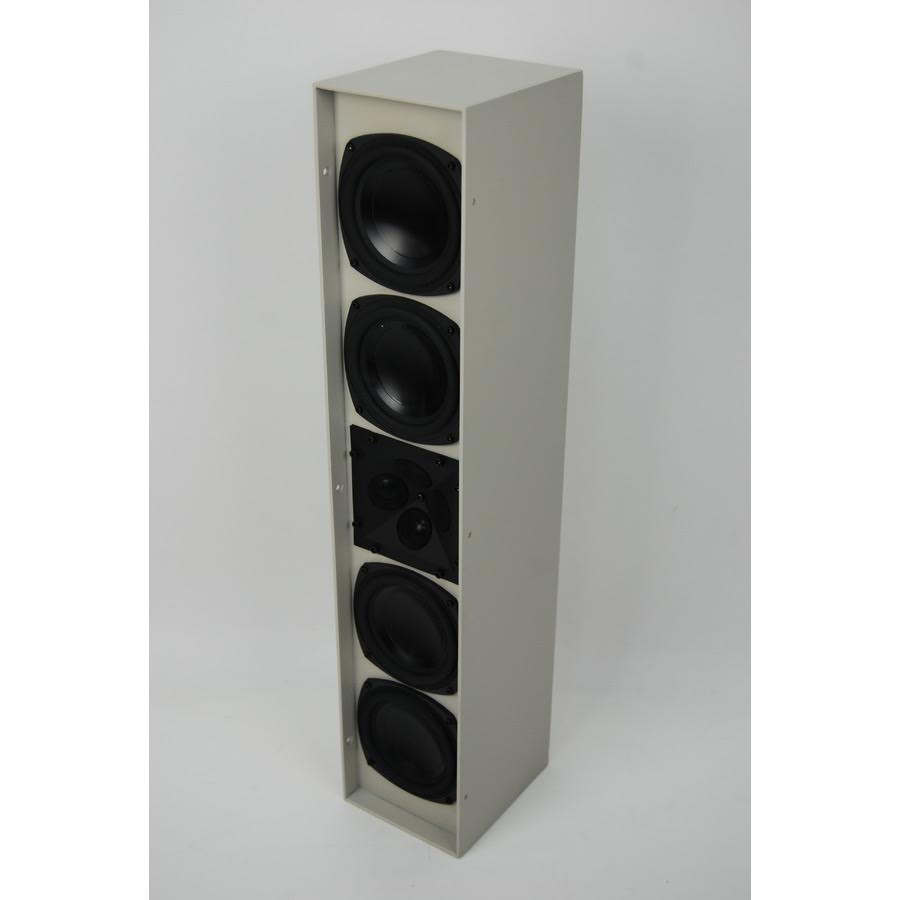

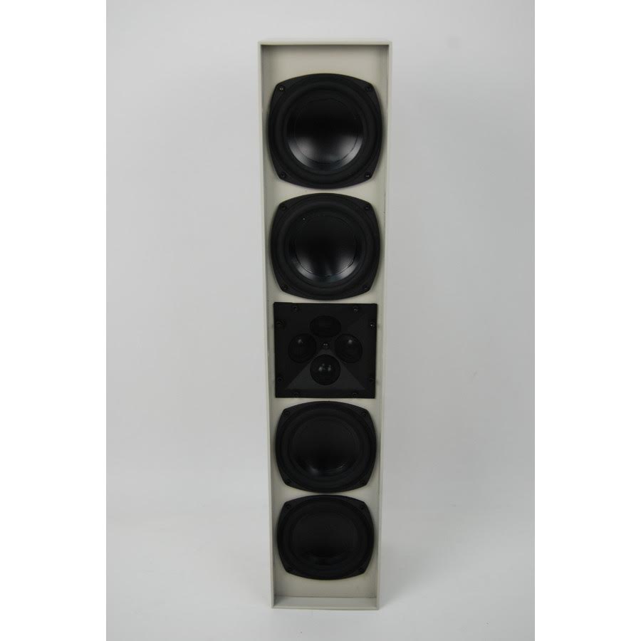

And here is the old denon receiver powering a B&W system using 4 sig 8 surrounds to be replaced by bespoke 5 inch woofs and quad domes TRIPLE CHANNEL SPEAKERS.

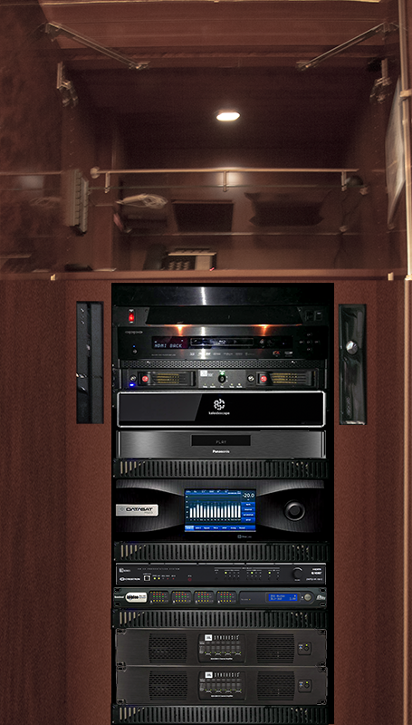

And the new shock mounted IMMERSION servcie rack (blu link connects front channels to the amps behind the OLED for x-overing bass management)

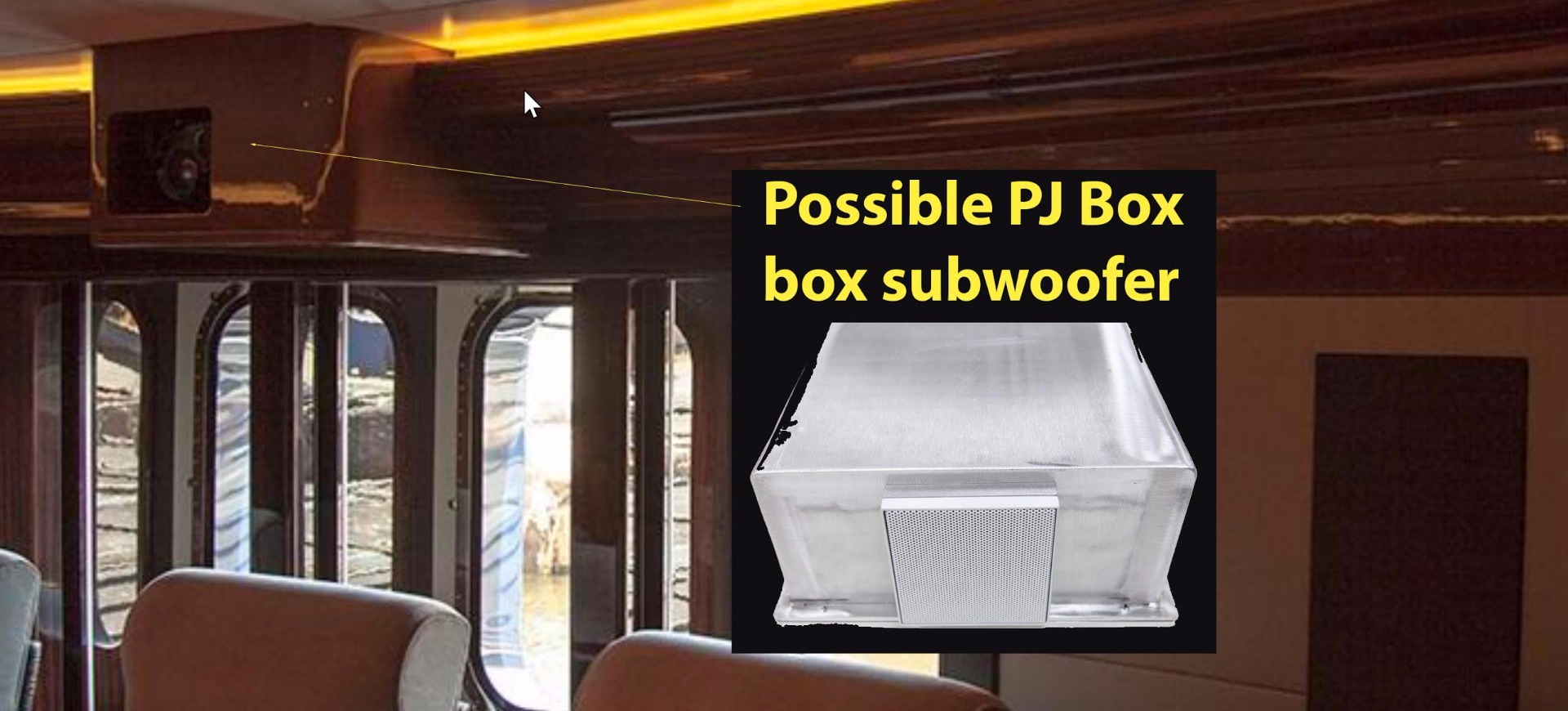

So CINEOLED's by definition get replaced with bigger screens, here is a sketch of the system x'mas 2017.
