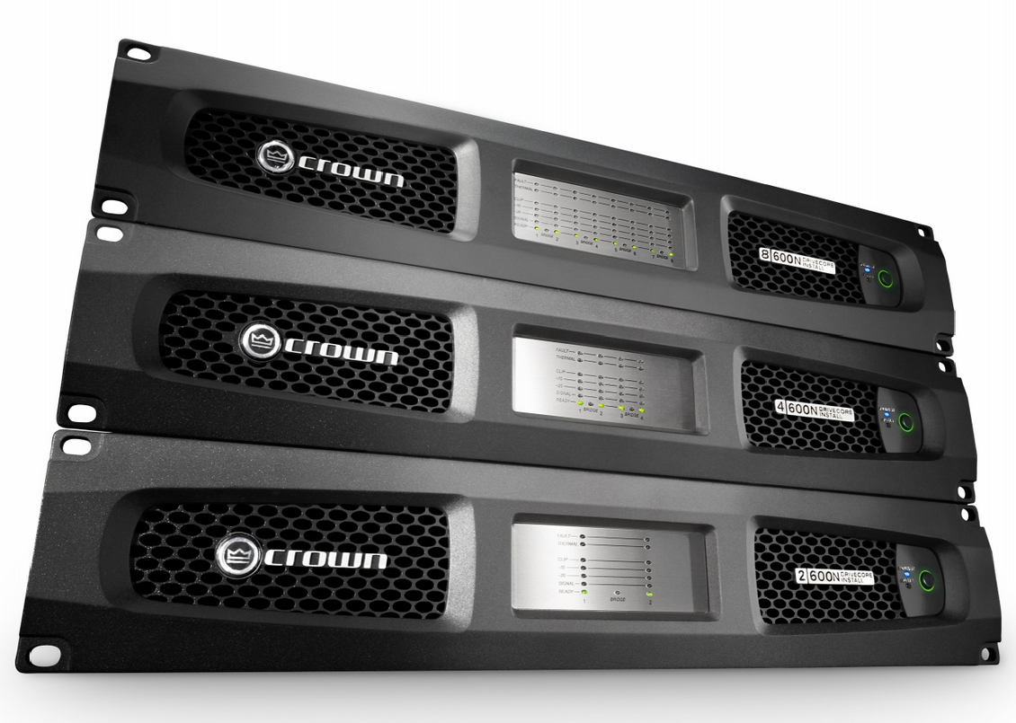

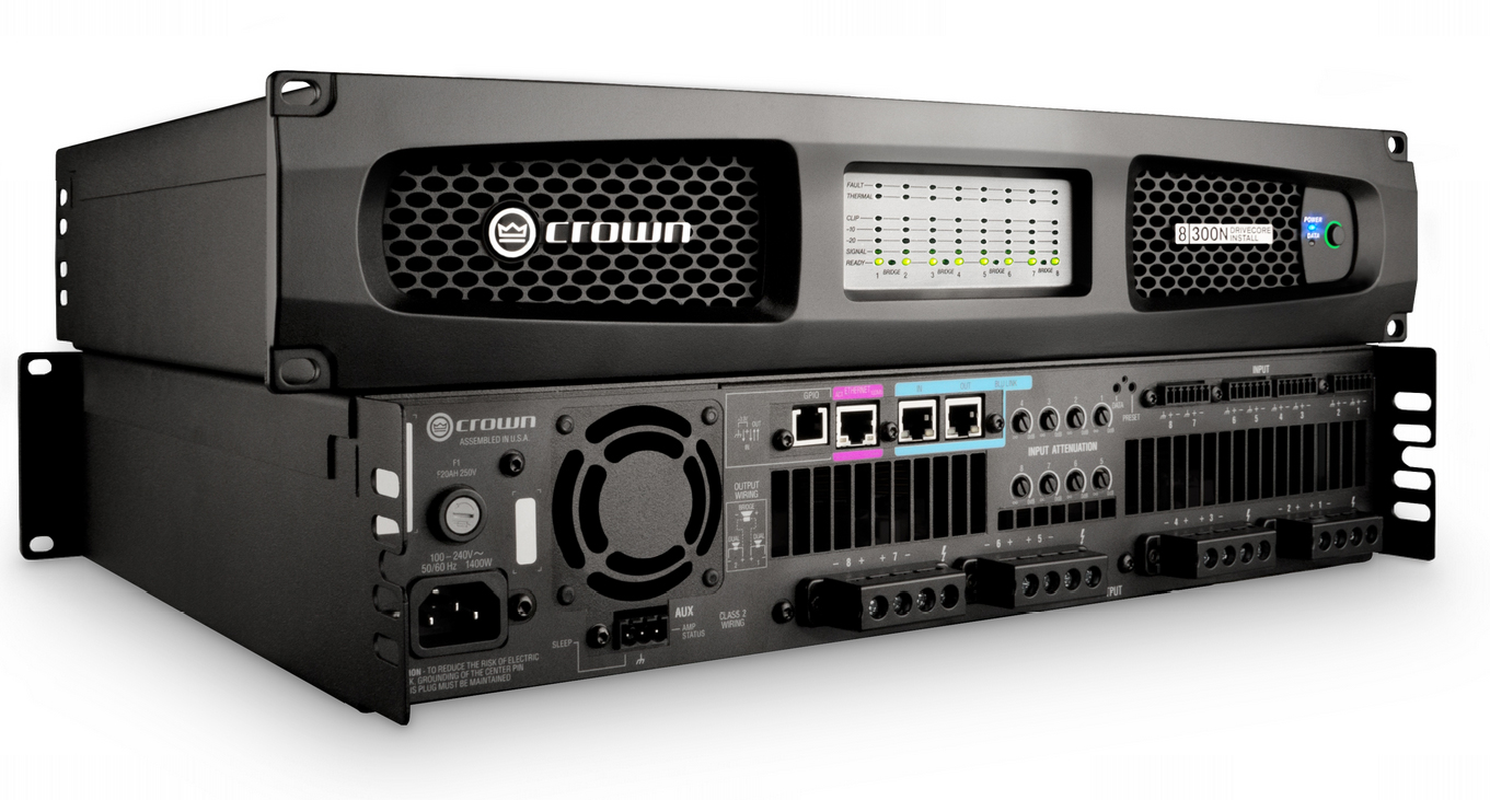

    3) The new DRIVE CORE Crown series of amplifiers. Also software controllable. Here I need help.
    So you can network the amplifiers for the theater via cat 6 and control with HiQnet London Architect software.
    I will continue this thread but my question at the moment is:

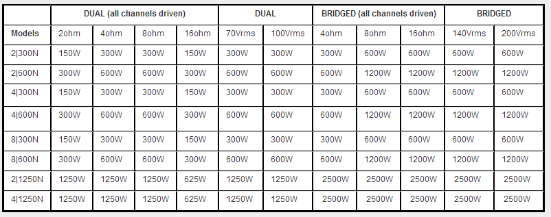

    Assuming a 22 loudspeaker channel system with the 3 Left Center Right speakers being 3-way, looking at the 8-600 and 4-1200 amps I should be able to use 2 channels out of the 8-600 to feed my Quested High and Mid Drivers and then use 1 of the 4-1200's channels to feed the low driver.
    Questions:
    1) Can this be done? Mix and match different channels out of amps? Or is one limited to one amp per speaker.
    2) Is the crossover set in the amp then?
    3) Is there a pass-trough output capability in these amps to route the signal to more speakers/processors?
    The spec sheet is not clear to me about these capabilities.

    • True Rack Density – power points of 300W or
    600W in 2/4/8 channel configurations and
    1250W in 2/4 channel configurations. Includes
    bridgable outputs of 300-2500W, all in a 2U
    form factor, providing flexibility in designs.
    • Minimum Guaranteed Power Ratings
    – DCi amplifiers are guaranteed to
    deliver at least the rated power in the
    specifications over a longer period of time
    than any other competing amplifier.

    • BLU Link compatibility – low latency, fault
    tolerant, digital audio bus, capable of routing
    256 channels using standard Category 5e
    cabling (over a distance of 100m between
    devices), provides an unprecedented level of
    routing flexibility.
    Oops I think my question was answered in the last paragraph.
