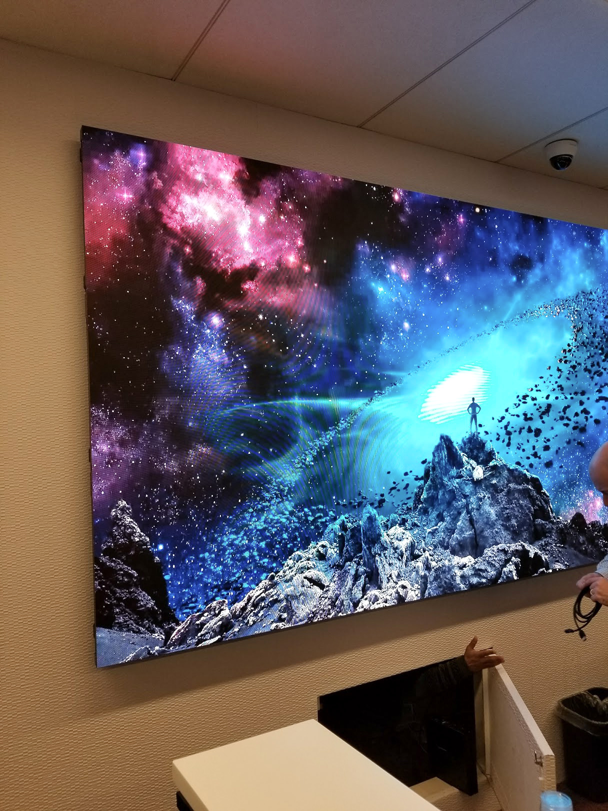

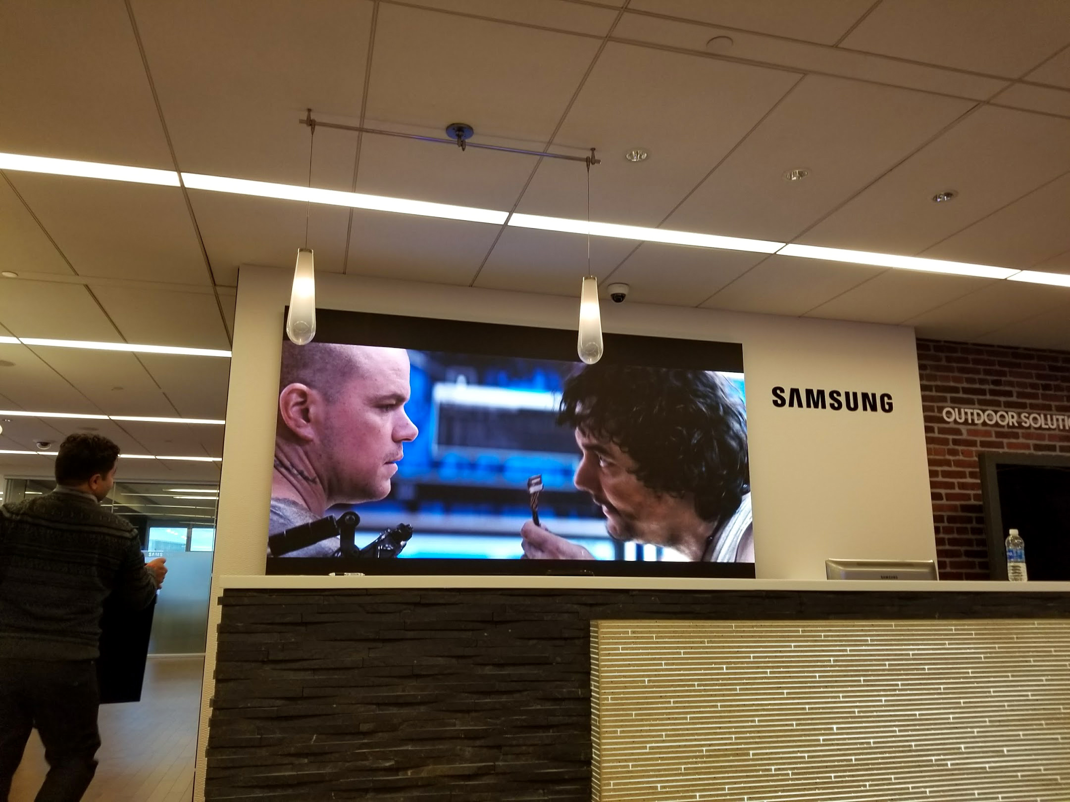

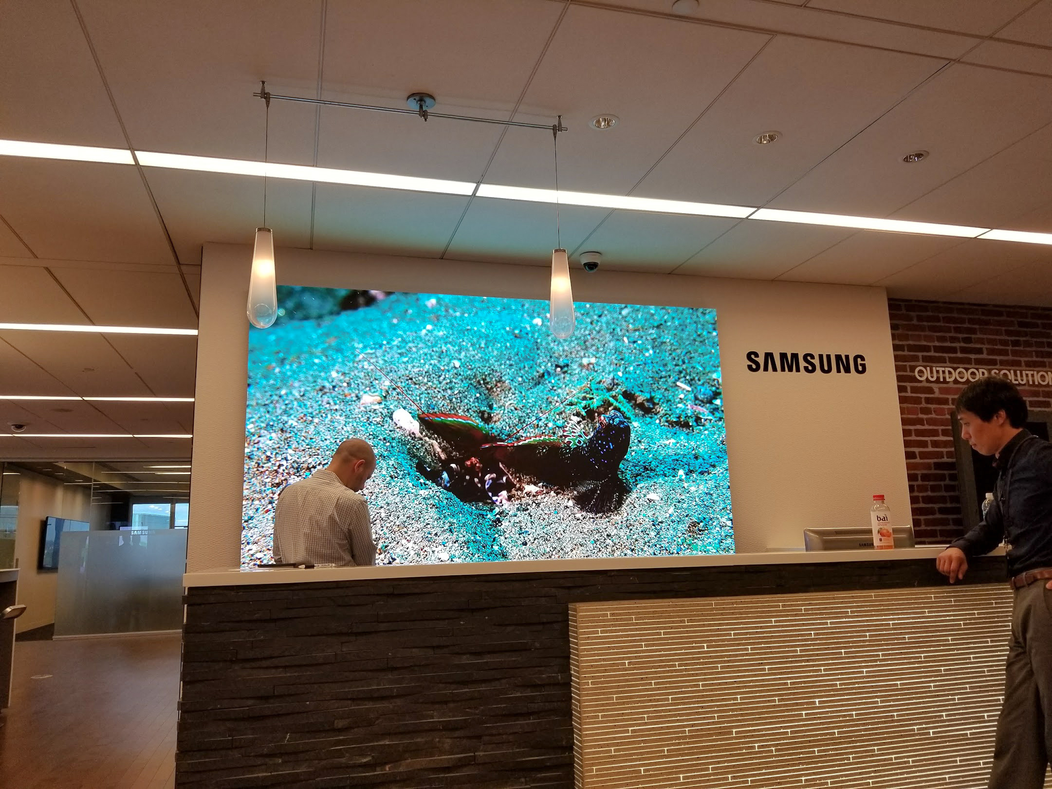

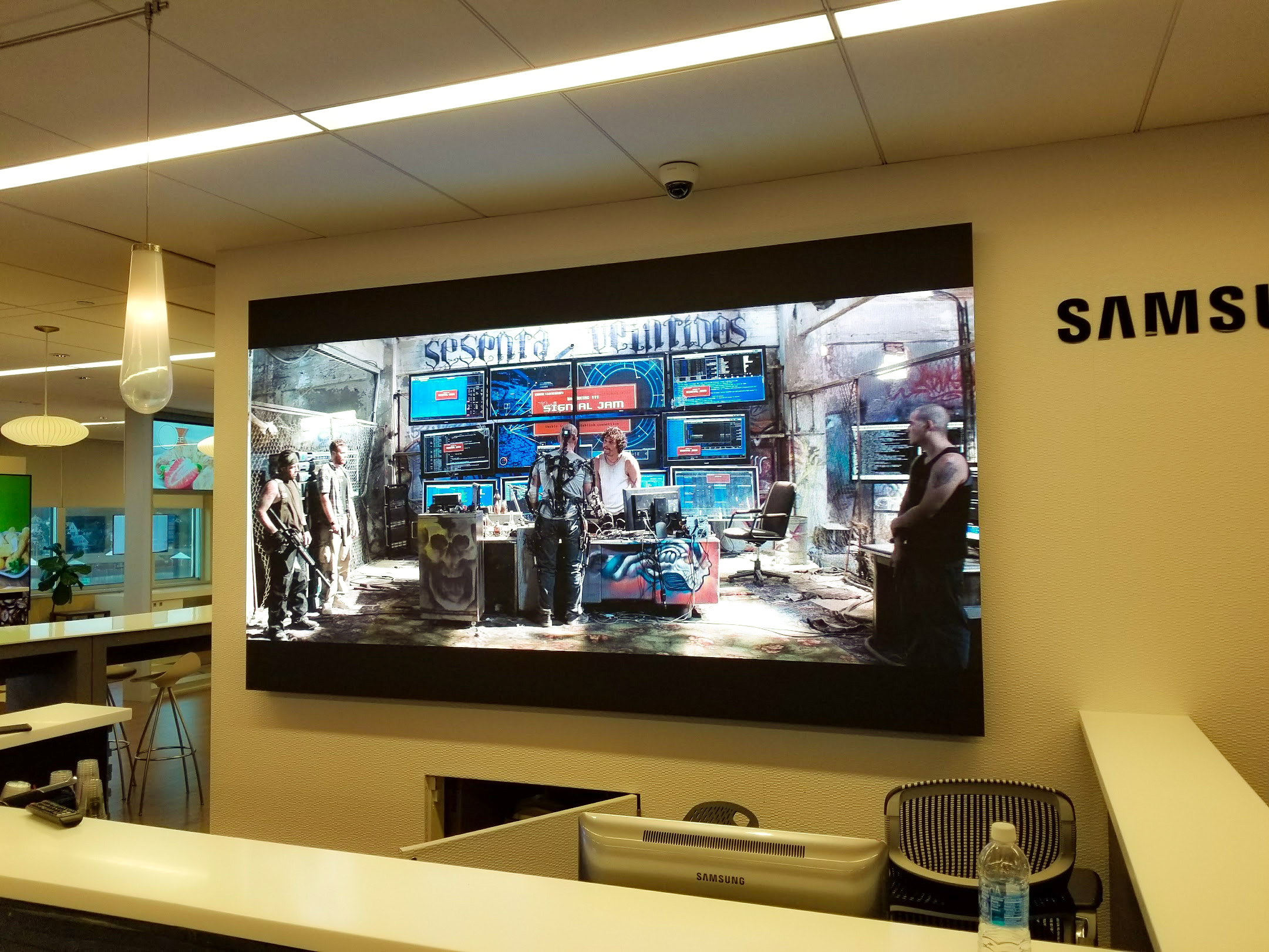

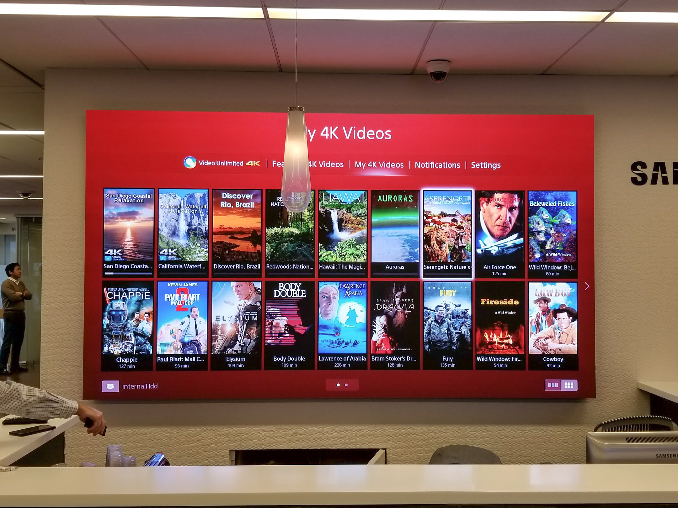

                            I went up to samsung to inspect the 1.5mm pitch system we will be implementing in The San Diego Omni PH.
                            https://twitter.com/CINERAMAX

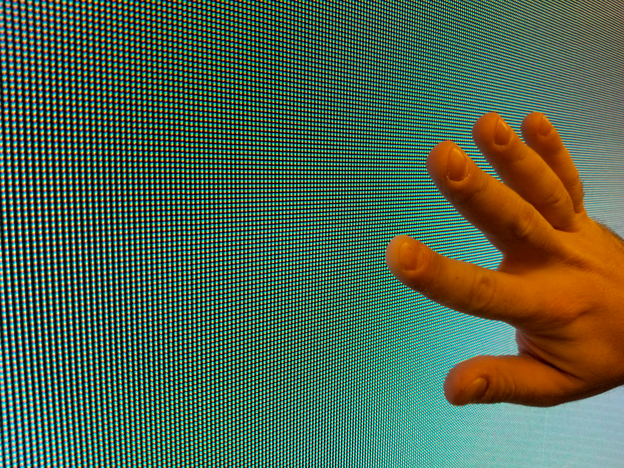

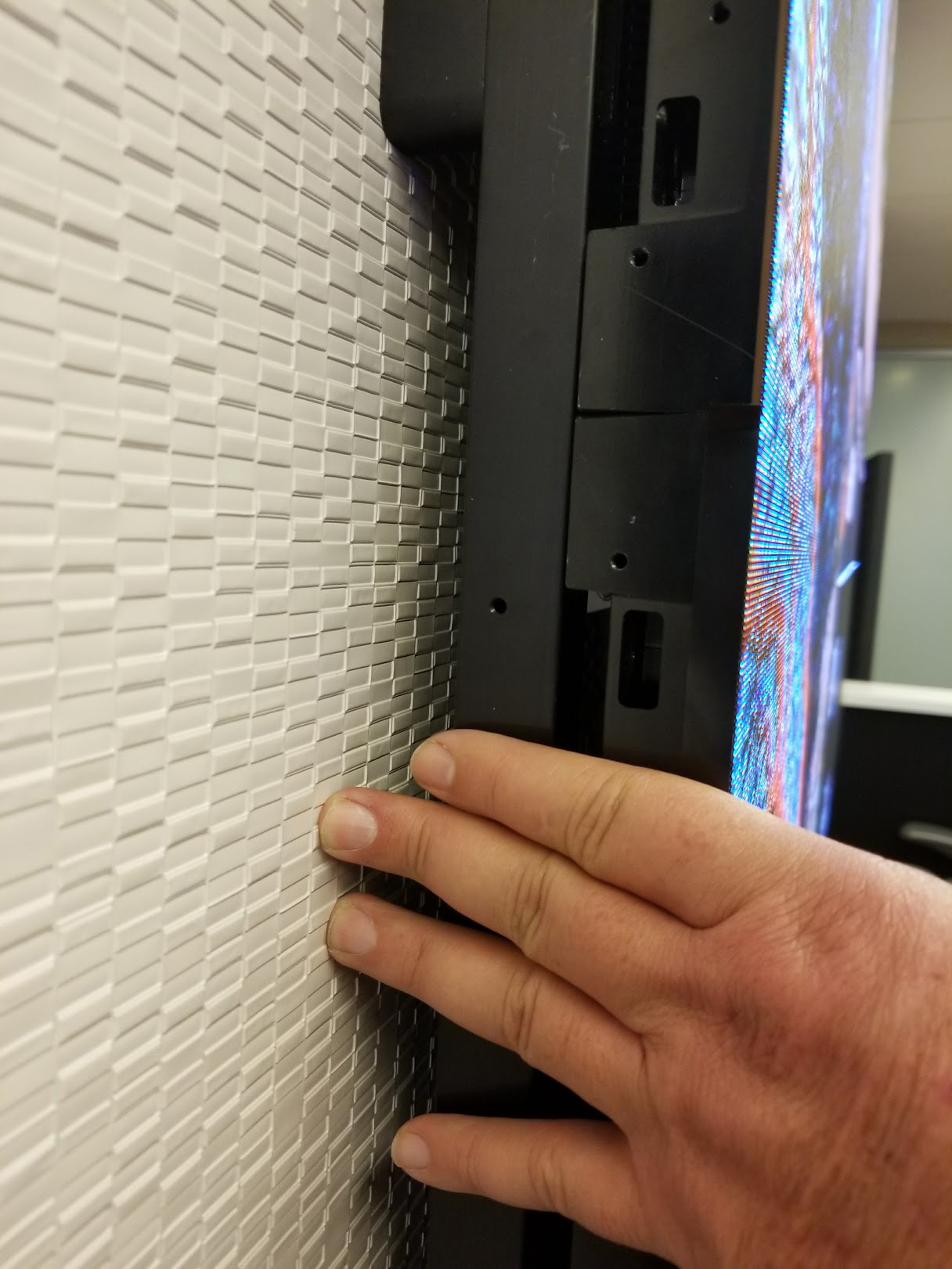

                            Like wolfgang I was surprised to see visible seams, and another artifact which i will cover later.
                            The visible seams ocurr because of level discrepencies in the Z axis. There is a spring tension screw adjustment that eliminates this, it works because in some parts of the image it was perfectly matched. The thing is that this is an office demo room and people go in and remove tiles and touch them etc.
                            It is theoretically possible that such seams if we had for example my engineer doing the adjustment and i sitting on the MLP that it could be near perfect.
                            John is very good like that.
                            https://youtu.be/nXbRmDAsl70
                            In addition to the same problem that samsung has in common with cledis there is an additional adjustment specific to the surface mounted LED's. Bright lines!
                            In the pixel rows where the two tiles meet each other there is increased brightness. There is a special calibration process where the brightness of the individual pixel rows is toned down to match the tile.
                            It works because there were a few tile junctures where it was perfect, but again because of the evrybody touches and plays with it nature of the demo system quite a few bright edges could be found.
                            ALL IN ALL it will be a lot of work but something having seen some of it working we feel, and also use spcial color analyser with 16 bit video resolution on a per tile basis will also enhance.
                            So it becomes a perfect challenge for us to bring into our lab and give it a CINERAMAX reference picture quality, we welcome this huge challenge.

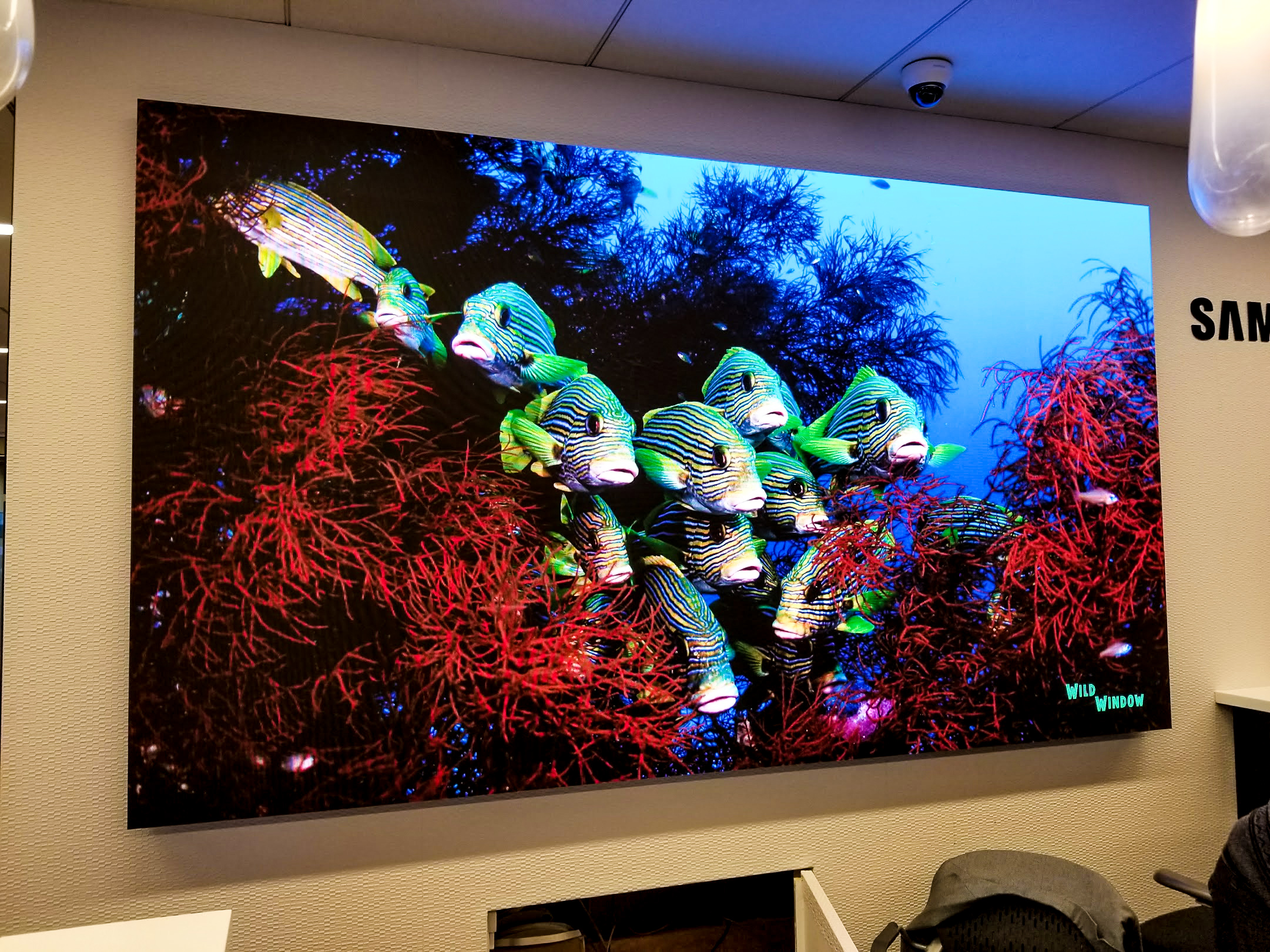

                            • #15
                              The best distance not to realise the pixels or the z-axis misleveled tiles is 12.5 feet. Fantastic image there.
                              Also do note that this set could be looking at a sunset without it being reflected or affected by the amount of light, so perfect for oceanfront movie watching is you do have the 12.5 feet /3.8 Metres.
