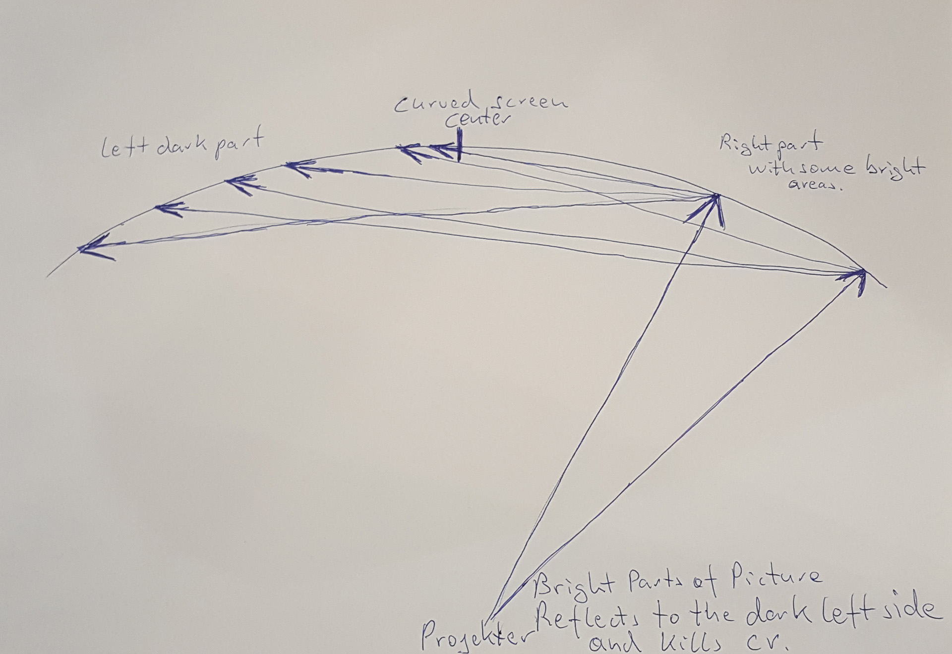

                      • I talk to many people about the issue that a curved screen had some less good cr. visible compare to flat screens.
                        The people I spoke are beside Oliver  all retired cinema people with at least each 40 years of experience.
                        It is very simple as no one can change physics.
                        There is light coming to a screen part that show a dark picture like in my hand drawing.
                        The only difference is how much gain factor a screen have.
                        So in cinema they use mostly 1.8 to 2.5 gain and there the light was much more reflect back to the viewer and less to the side.
                        So in cinema this is not a big issue and on top cr. in a cinema is typically in the 500-1500:1 cr. range because of Exit sign and many other things so a curved screen will not change this very much.
                        In home cinema with a screen like the V6 it is opposite.
                        So you can say in general about this issue:
                        ”The more gain a screen have the better as it not ruin your cr. when use a curve screen the less gain your screen have the worse it will”
                        Again this is based on simply physic but it was also proved by some statements I got from people that do hundreds of screen the last 40 years.
                        As improved cr. is one major reason why I like to try the V6 I will do a flat version and not a curved one.
                        I will not doing tests about this as this will only take my time and I know the outcome already.
                        Sad as I like the curved version a lot but as always there is most of the time a trade of.
                        Similar to my Projector the Barco Thor when you like high on off cr. you lose almost 50% light to double the on off cr. number.
                        This comes on top with my lost for the new V6 screen that will be about 20% darker!
                        For all 2D include UHD HDR material a no issue as I drive the Barco Thor in the good 50% Laser power only so I can easy compensate the -20% lumen but for 3D I will suffer as my 20FTL will then going down to 16 FTL.
                        But I will see a speckle free image with a lot better cr.
                        From my tests I did cr. looks visual ratet at least about double as good compare to my Harkness Matt Preview that I today use.

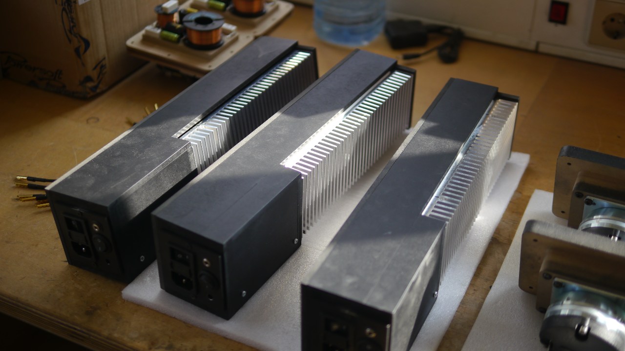

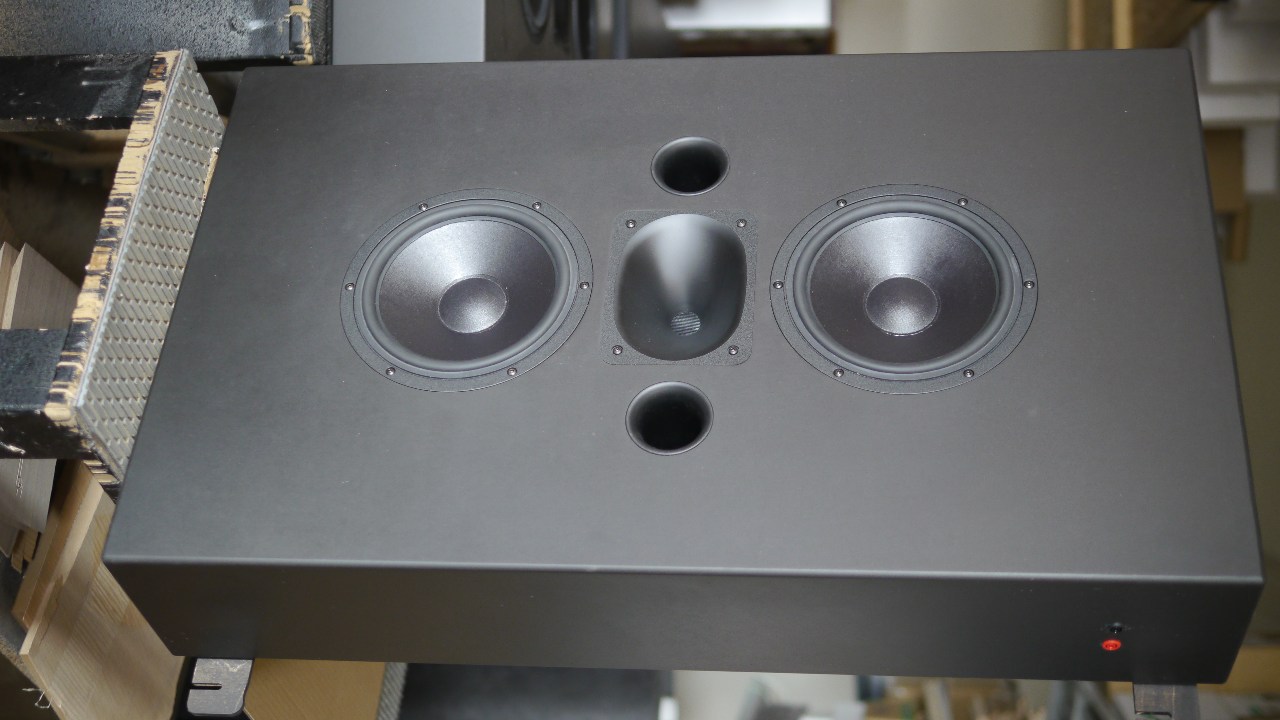

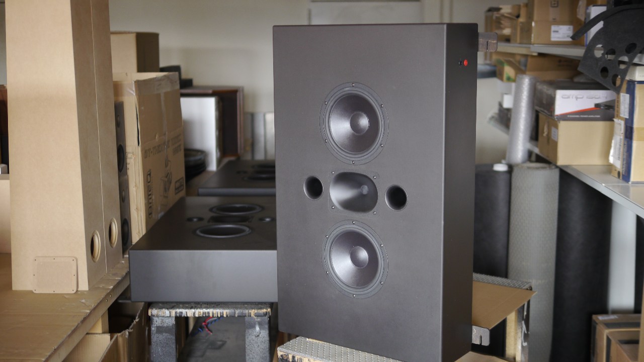

                          • New very flat (only 18 cm!) custom develop 3 Front Speakers that comes behind the new V6 screen are almost ready see pictures.
                            Let’s see if I can get it this week or soon after eastern.
                            • Very nice looking custom speakers. The shallow depth is very rare, a nice feature for a home theater system.
                              What are we seeing in the third picture? I see a heat sink, are these the amplifiers?
                              • Yes this are high end digital amplifiers as all my speakers are active.
