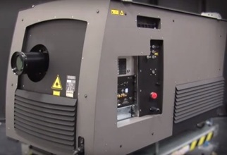

Head unit is quiet but you need to run water hoses to chiller unit.
Barco Laser Proto - End product is slightly longer than B chassis
Looks like a Military weapon. It will be interesting to see the production design.
Question, Why the need for water cooling wasn't reduced heat a benefits of Laser.<\q>
I'm guessing the total BTU's are probably much lower than a xenon arc lamp, but the heat is concentrated at the lasers requiring liquid cooling since it's more efficient at carrying away the heat. Depending on the cooling requirements, an active (i.e. refrigerant) system rather than the usual 'passive' forced air or fan-cooled radiator system may be needed, and that is something you don't want/need at the head..
LED light-bulbs throw off MUCH less heat than an incandescent, but they need serious heat sinking at the bulb, something the old bulbs didn't need.
That makes sense and most likely the case. Thank you.I'm guessing the total BTU's are probably much lower than a xenon arc lamp, but the heat is concentrated at the lasers requiring liquid cooling since it's more efficient at carrying away the heat. Depending on the cooling requirements, an active (i.e. refrigerant) system rather than the usual 'passive' forced air or fan-cooled radiator system may be needed, and that is something you don't want/need at the head..
