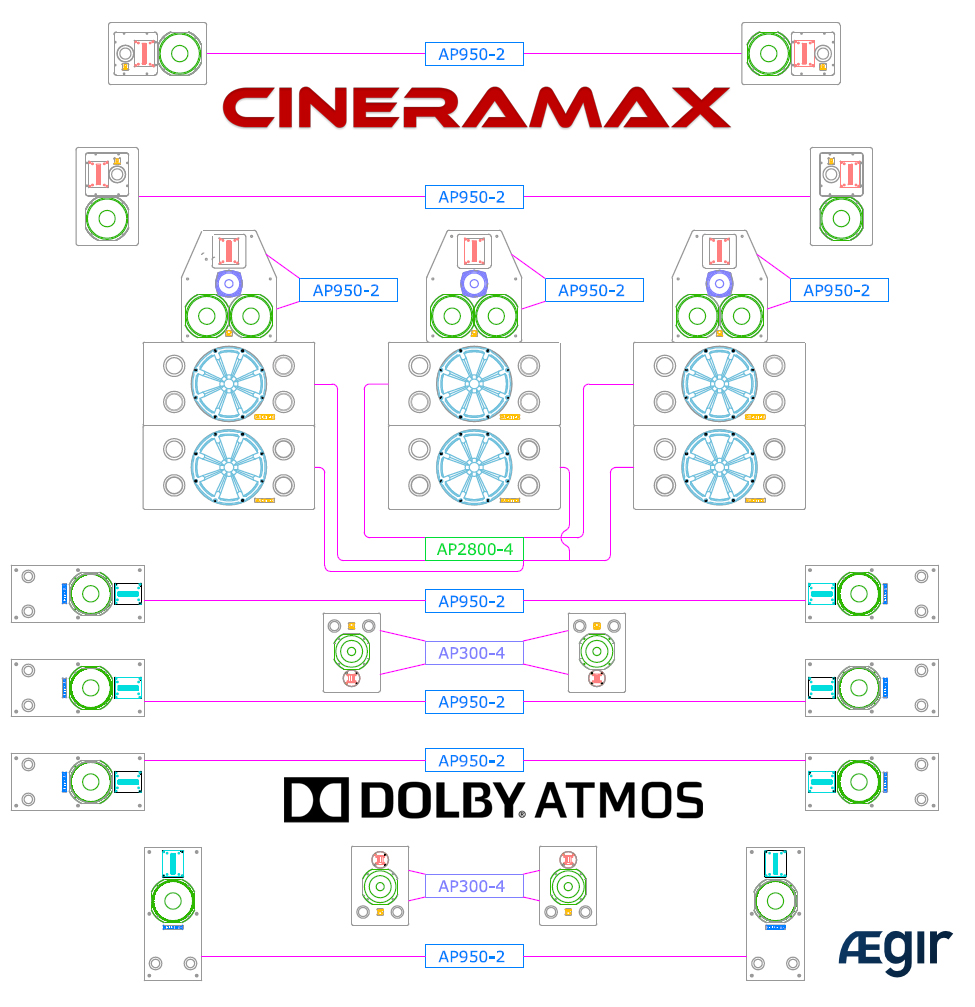

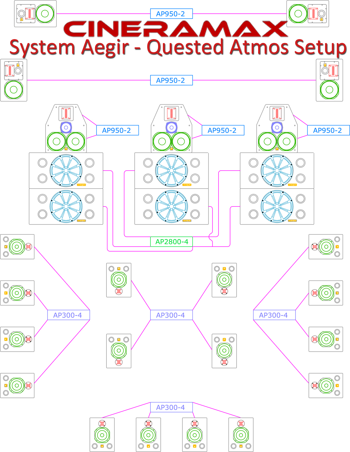

      Here we have the latest Speaker and Amplifier setup that shall deliver Atmos from the CP-850 at it's maximum possible clarity and impact.

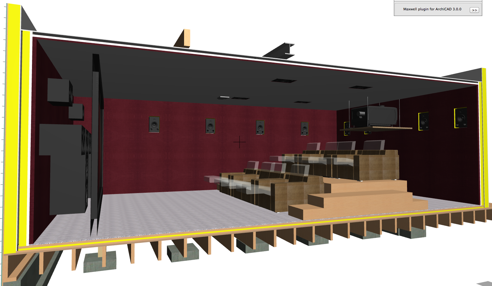

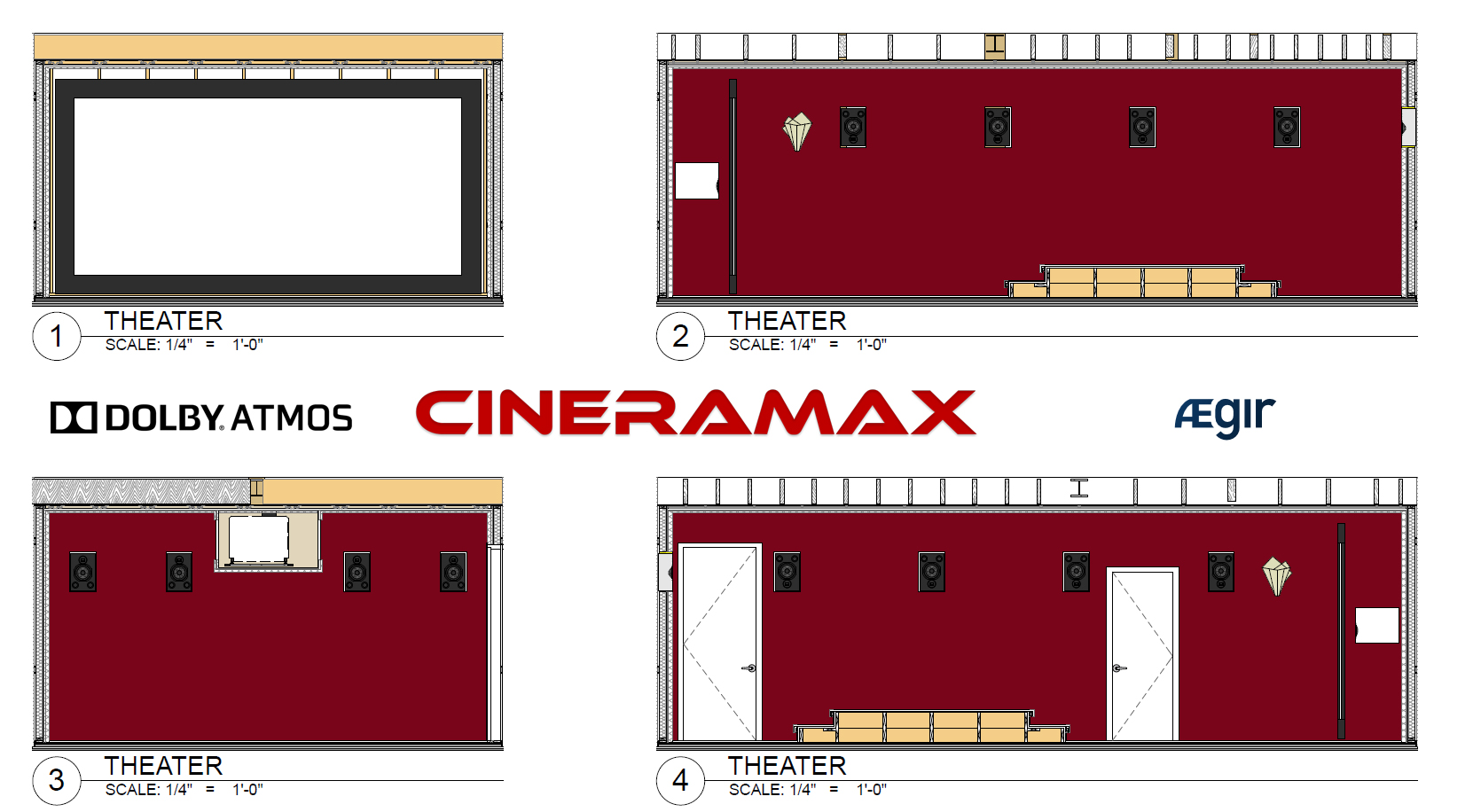

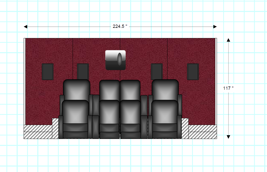

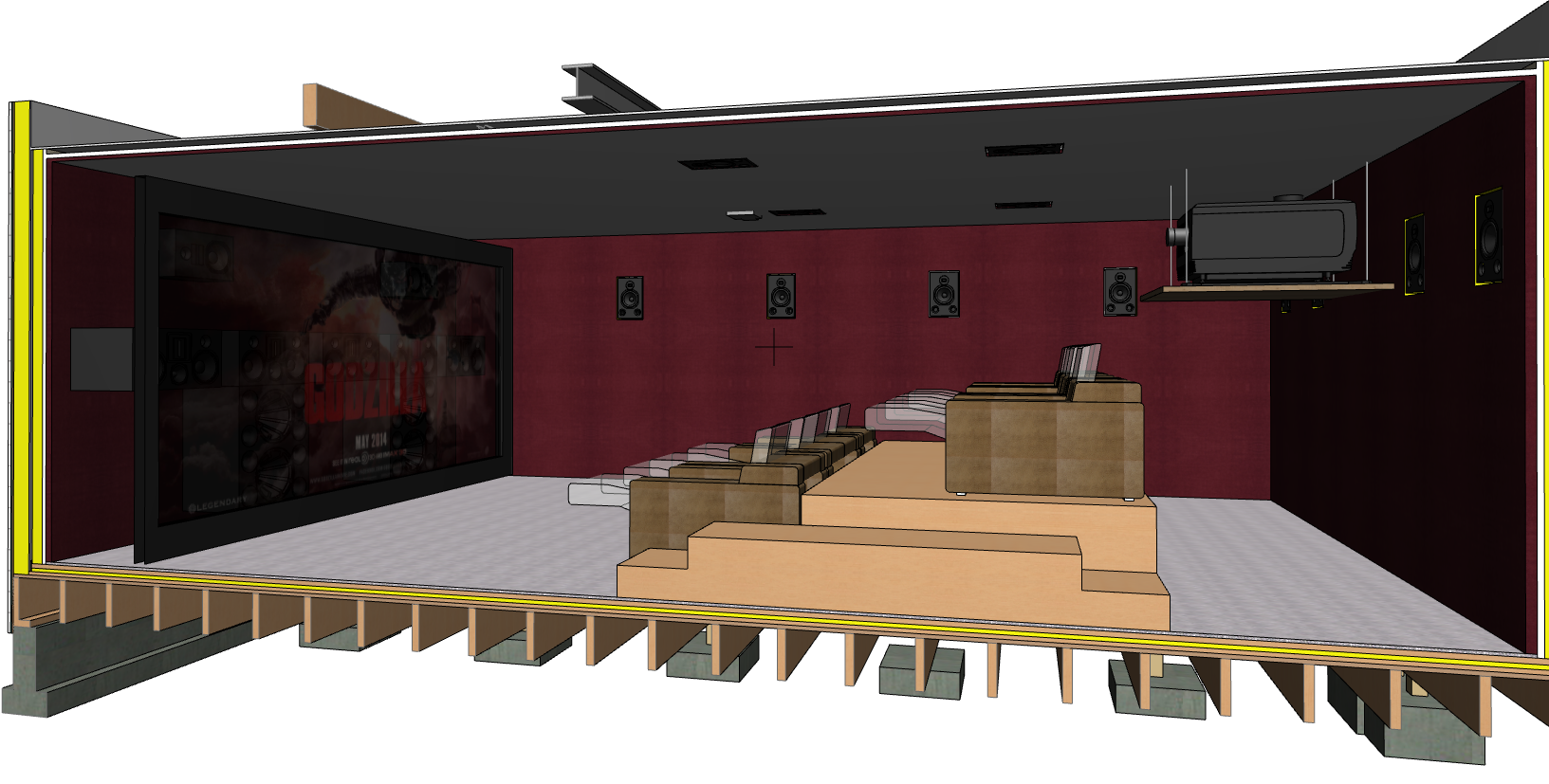

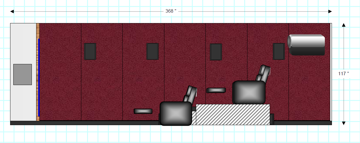

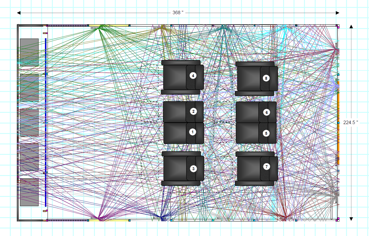

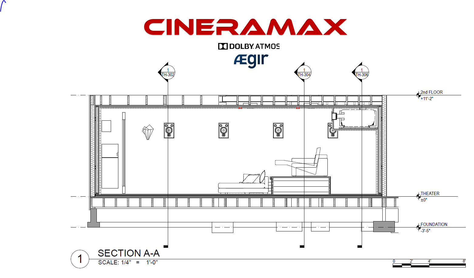

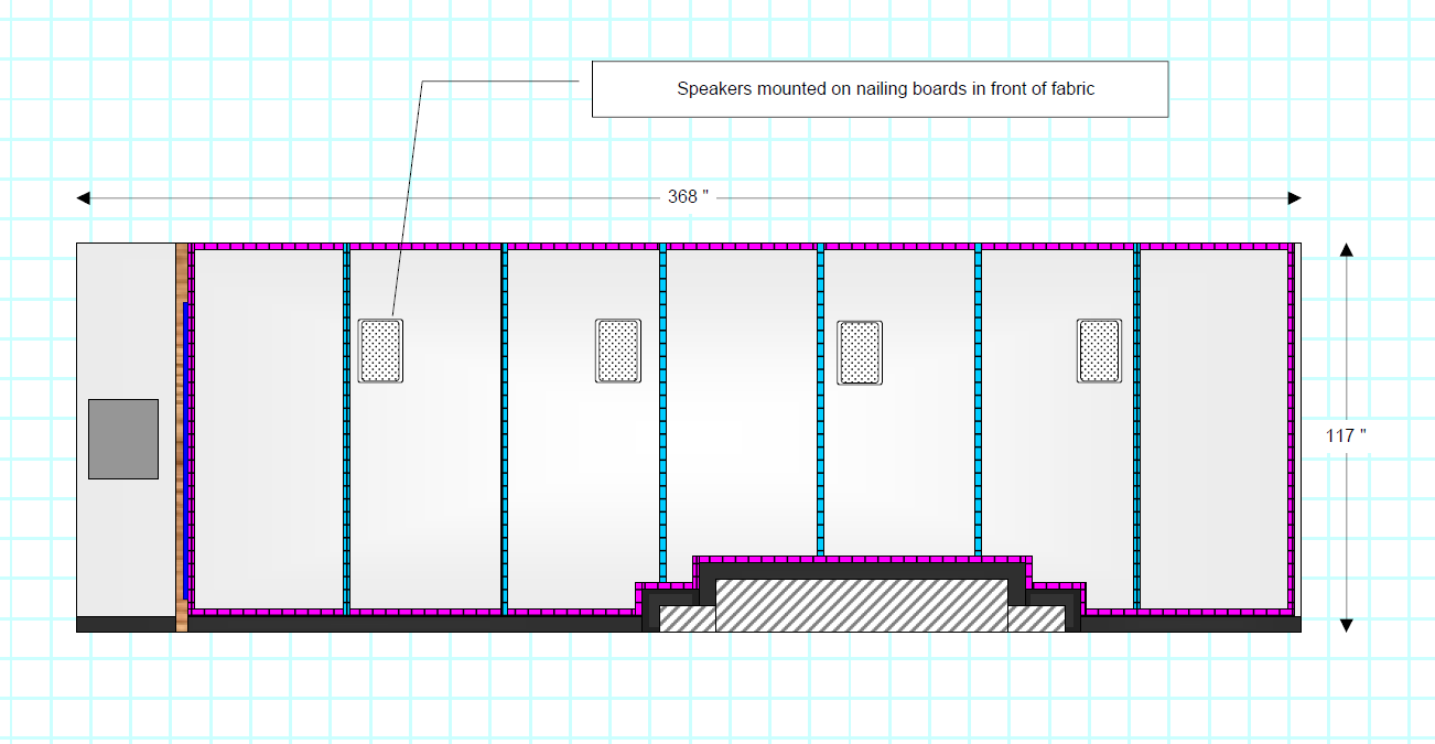

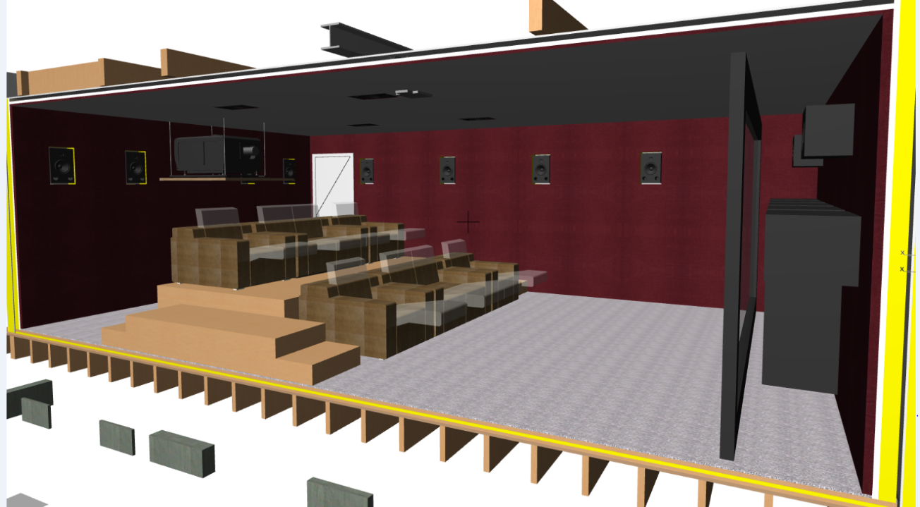

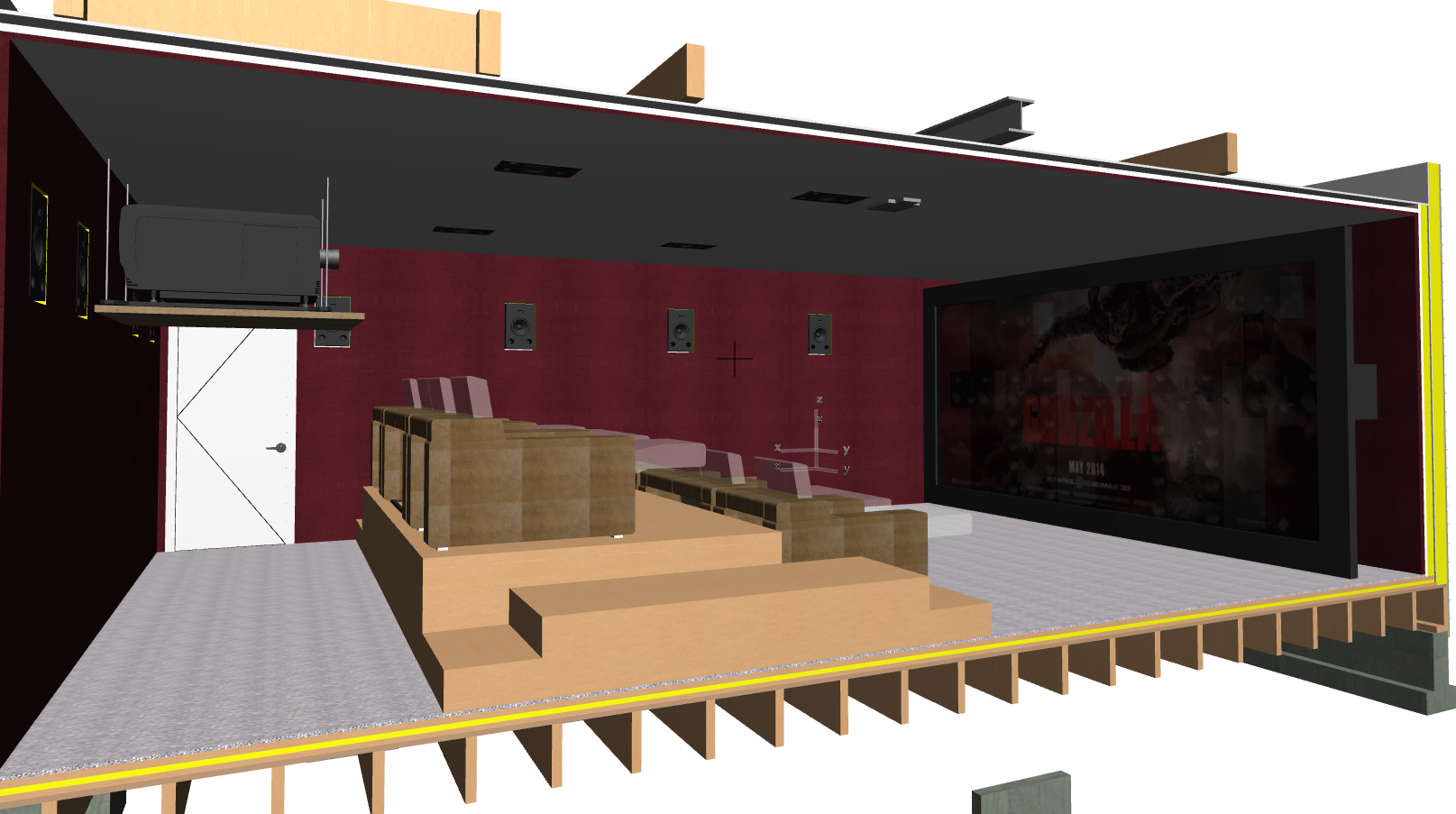

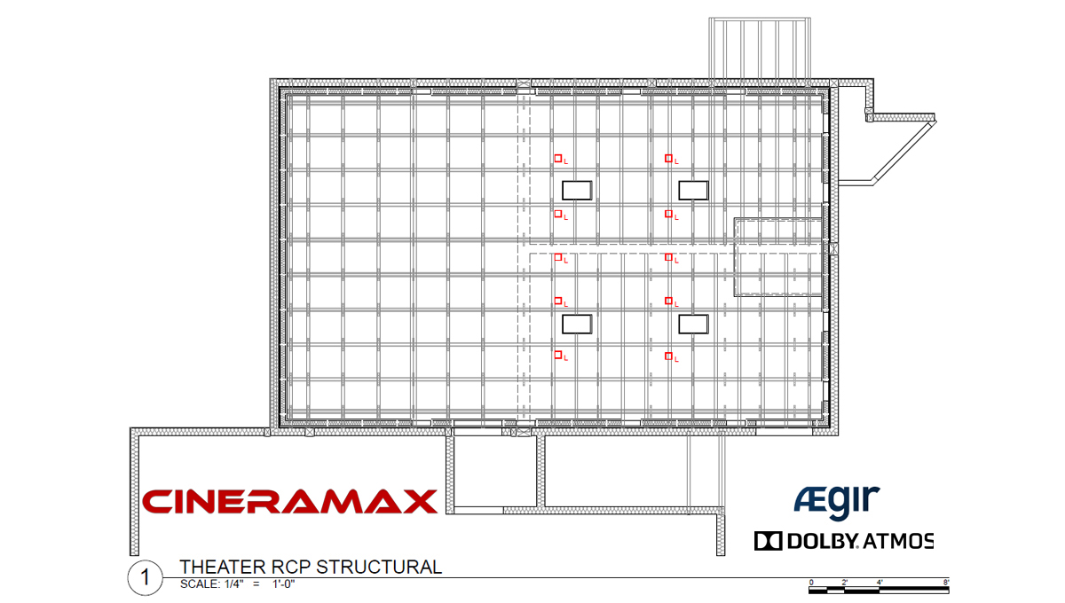

              I had to explain the atmos surrounds and ceilings (16 speakers) are flush mounted. I convinced the owner to use independent framing around the speakers with a neutral color offering subdued 2 tone markings that there are really that many speakers in the room.
                  It really is evident in moments like this in the cinema design that without a competent BIM architect you cannot undertake such endeavor.

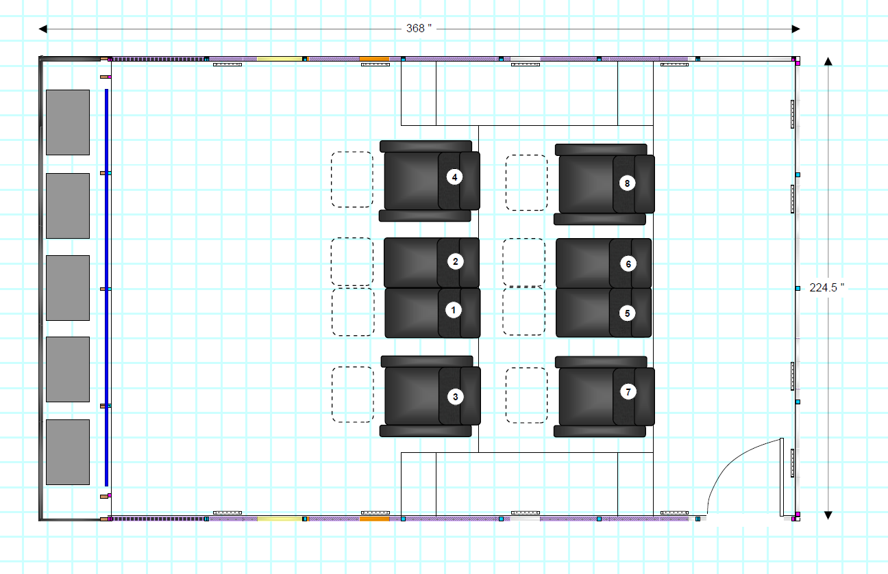

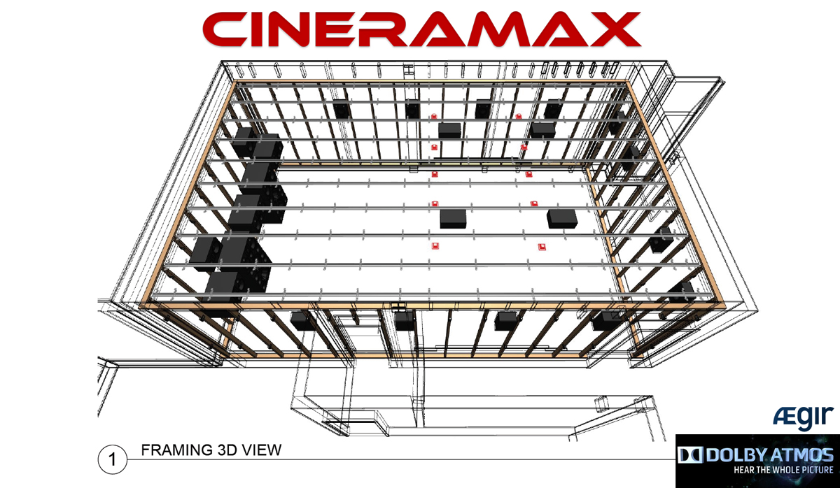

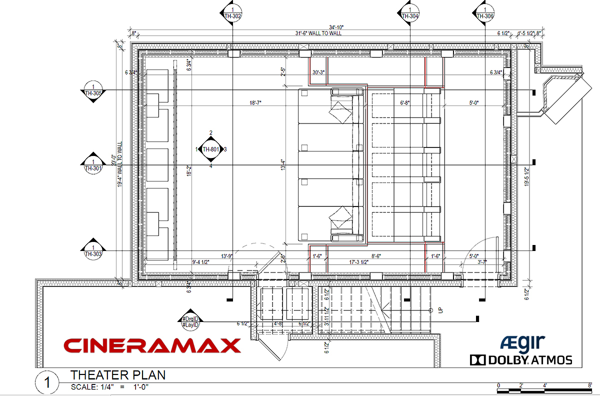

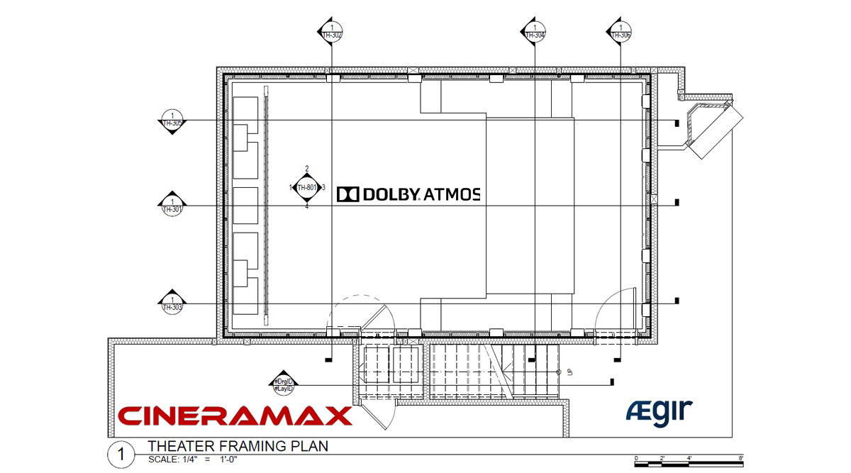

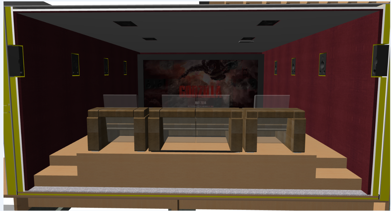

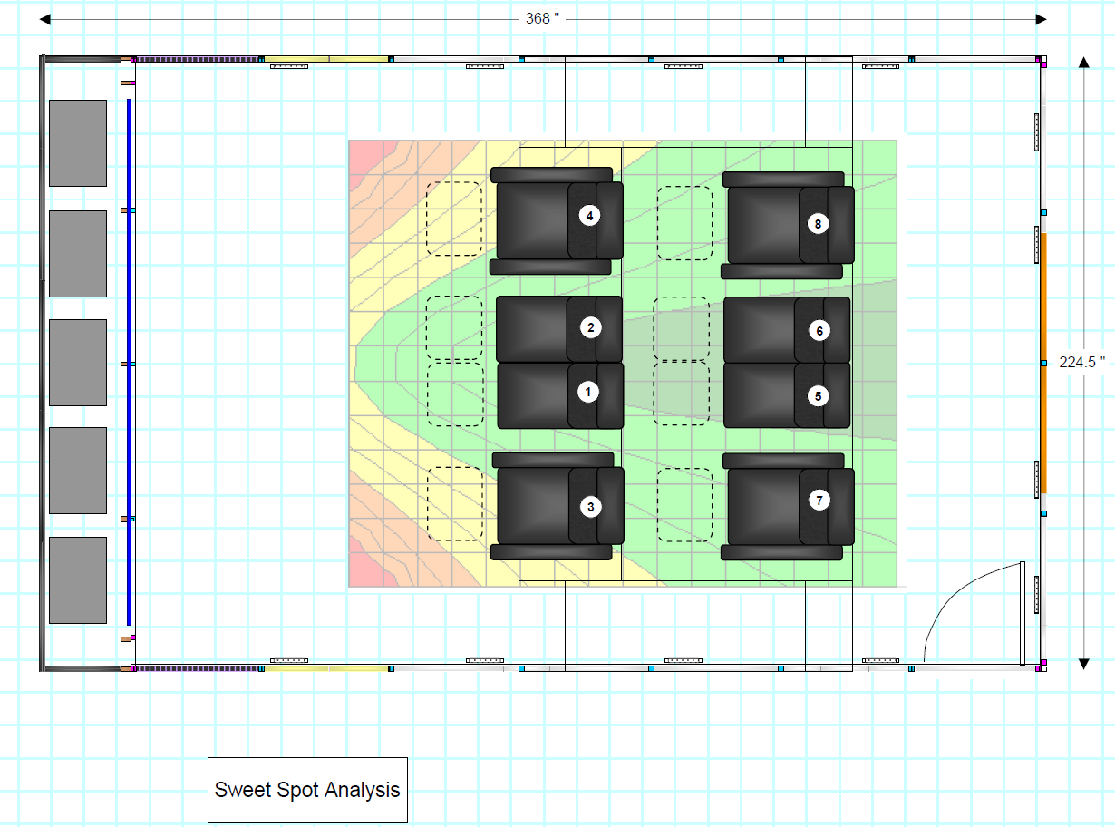

                  The client selected the seating layout with a front sofa but we are pending the autocads for the rear incliners so we have collisions with what the pdf of said chairs says (we have the old style chairs from Cineak and not Cinematech on the back row but show the family sofa correctly), we accommodated the rack and laid out the doorways. Which reminds me to discuss acoustical doors with client. However In latest conversation with custom 4 way mask screen builder due to seismic req. he said he needs a door to insert the screen into the cinema, so now I have to go back to him and see if he needs a full height or just the length, because if so our rack closet doors would suffice. 2 sconces have been drawn (client owns of which the left one immediately appear to collide with the swinging action mega-screen.It will be interesting to sort out the rest of the sconces as we have to solidify the surround speakers as we may use less speakers (24-28 channels instead of 30) due to Roger Quested's new secret Weaponized Atmos Surround on steroids design and so it goes but here are some sexy Atmos layout 3D's. 15 years from now remember where you first saw them!
                    I LEAKED Quested's next plateau for 140+ decibel all around Atmos, here is a draft without the amps. The Game is afoot.
                    You are literally seeing the first droplets of the impending Home Atmos Douwnpour, before you get your feet wet remember where it came from. And how generous we have been showing you the right path....

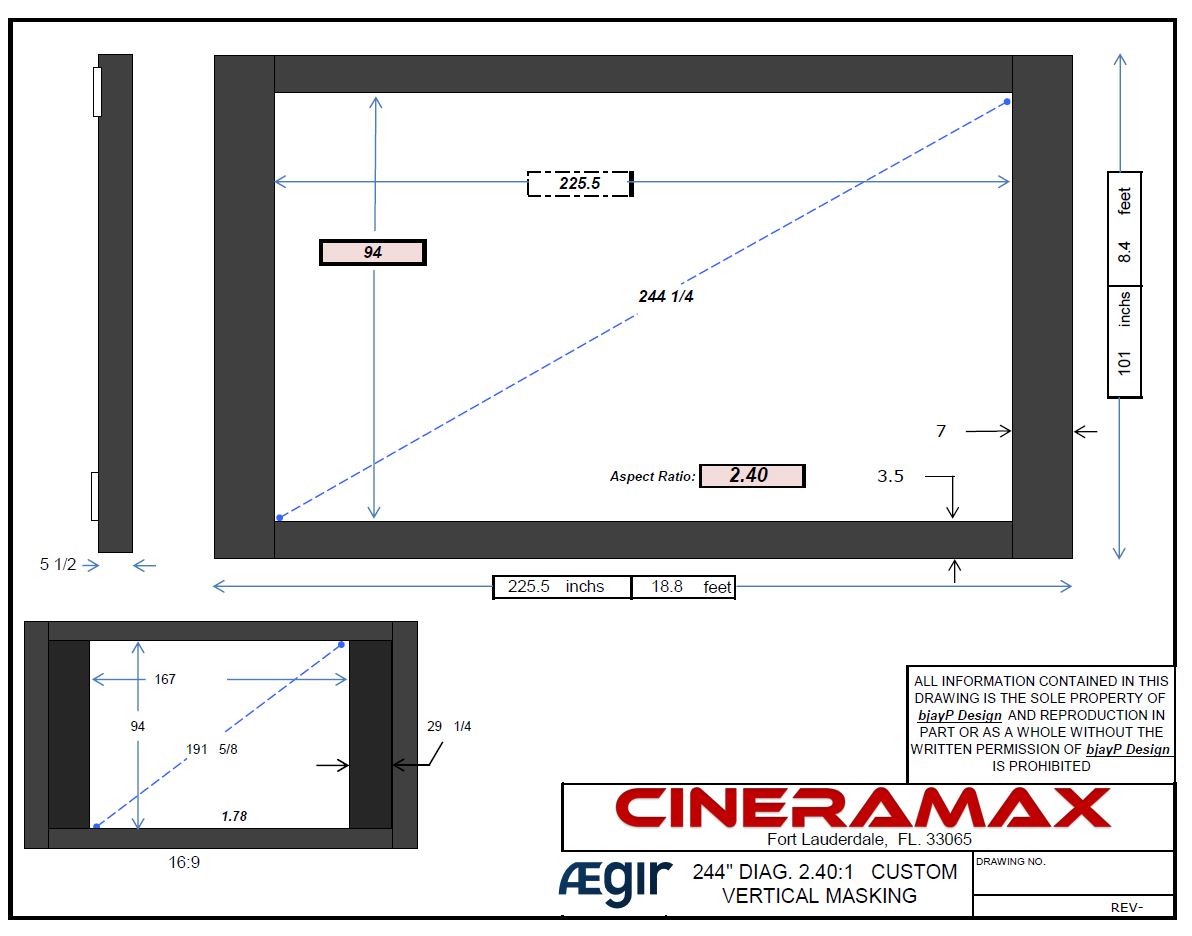

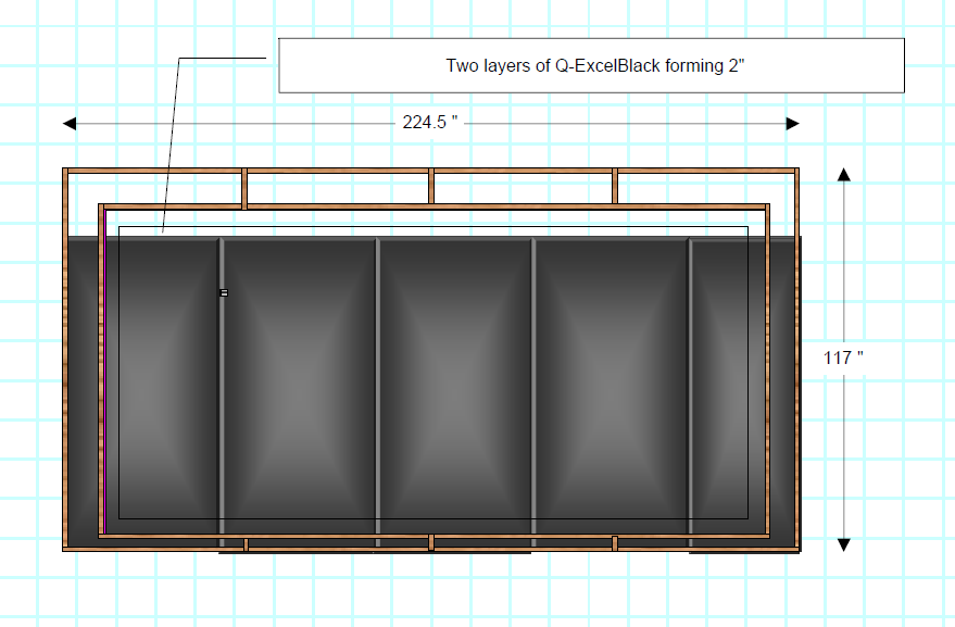

                      We Got screens, since the large format fixed lens did not fall in our actual throw distance range we have decided to forego tru 8k resolution fixed lens for custom museum grade ground optics no bonded elements Superkontrast zoom lens from obscure but SOTA optics company that just gulped AMF optics.
                      This has paved the way for the exploration of maximum screen size. With the thought that 4 way frames are thicker than 2 ways we are starting we 2 wy designs, between you and I I want 4 way if it don't cost 4 inches in diagonal, I shiver with anticipation.
                      Good news that the rack closet doors now permit getting the screen into the room. Great design just flows sometimes, after months of pounding the pavement with your forehead. that is.
                      But I digress, voila:

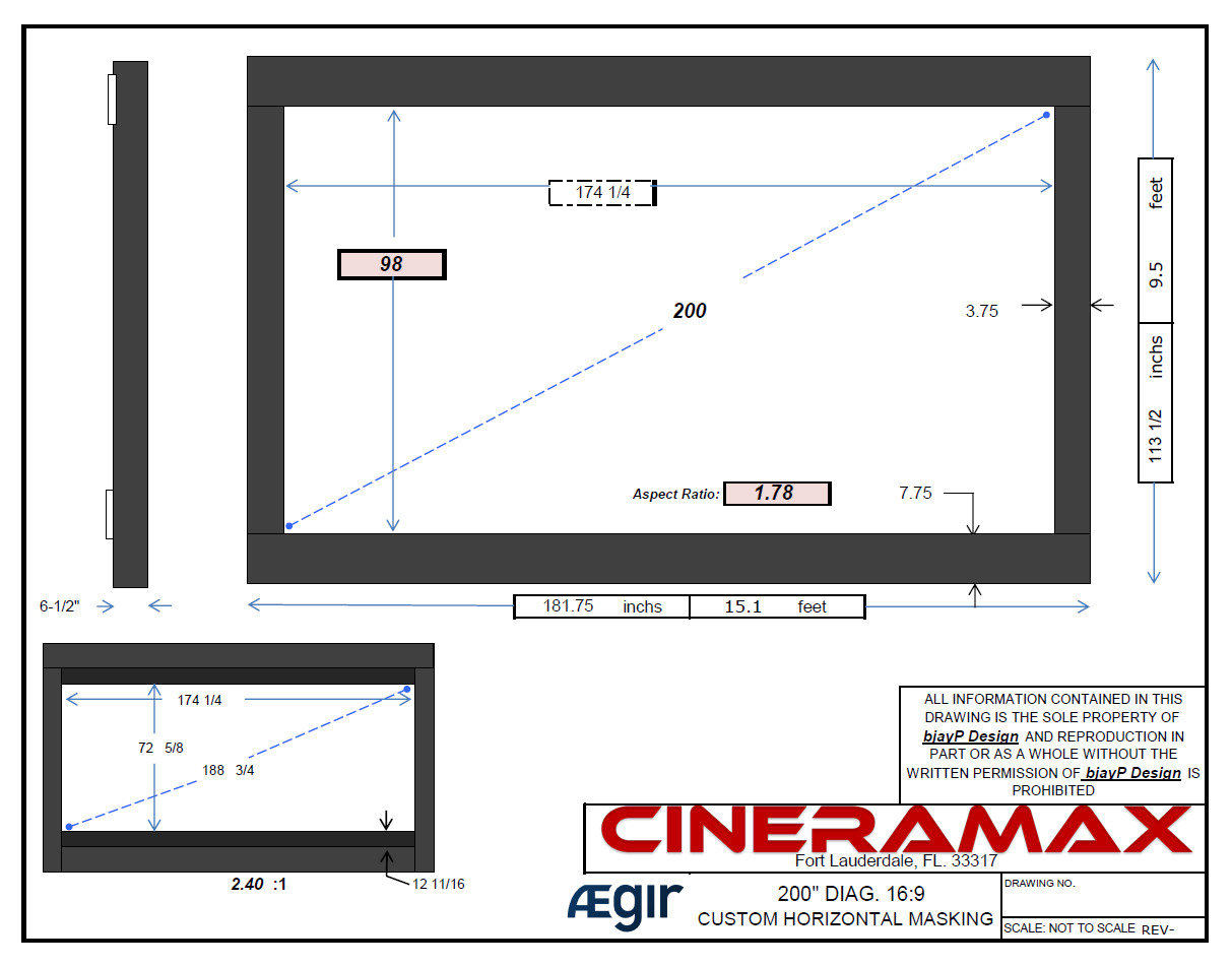

                      The Flat dimension is 14 1/2 feet wide [ Nothing to write home about id rather go 2.0 and crop all the times but why go hillbilly? 4 way it must]

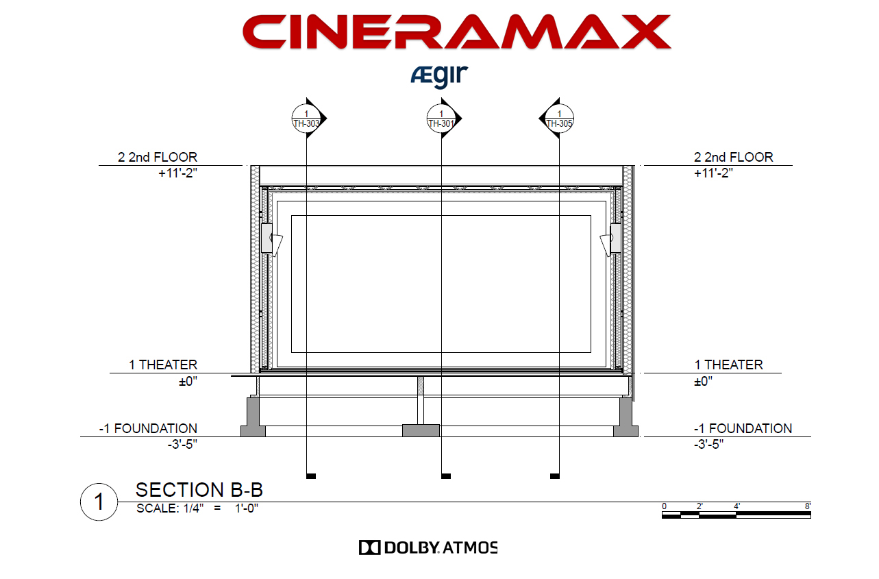

                      These are our new seismic rated wall to ceiling mega-screens on a Hinge.
                        Now the cinemascope screen is certainly respectable 18.8 it actually gives me enough slack to predict this is going to be a native 2.0 4 way, watch.... Im glad because that is what's in the3 budget.

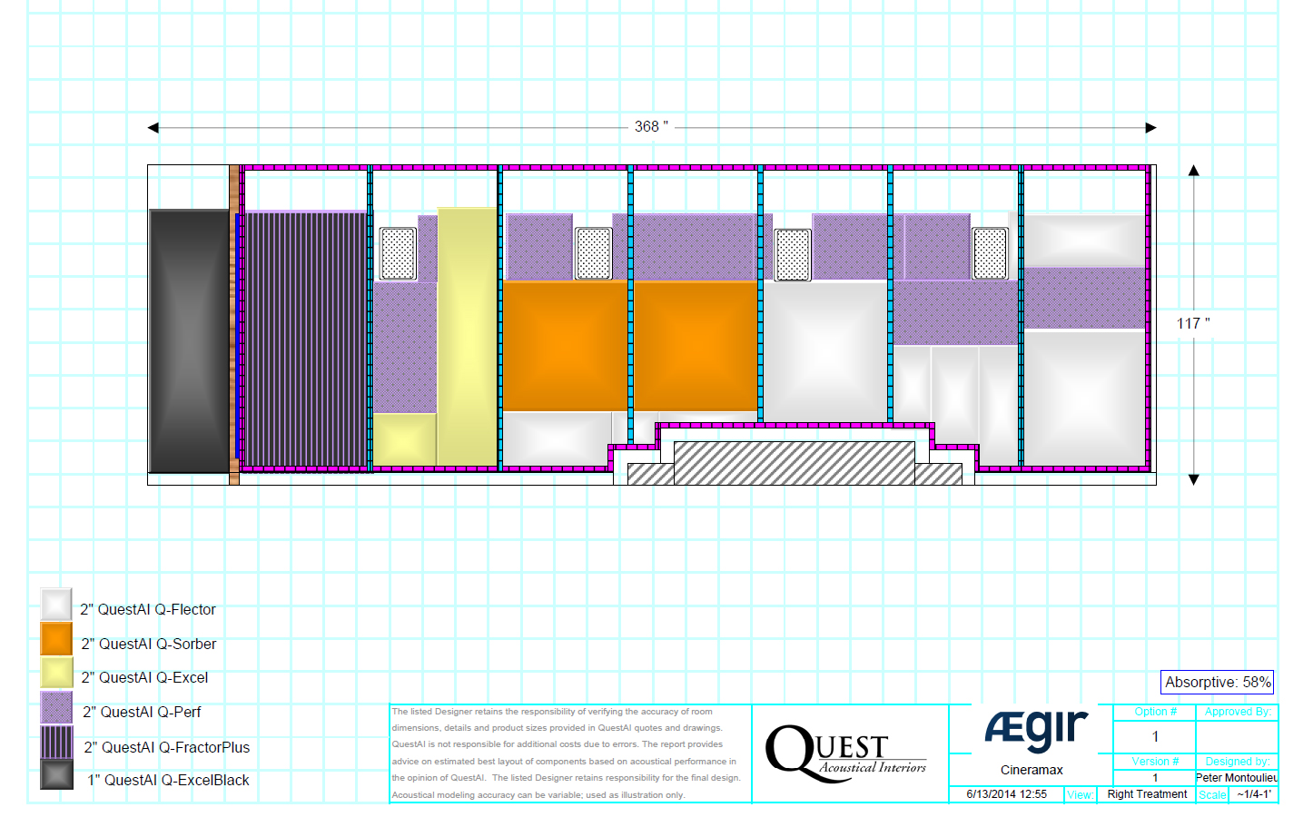

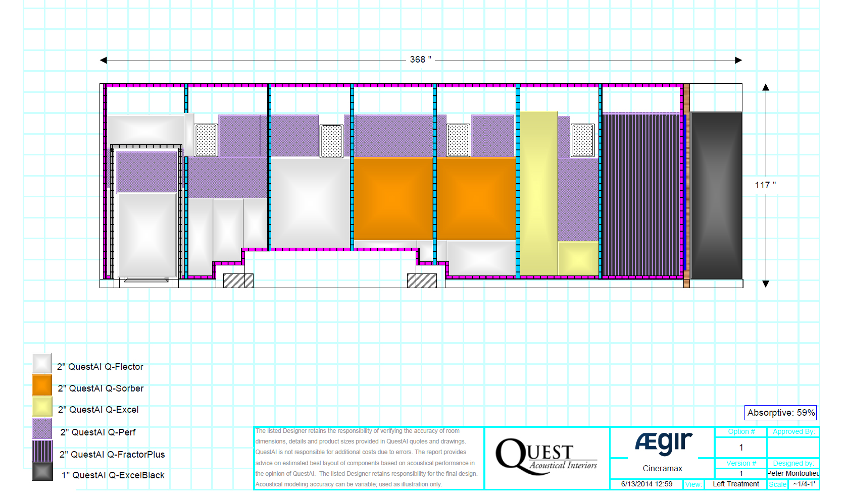

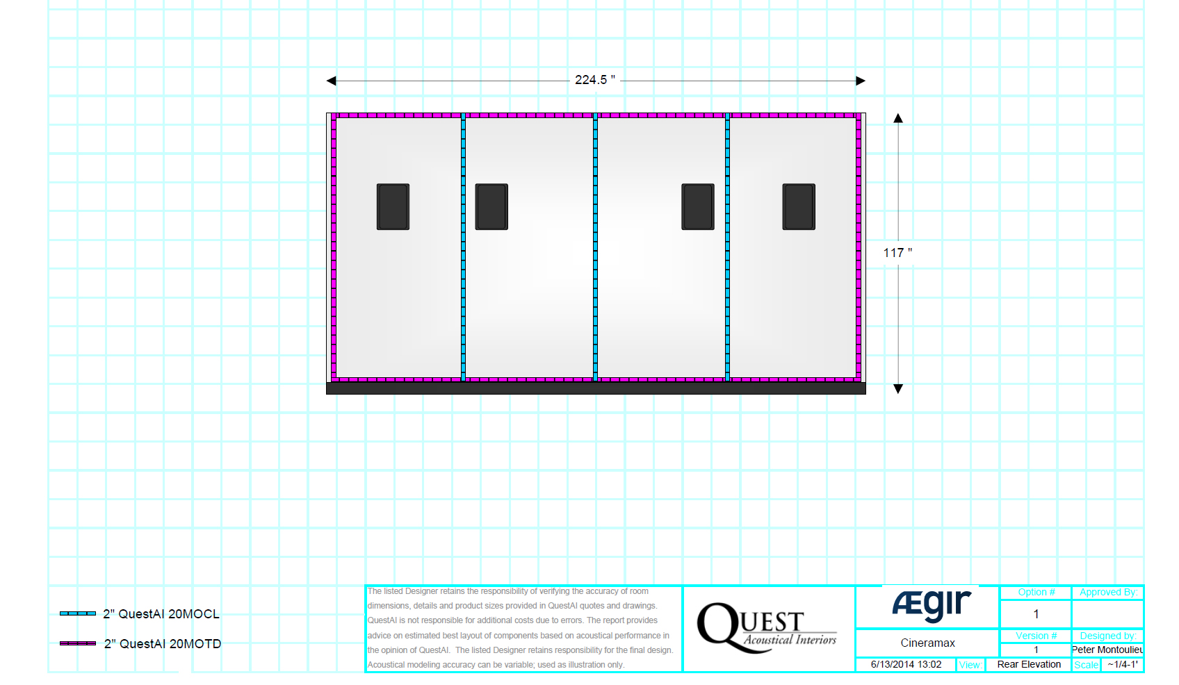

                        Of course to save 50 grand on acoustics we are increasing side walls to 2 inches from 1. My Bim man is going to kill me tonight.

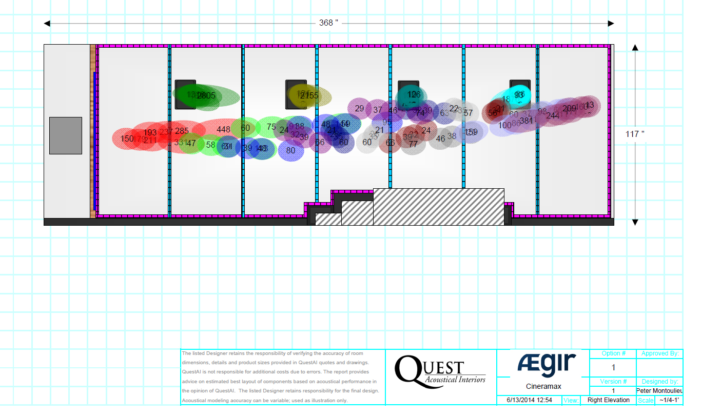

                            Thank you very much; we look forward to you contributing to this thread with actual job in progress pics . This latest design from Roger gives you 135 db over surround channels lt10s and 125db over the new little bi-amped AMT lti8as, Adss a little bit but not much to the existing budget.
                            The combined output is going to be a clean unrestrained easy on the ears 143db.

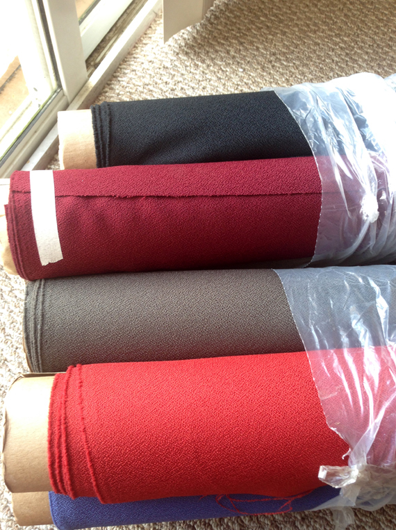

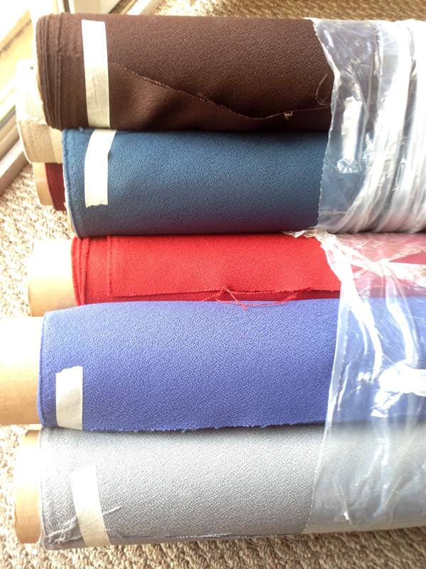

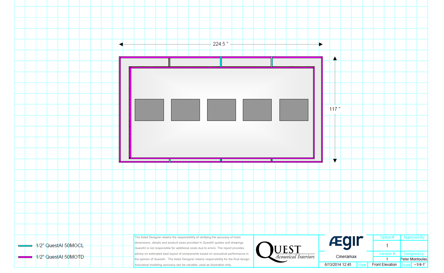

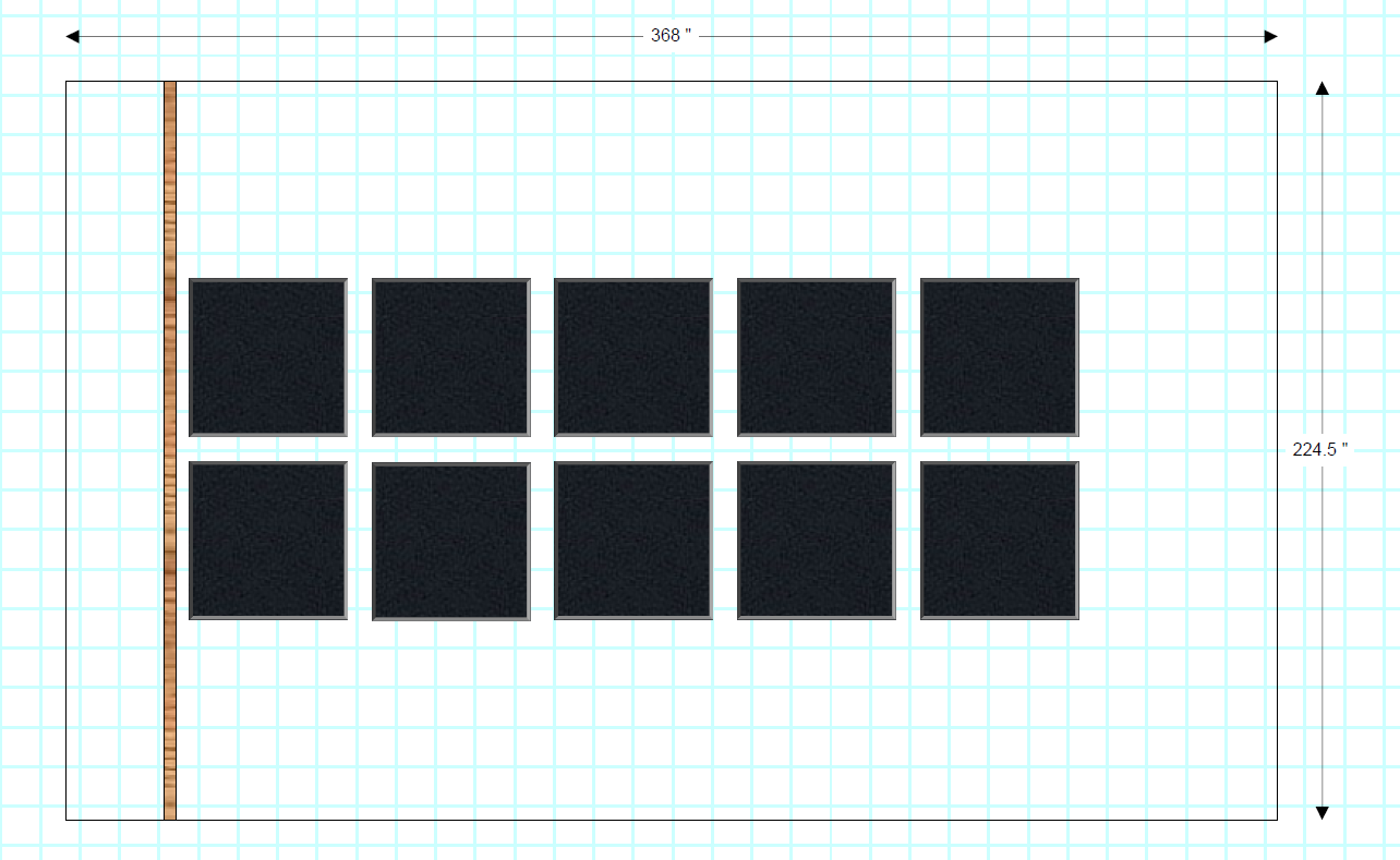

                              So I ordered fabrics for the Quest AI acoustics company, expecting 4 inch swatches and they sent a bunch of rolls next day. These guys are getting on my good side. Cinematech would have asked for a credit card.
                              And look at the sizes of the swatches that's a 4k 65 for reference.
                              With the exception of the ugly brown and the grey and the bright red I like the texture and colors of the lot.
