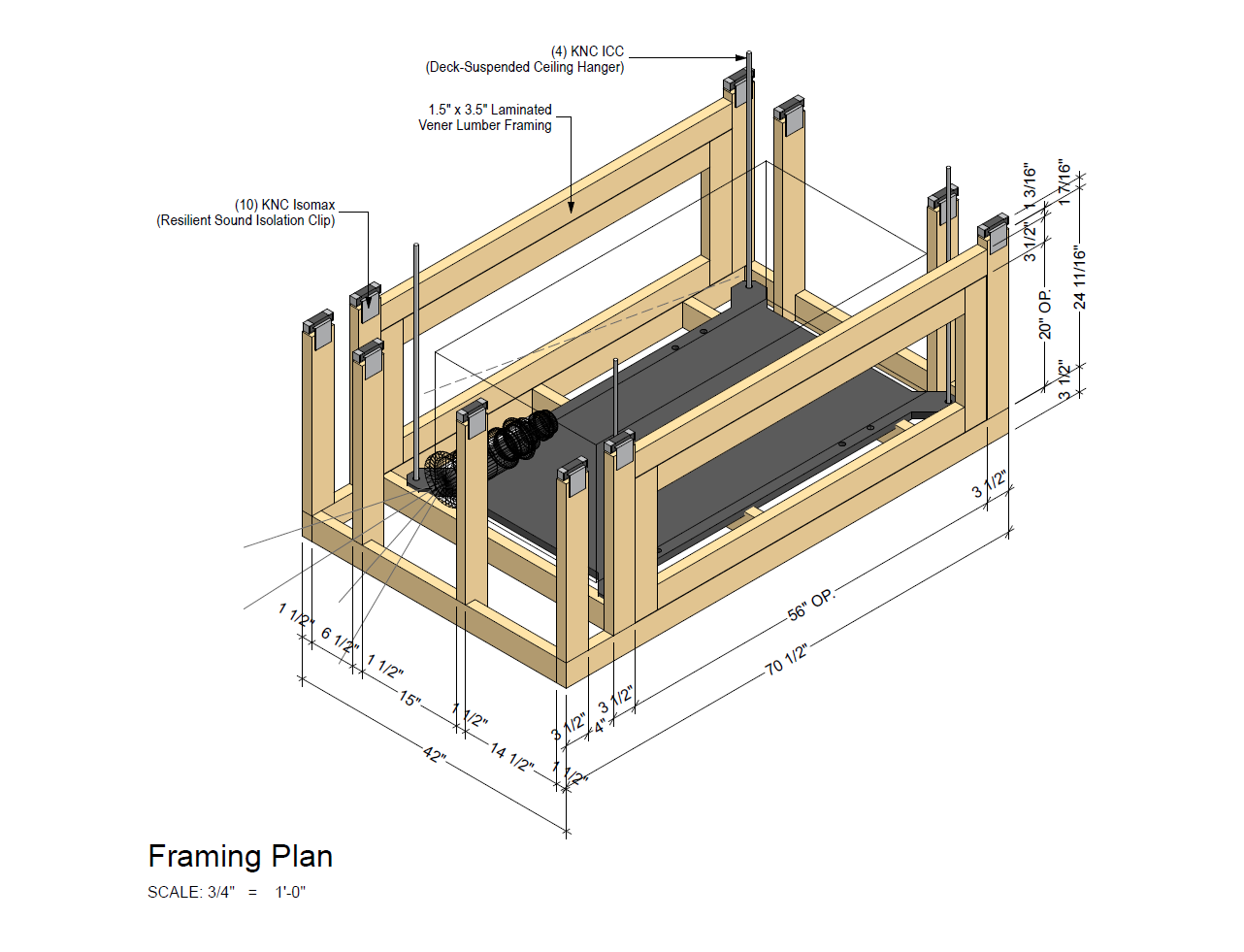

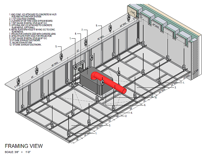

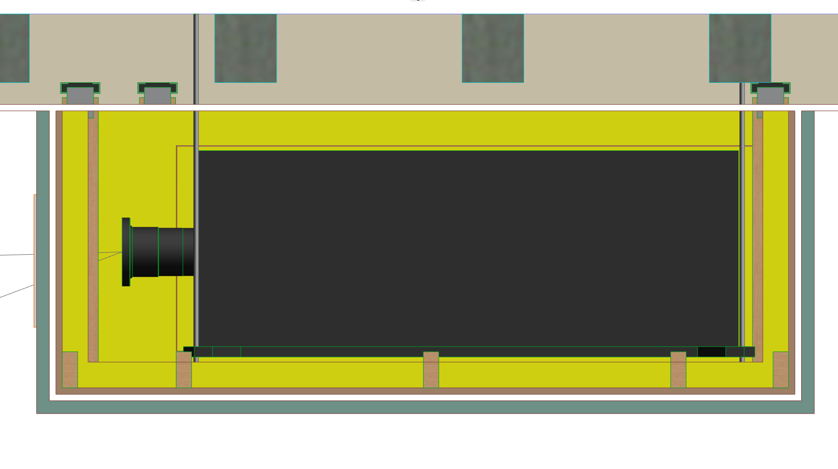

Here is where we are at for a Xenon Solaria Hush Box:
We are not only insulating but isolating. Next to check is the access clearance and porthole light-path alignment with screen, try to keep it tight and small for less sound emanation.

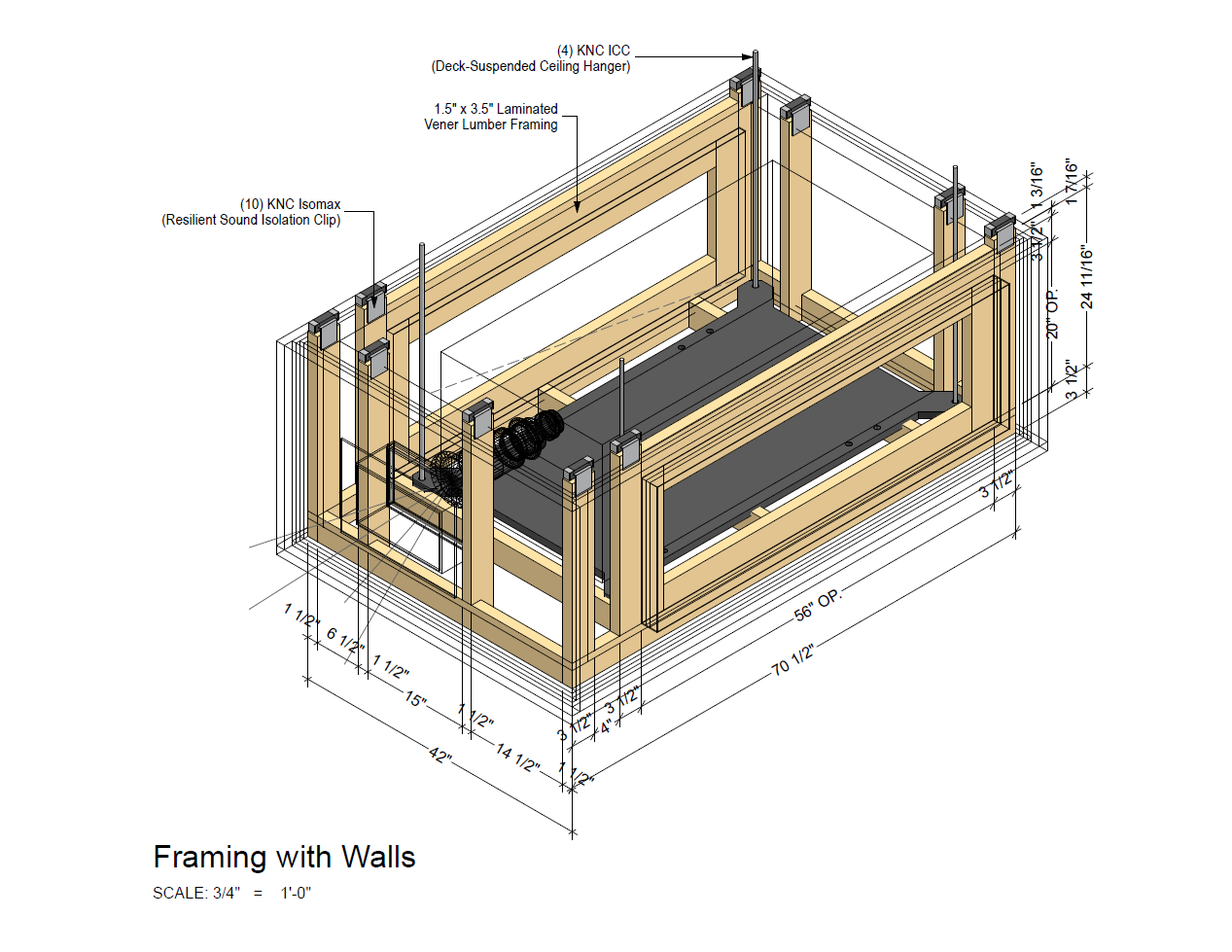

!Here is where we are at for a Xenon Solaria Hush Box:

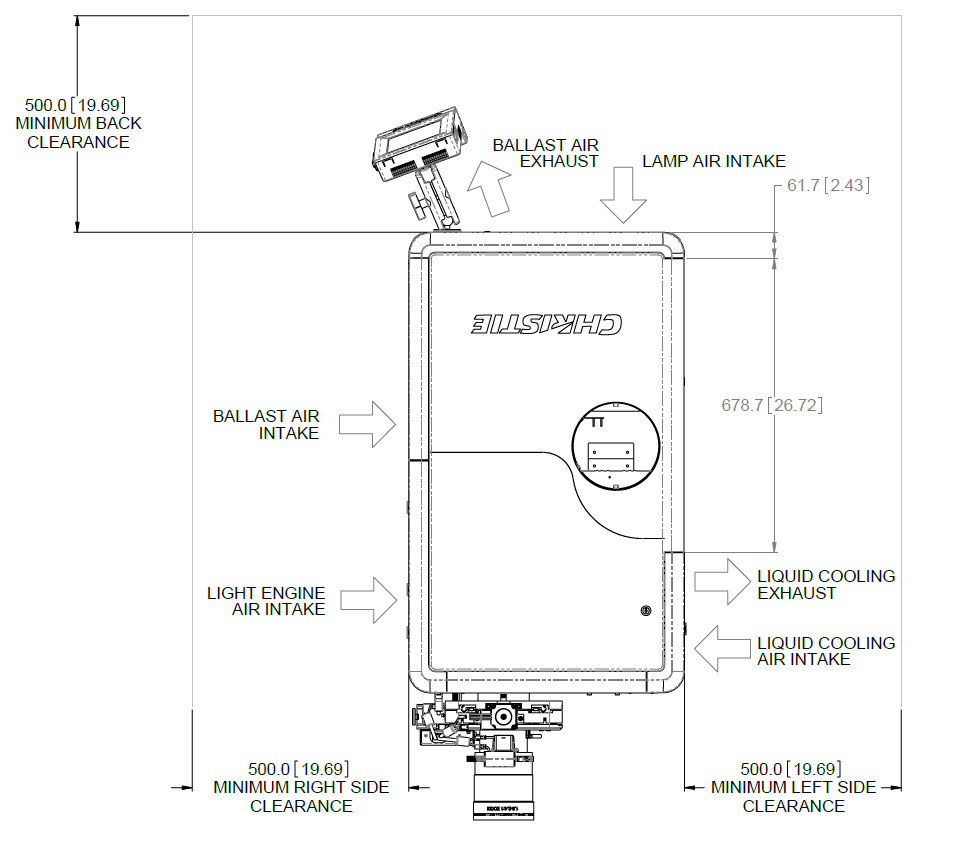

What has left us livid is how different these things ventilate as opposed to the Barco's which are 10 times more hush box friendly. I will reveal an entirely new effort using the world's greatest Christie hushbox expert's general advice and compromising a bit, but it appears we need a bigger box, and a bigger fan.
