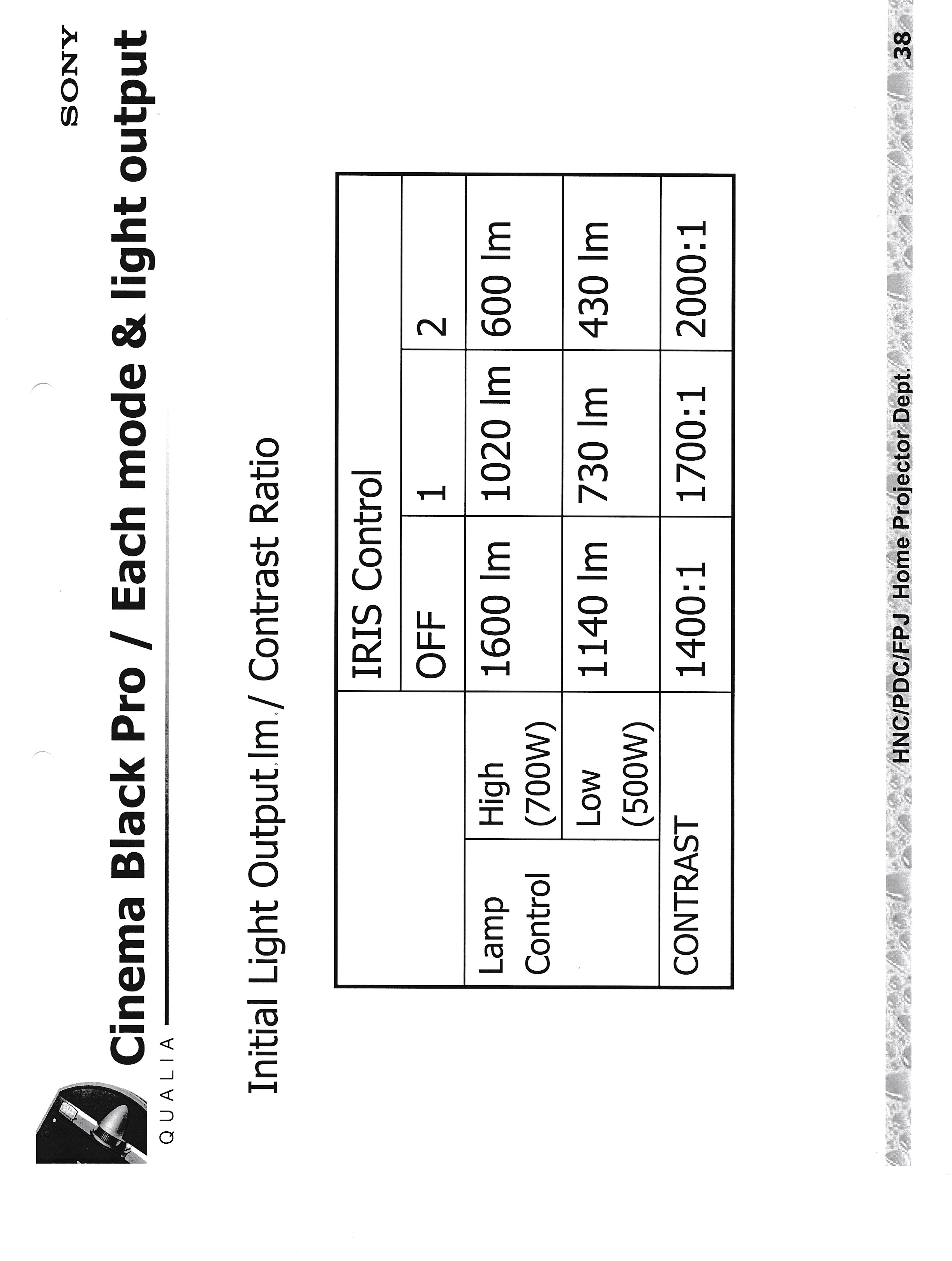

                              I was searching in a folder and I found this info about the Sony Quallia the world first Full HD LCOS Pr.
                              Native cr. the Qualia have was only 1.400:1 and with a huge light lost only 2.000:1.
                              Now the 815 4K LCOS Laser have native 10.000:1 at full light output!
