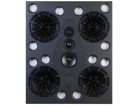

      So to answer IRJ972 querie, as per Roger. The sound quality of the z 16 and the z8 is IDENTICAL, the difference being more spl to accommodate front channel needs or a larger space.
      • #18
        Thats really interesting, so if the Z8 and Z16 have the same quality but theres additional SPL available with the Z16, how does the LT10 rank assuming it has higher SPL capabilities than the LT8/Z8?
        What I think would be really useful is a frequency, SPL, suggested amplification matrix to help potential customers evaluate the various options. Appreciate this collaboration and product range is new but the range is pretty overwhelming.
        Keeping this simple and not complicating it with wides and heights, for the LCR speakers in a reasonable 17 * 30ft room you could potentially go with any of these
        3* LT10 passive + AP-750 each
        3 * LT8 passive for smaller rooms + AP-750 each (or possibly 2 per bridged AP-300?)
        3 * Z8 (only active) so AP-750/AP-300
        3 * Z16 (active), same sound Q as Z8 but >SPL, AP-300 each
        maybe thinking of LCR separately isn't a good idea though and the front speaker array need to be considered a as a whole, ie WLCRW+HHH! Dman, thats a lot of speakers!

          Think of the Lt  series amt as 2014 models the z the 2015, then my coaxial that shall be the 2016.
          Forget about lt-10 and lt-20 because the z series is more nuanced, closer to the custom studio monitors when sitting nearfield but operating at mid-far...
          Both Guy and Roger are enthusiastically saying to go for the Z series even for the mother of all atmos soundstages (which is not that large but has 35 speakers in 28 channels). At first impression I said "these Albions are trying to sell me more amps".
          Speaking to Roger he has genuine enthusiasm for having tamed what i called the samurai sword air-cutting "swoosh" molecular-blast of the uncalibrated un broken in lt-20's and lt-10's. They can be made to sound great with calibration, but for Roger these things need to sound perfect out of the box uncalibrated.
          I agree, after fixing dozens of horn-based or poorly designed dome based systems, it is the logical thought.
          So it's February 2015 and lets leave the Lt series AMT in the category of strictly for sport arena PA sound reinforcement; henceforth ok? Let's focus on the upgrade options.
          The Lt-8 I proclaimed was the best surround sound speaker I had heard in 2013, and for surround I am comfortable for surround positions near the MLP and only when speakers must be inside the walls covered with fabric. And they only work at a certain height and upside down, there is a small hole in a few hundred midbass  frequencies created by the crossover, curt measured, and the hole tilts down, so reverse the speaker an voila. As i said the best in wall surround speaker i had ever heard. The LT-24 whoever has no crossover limitations but it does have dispersion limitations when used horizontally, stack em however like in TRITON 1st Heights and they rock.
          So am thinking 5 z8 and 3 lt-24 stacks behind screen for 1st heights, Dolby accepts vertical d'appolitos for surround if aimed from wall positions, so you could say I favour the lt-24 vertical as in Triton surrounds  (hope to have a few pics soon), NOW that after unloading on Roger that" he was stubbornner than Churchill" (which there is a familiarity there), 4 weeks later he acquiesces to prepare the lt-24 for U mount, what he had referred to as "flimsy toilet paper holders.... " .
          So for surrounds I prefer the lt-24 vertical ....like in Triton because they are aimable better than the lt-8 which are for in-wall stealth installs. Capiche?
          So how about the z 16?
          I am sure it's going to be the sensation at ISE but when you are getting into this kind of coin I may want to explore the Europa concentric conceptual the z112 (seriously-after the 45 minute meeting with the atmos brass they described this as the utopic solution (PREMIER NIRVANA TRADEMARK )for behind the screen  mains). And Q can build it.
          The zeilings seem like a great solution for the immediate mlp while the lt-24's can act as ceilings depending on kill zone, and angles, but certainly can be used for remaining 8 ceiling positions for a small kill zone TRITON, and on wider kill zones for the rear wall ceiling junction 45 degree last height pair.
