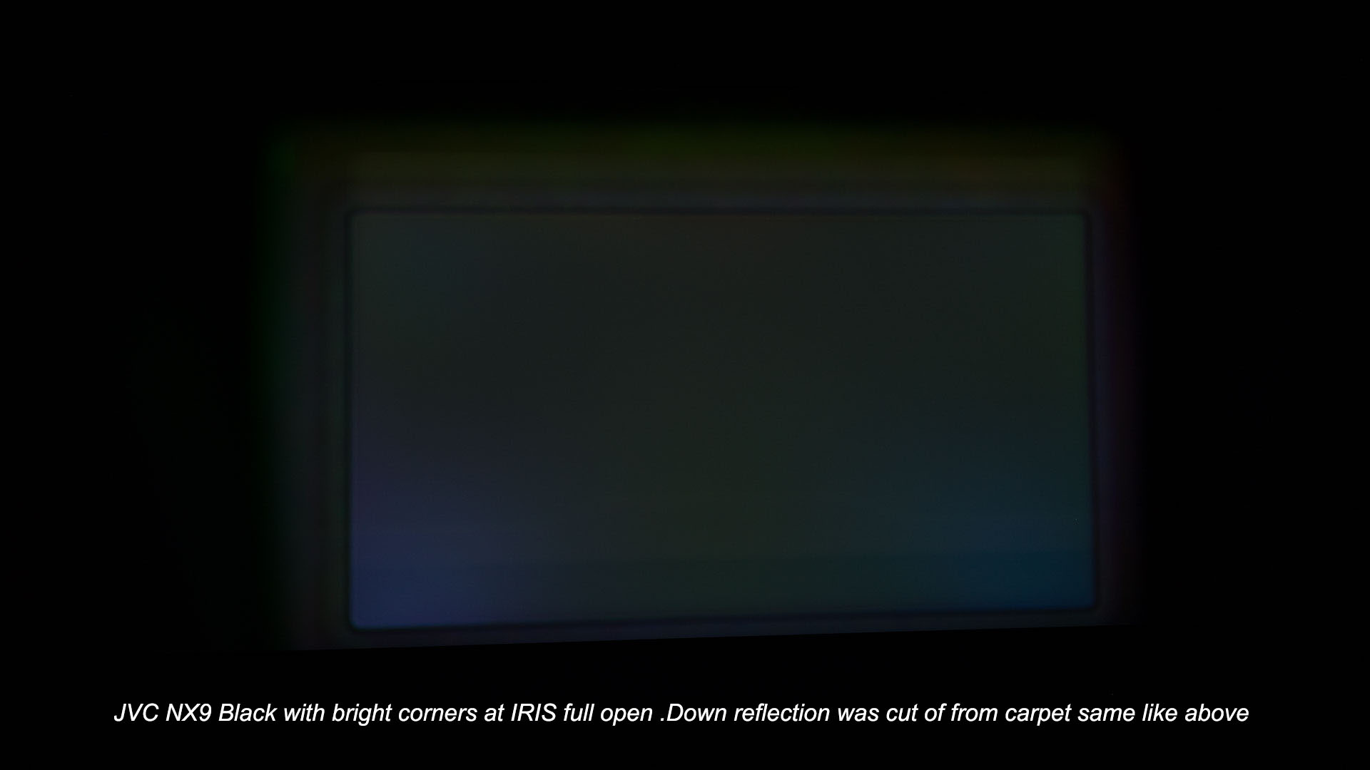

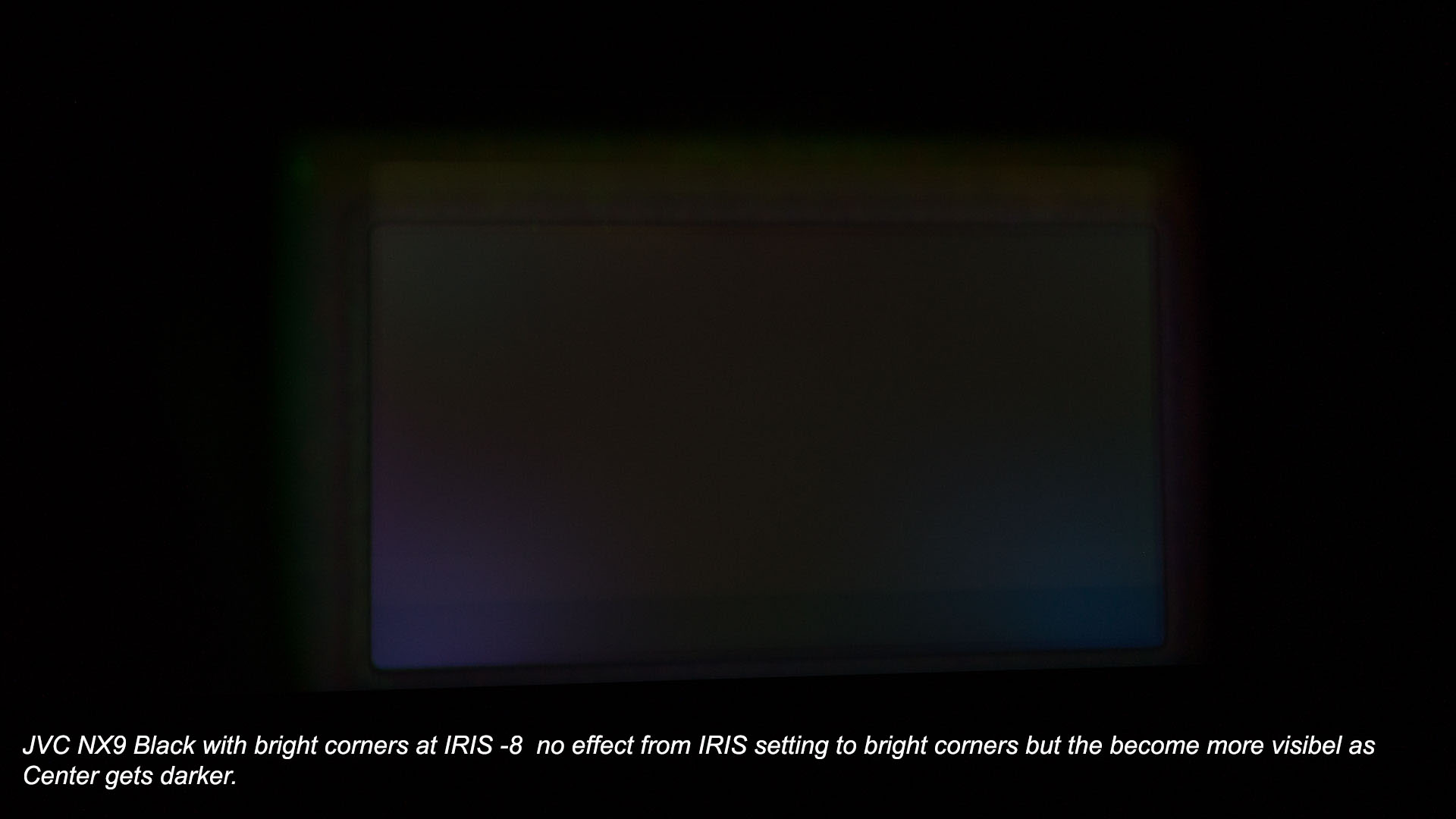

Negative was the bright corners that was visible at iris max. open and increased visible when you select for sample -8 with the iris.
Then it looks like the corners will be no change in brightness but center of the picture gets dimmer.
See also the picture that show this bug with iris position -8 and no iris.
Please note that under normally viewing condition you do not see it this way ( I use long exposer time to show it) but you can see bright corners in a dark room if you look for it.
