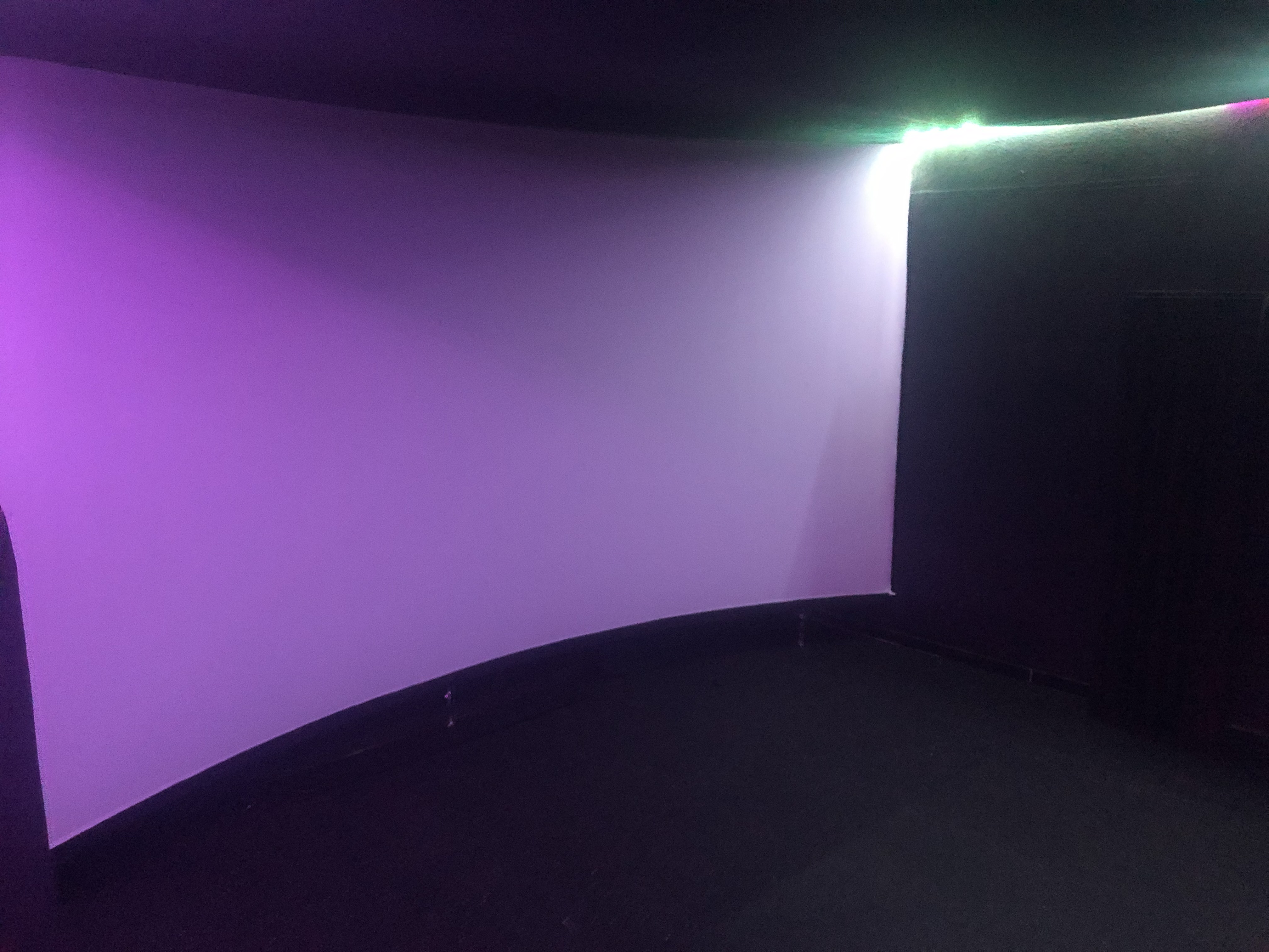

Ok poor man HDR.... understand.

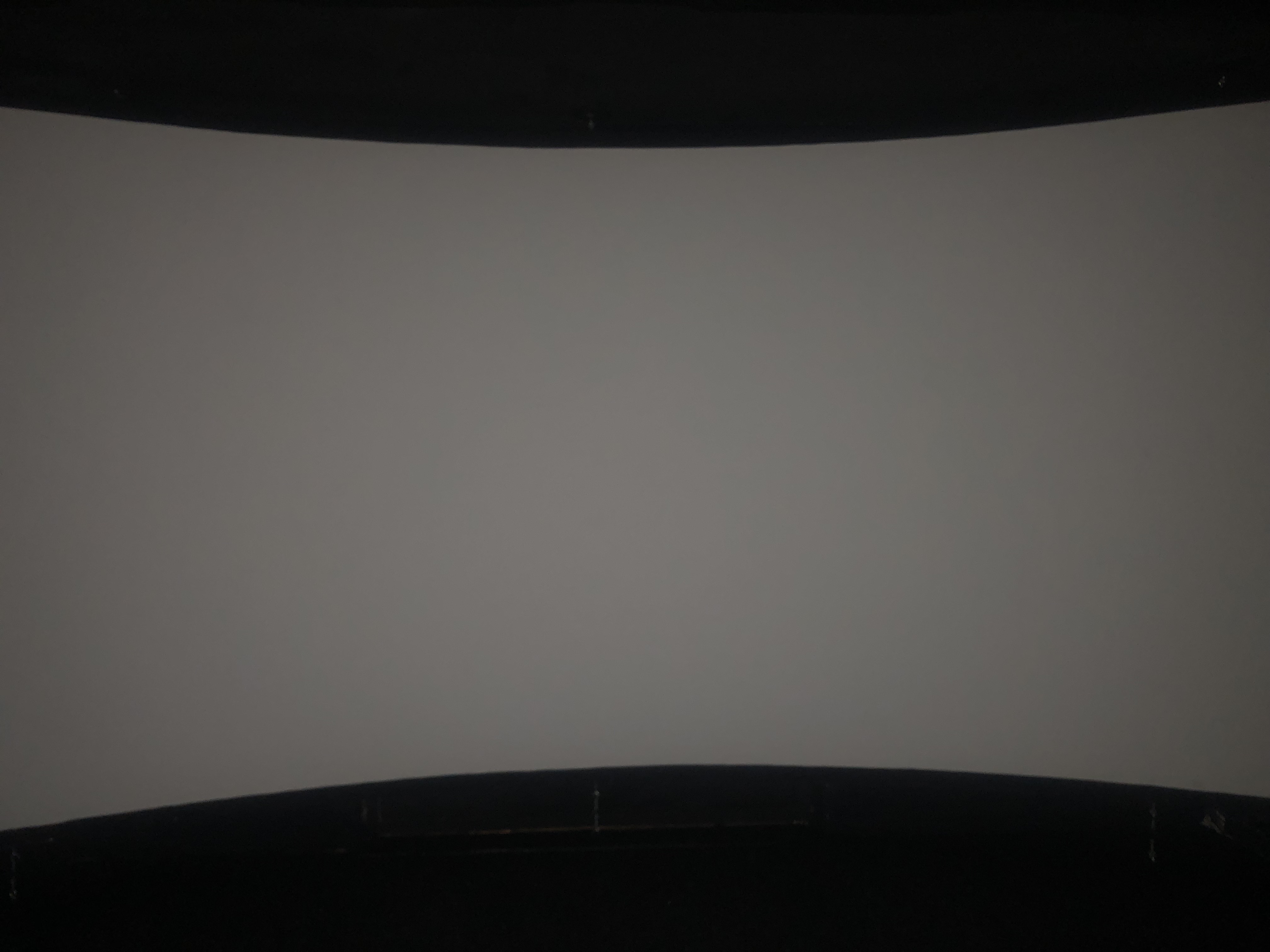

Thanks for sharing the pictures.
Nice screen!
Do you not have any problem with focus as the screen is strong curved?
When my Barco get the new lens with the fix iris inside to gain cr. I was shocked how much the picture was focused when I put a paper about 60cm in front of my screen.
There is not any sharpness decrease visible as this iris act like a you going with a picture camera lens from F2.8 to F8.
This will enlarge the field deep off a lot same in this projection lenses.
So I think the curve don’t hurt your sharpness performance in your setup or?
I have in my holiday house a 137” wide screen and think about to try there in future also a curved screen also with the V6 screen material.
thank you Wolfgang,
No I was surprised by my self then I gain the curve by changing the fabric from Seymore XL to V6, that I have no problems with the general sharpness, or different sharp areas in the screen.
I think the very short throw distance 4m to a 3,76m wide image is positive fact for that.
The position of the vw 1100 is nearly middle of screen, because I will reduce and minimalist the difference of picture between the center and down corners left/right, wich is 3" now.
I waiting for a long time for the upcoming 2160p Geobox Warping in my chain, to calibrate the exact bow, now they Company in Thaiwan hope to get in 2019 Quarter 2!
I will keep you updated for you 137" curved screen Wolfgang.
@Mr Pixel Alan ?
Based by the construction of Nils Ă–llerer , I mentioned earlier in this thread, the screen is not totally going from Bottom to the top...Picture start 4,5" from the celling and ended 12-13" to the floor.
I know the curve is a little sick, but I really like the old Cinemascope Classics and since I saw Cinerama LIVE at the BFI Bradford I will have "Something" like that home
