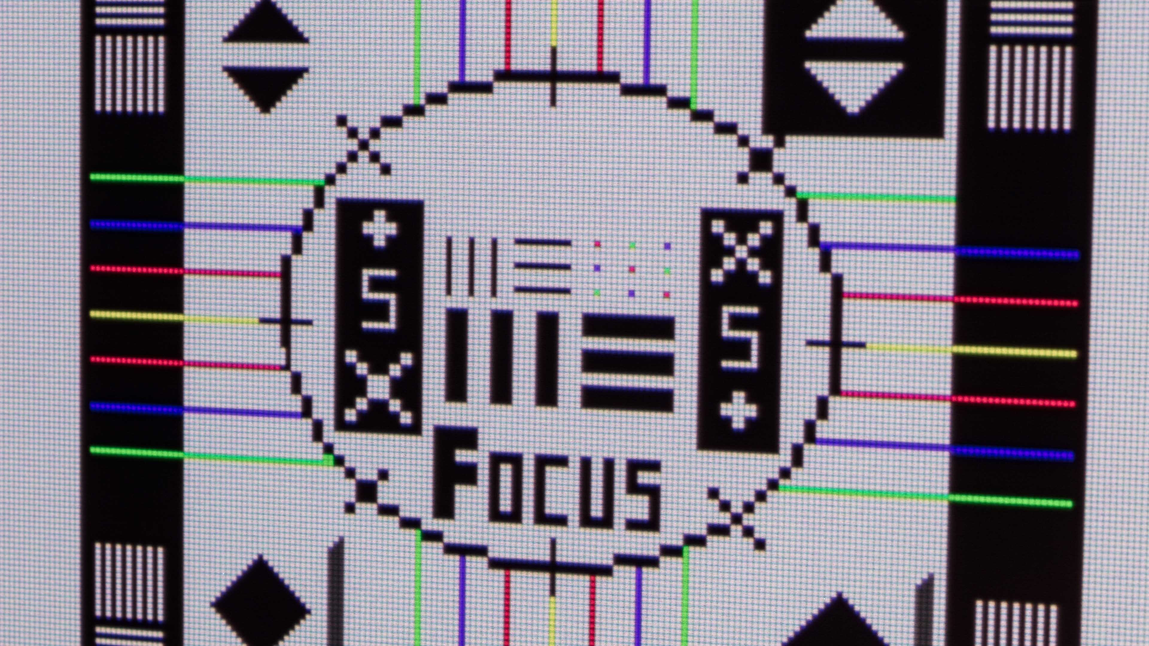

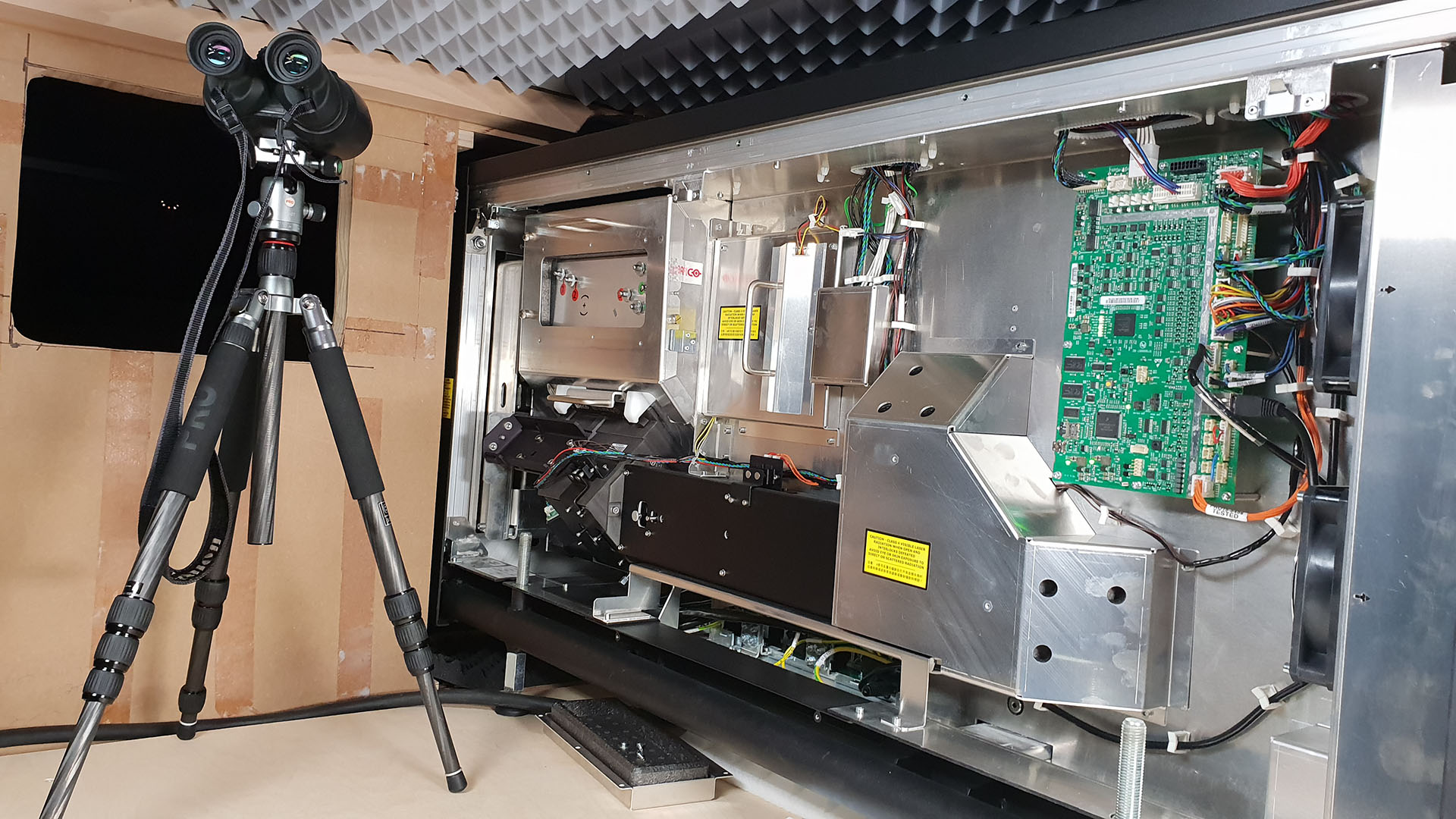

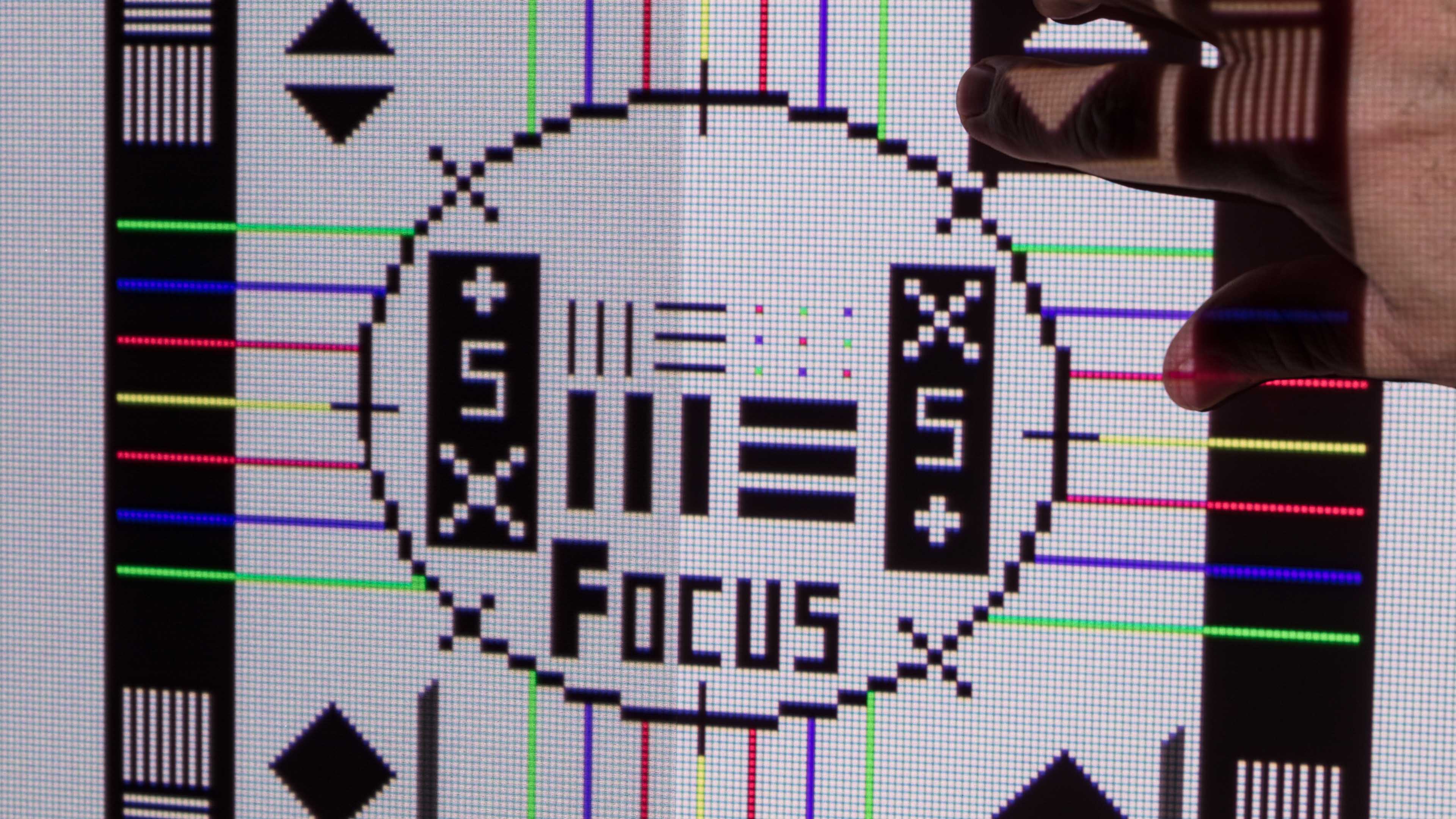

  • Today I did number one on my "to do list" with the Barco and adjust the convergence.
    I not do it almost since it was setup long time ago.
    I always thing about it but it get delayed as I think it makes no sense to do it  before I change the screen.

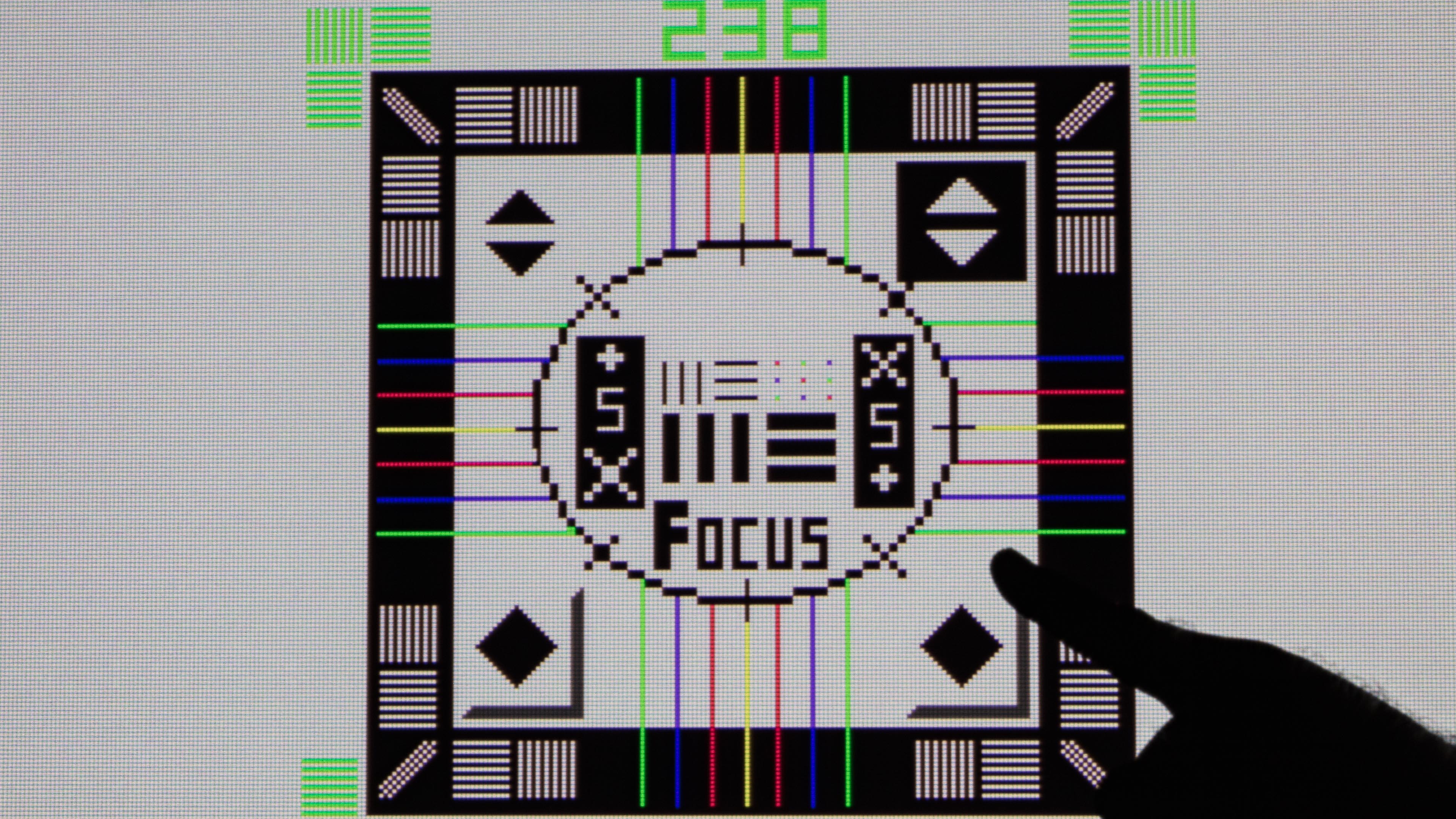

    As you can see in the first picture blue was out by almost one pixel red was also not perfect.

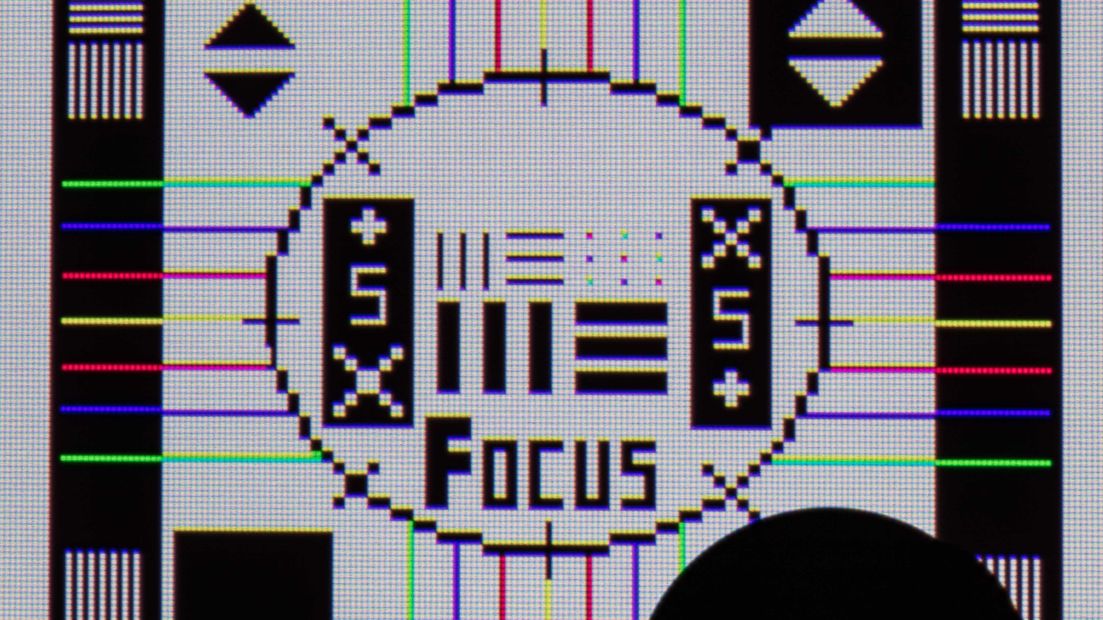

    Second picture shows the same area after my adjustments that takes just about 15 min.

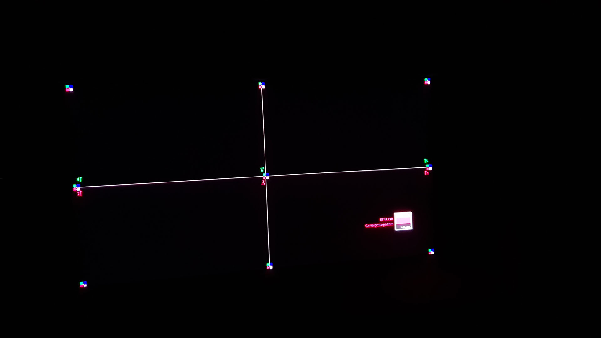

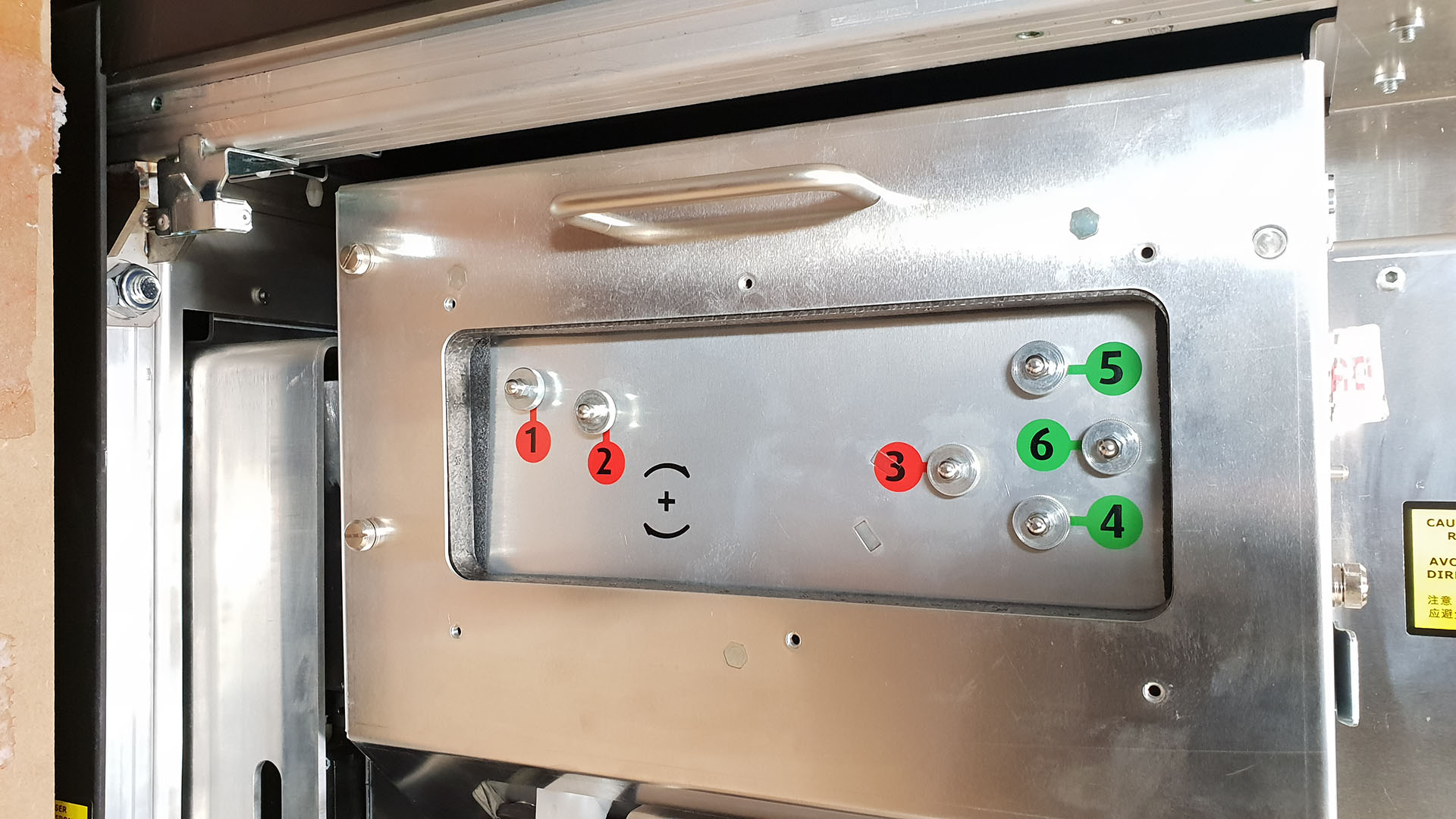

    You can see how Barco have this easy to operate mechanical convergence adjustment.
    Just about 6 knobs shift red and green (blue is reference) it to near 100% perfect convergence see pictures down.
    A test picture on the screen show you what knobs you have to turn in what direction.
    Sorry this was made via my mobile so not the quality you normally see from me.
    In one picture you can see left side the V6 screen and right side a white paper I put as a reference inside.
    • Big improvement. RGB alignment is very important and harder to achieve with 4k, good work.
      • I am glad to report that I can do it even slightly better see this picture!
        Now it was perfect.
        All the test pictures I have displayed at 6.8 meter wide wearing my special glasses that my eye doctor especially did for me to see in the my home cinema every detail. He told me that he never ever do so much work for such a glass in his live  . Viewing distance was only 3.4 meter so 0,5 times the screen wide!
        I cannot detect and see from this much much to short viewing distance to view movies anything.
        To see it you have to open the full resolution 4K picture by click on it and dont forget this picture is a screenshot from a fabric V6 screen!

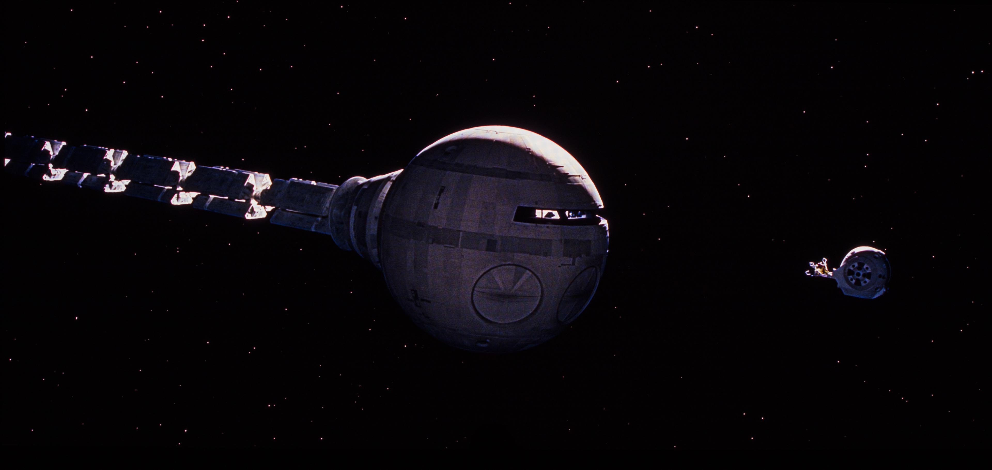

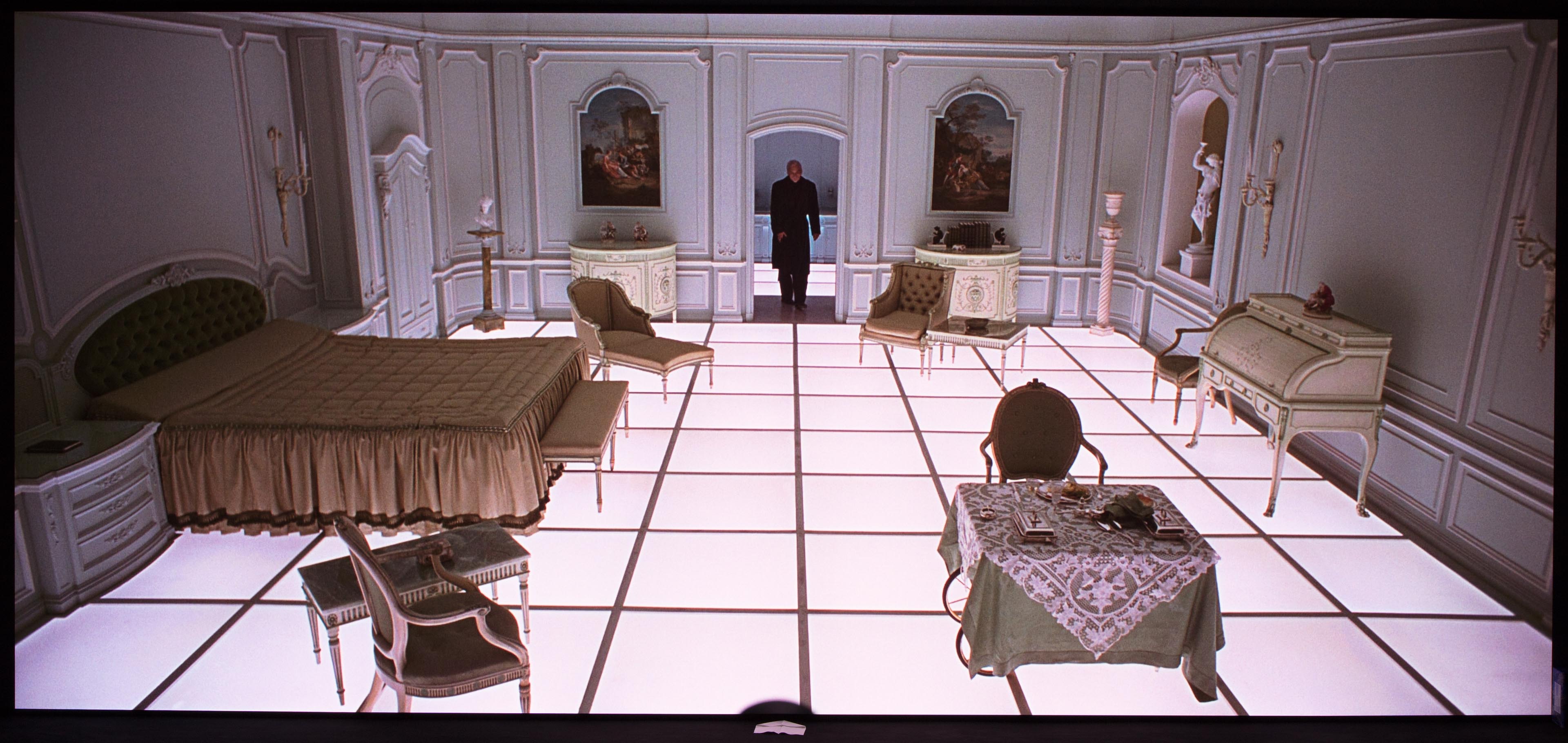

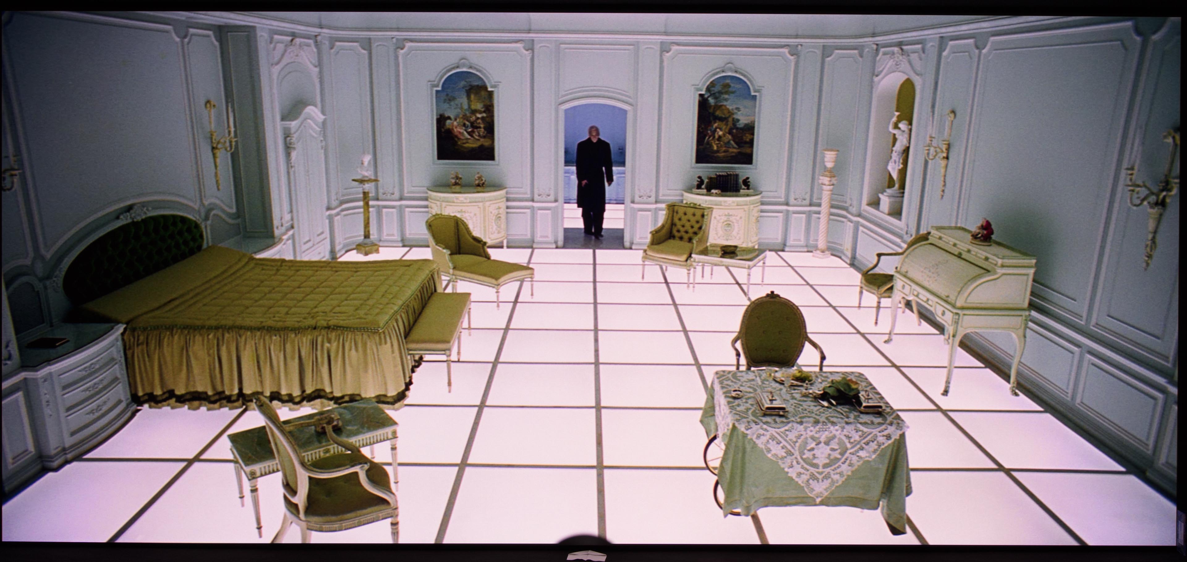

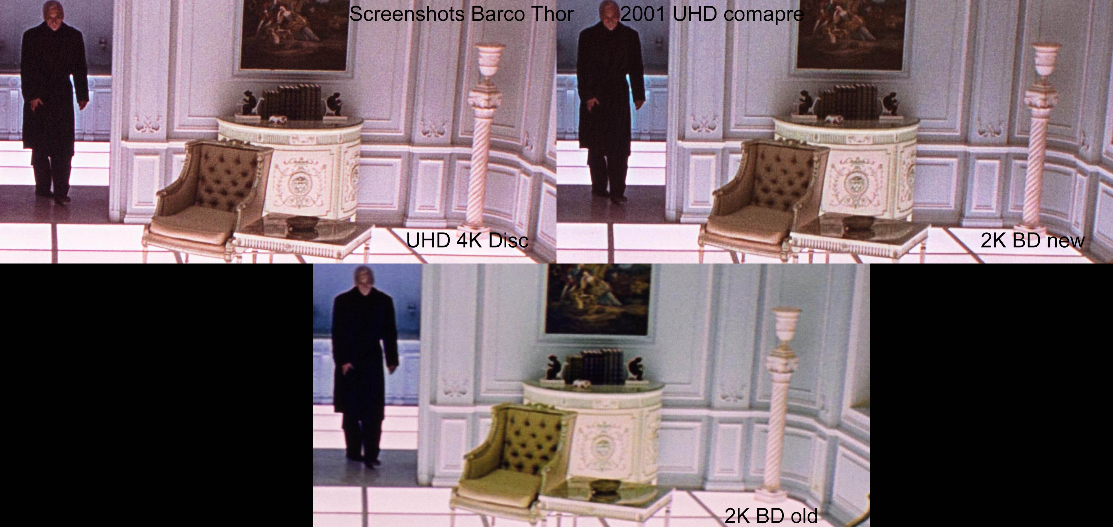

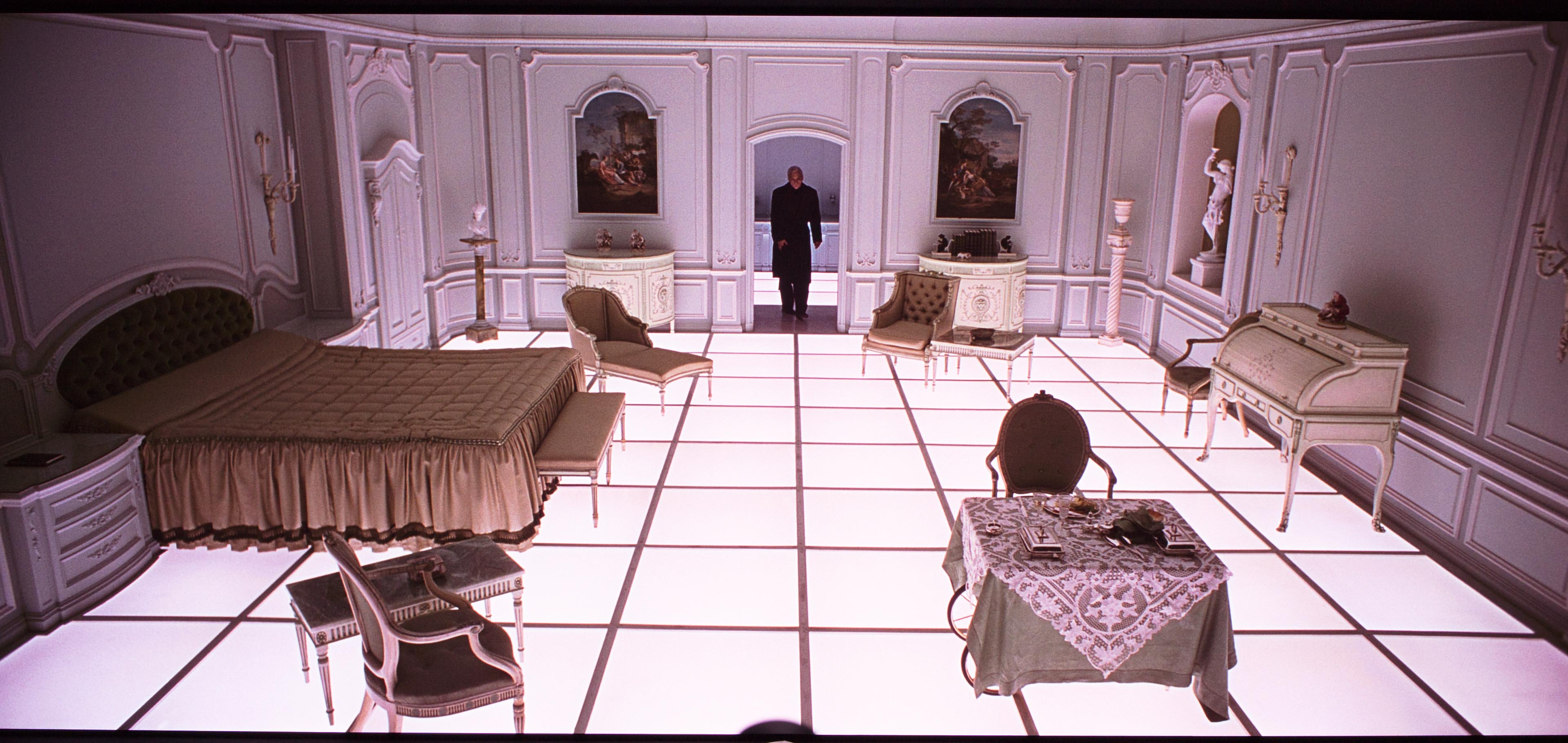

        • I got today the UHD Disc from 2001 and did some screenshots.
          First the UHD Version looks better than I think after hearing some negative reports.
          The old BD do not look this good.
          The new BD looks almost as good as the UHD Version very hard to tell what is what so the biggest difference is between the old BD to the new BD.
          But UHD Disc even if it show very little improvement in resolution compare to the new BD version show better color and HDR that I like a lot especially in some space sequences.
          Warner and Christopher Nolan did a good job and thanks to Warner we can now look 2001 in a quality that may some 70mm do not have.
          I watch 2001 in 70mm at least 6 times in my live but I cannot remember I see it in this good picture quality.
          Also we must say thank you to Warner for not downgrade the new BD Version to made look the UHD even better.
          See this following pictures in the full resolution.
          This are real screenshots made with the Barco Thor.

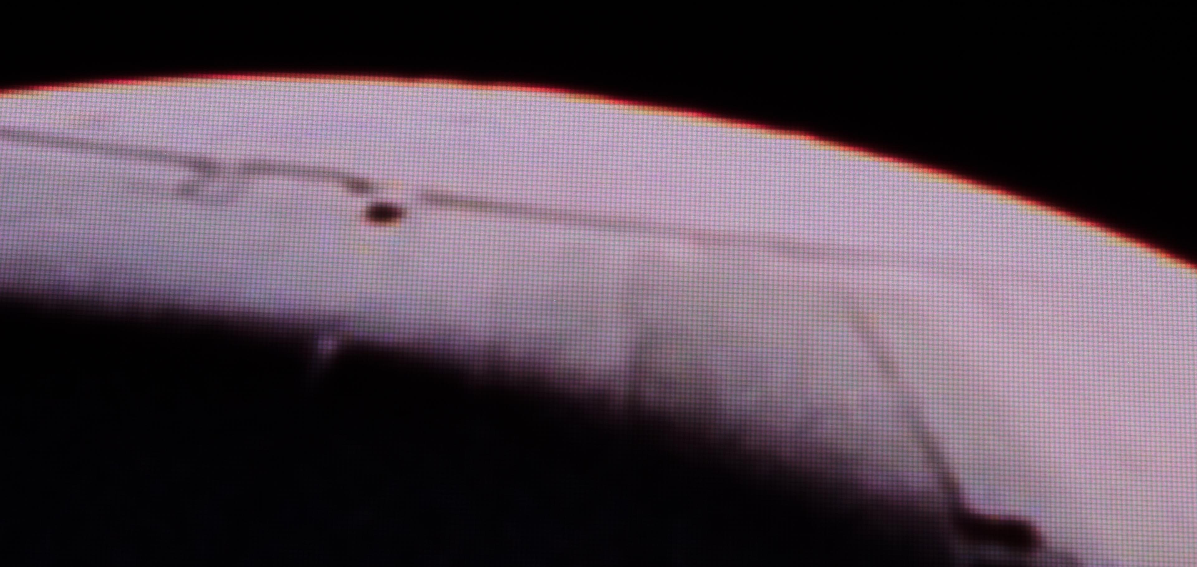

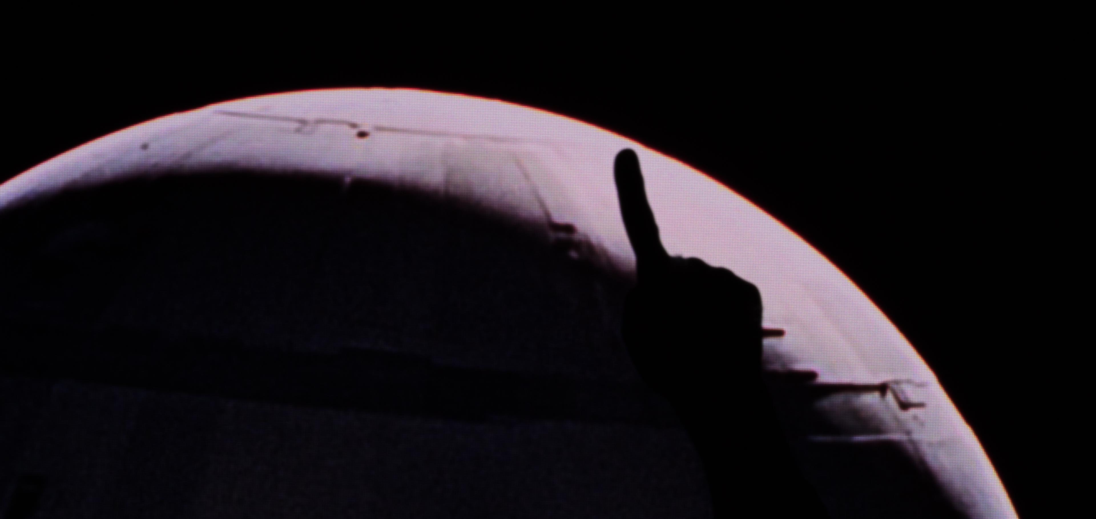

          Please see further down also some strange issue that some of the sequences had a red corner that looks like a convergence bug from the Projector.
          So first thing I think was WOW my convergence is out again but I see that my test pictures show a very good convergence see my last post with the picture inside.
          Later if found some more sequences that show this but also.
          So it is in the source material not coming from the projector.
          Strang that I never hear about it looks like no one saw it before.

          • Here one 400% compare picture.

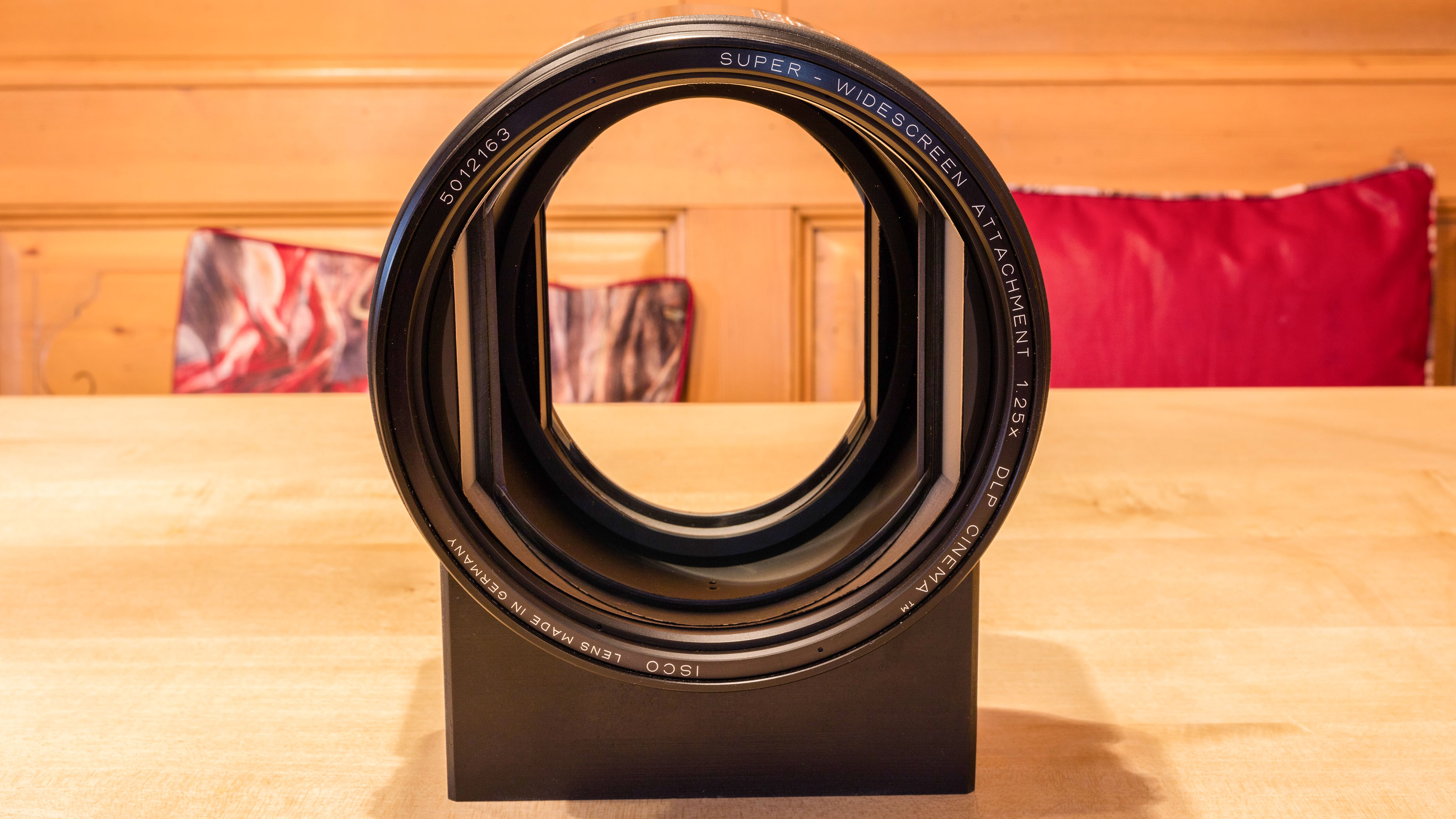

                        • I did something today with my Barco Thor I think about long time but never try it.
                          I use my Isco Anamorphic Lens 1.25 so far only for 3D Blue Rays as there I had for my taste not a so bright Image after the cr. improve that kills about 45% lumen that I use this lens to gain about 25% lumen.
                          The result was nice it increase visible the brightness and I cannot see any decrease in picture quality at all with a 3D BDs.
                          I never did this with HDR 4K UHD Disc so far as I think the Barco Thor cannot scale up the picture vertically by 25% with 4K HDR Content but I was wrong the Barco Thor can do it.
                          So I find out how do to it and how to adjust all the files that are creating this picture : Lens File-PCF File-Screen File.
                          I was very surprised to see how good this picture was with the Isco Anamorphic Lens 1.25.
                          I have expected a little bit less picture quality but reality was I cannot found beside some distortion that I can blank via electronic blanking and lens setting to get a full flat picture any parameter that looks with the Isco Anamorphic Lens 1.25 less good.
                          I use the best UHD Disc for this test Dunkirk and Lucy but picture looks even better with the extra lumen.
                          Without the Isco 1.25 I have about 33 FTL with full laser power now I have good 44 FTL at full laser power.
                          Most about 24% increase comes from the Anamorphic Lens and some % comes from the bigger picture as I not use 3840 pixels I use now more pixels.
                          Most professional high end lens are had a fix F number so there is not any loss of lumen when you zoom to a smaller picture.
                          Also nice was that I use almost the full chip and therefore I do not have any black bars anymore for 2.35 format movies that hit my roof and floor.
                          They are gone and this increase somehow the visibly cr. ratio.
                          Last not least with the Anamorphic Lens I can fill the whole screen so my picture was bigger.
                          I will use this only when I playback some really good content bad UHD or bad BDs I project a bit smaller without the Isco.
                          I am happy to see this kind of improvement with the Isco Anamorphic 1,25 Lens and it was a big surprise to see how good it looks.
                          I will do a slider that made it easy to slide this lens out and inside.
                          I need this for flat content but I think to do all the scope content with the Isco Anamorphic Lens 1.25 in future.
