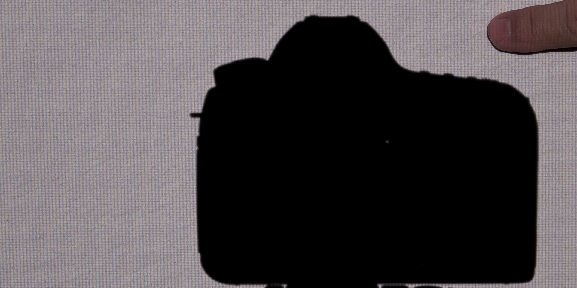

        • Some WOW news about the new XXL V6 screen.
          I have work on the screen the last few days and finish beside the masking everything.
          Now it has a perfect tension and not any visible wrinkles or other bugs.
          As I have to made new lens files as distance and size of the screen have changed.

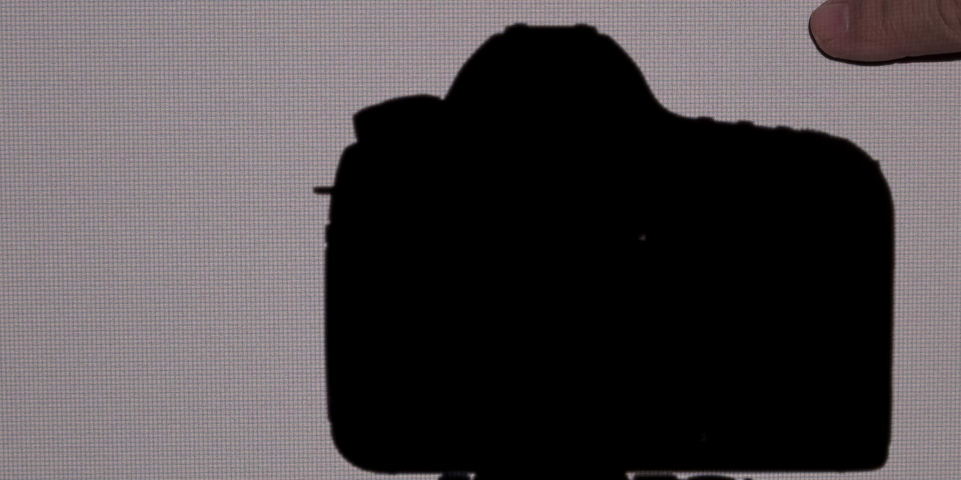

          So I working on this and to my big surprise I can focus very good to the screen that I easy can see
          the pixels and the pixel gabs from the 4K DLP see picture!
          I wonder as this was first time I can see with a fabric screen material pixels as sharp as a conventional screen without perforation!
          Strange was also that I do not remember that my older smaller V6 screen I had test long time ago show this pixels at all!
          As I still have some older V6 material I made a wood that contains the old and the new V6 material as you can see in one picture down the screen.
          So I test it and again surprise I can see with the old one also the pixels very clear.
          So this prove that I likely do not right focus when I have try the old V6 screen.
          This is very good news for many people that looking for a acoustic transparent screen material that “not soften the picture”.
          When you have a fabric screen that not  show the pixels this material soften the picture to some degree for sure.
          This V6 material was the first that not do it!
          It act like a conventional screen so it not decrease at all details and sharpness and not soften the picture.
          This is “to my knowledge” the first fabric that act this way!
          WOW!

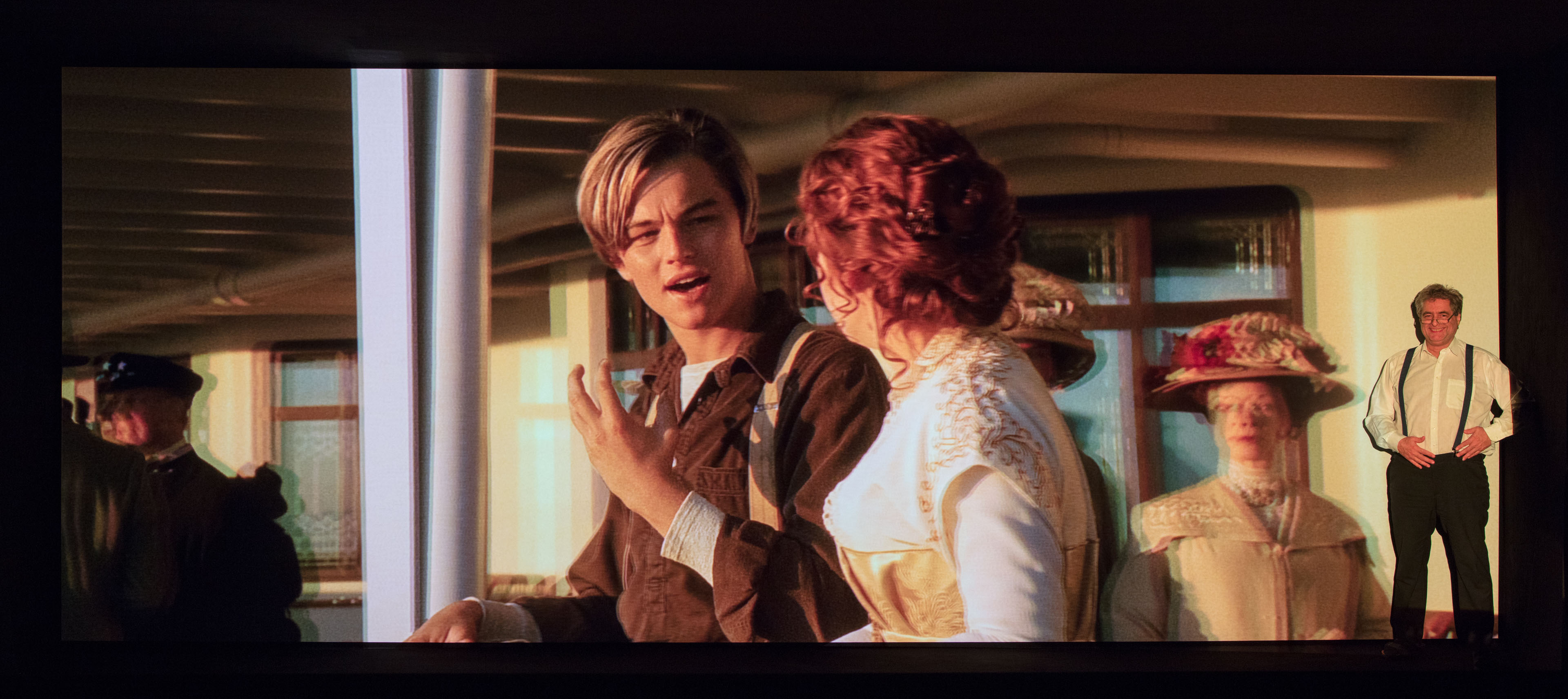

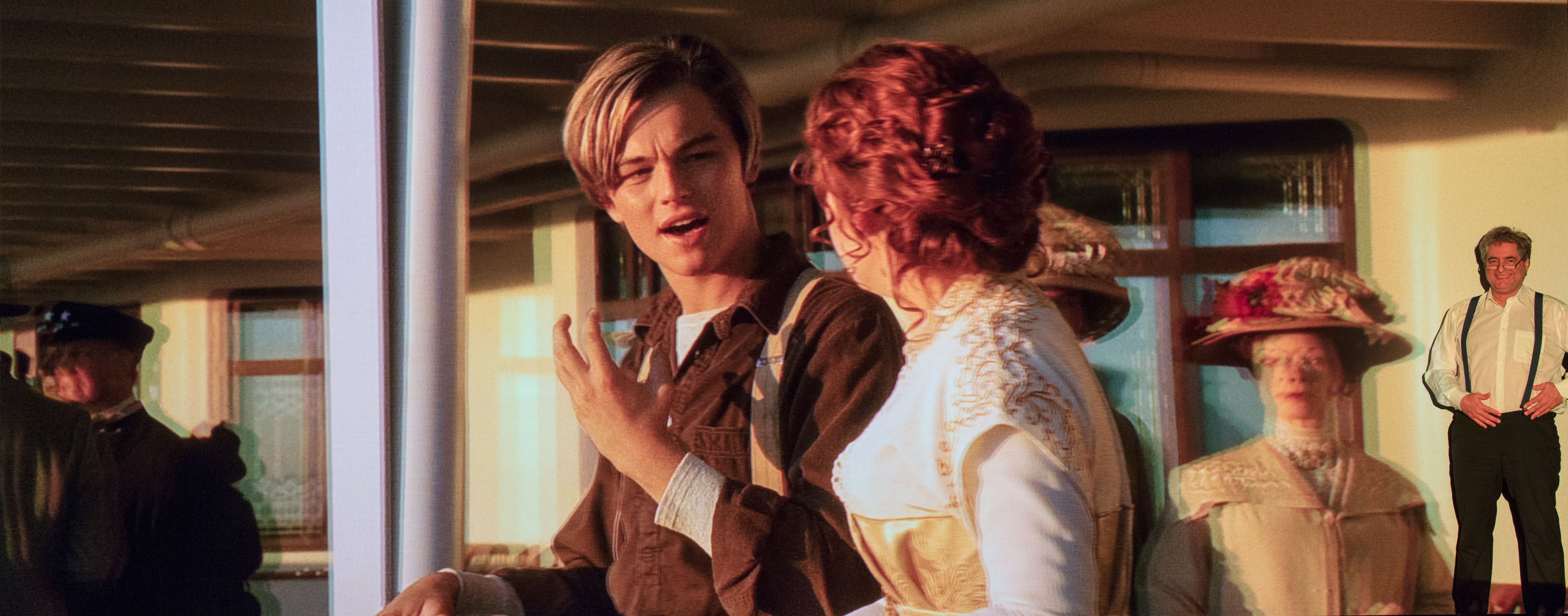

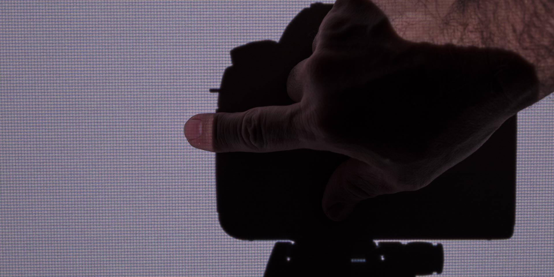

            • When you use a ISCO 1.25 the pixels are not square anymore so this picture was without the ISCO 1.25 anamorphic lens but hard to see the 25% difference.
              I did a screen shot only for posting here as there is so many discussion about this lens in the past from people had never try it and talk so much nonsense about it that I like to show this compare to the public. So I switch the Barco Thor on and did this pictures.
              One picture show the Barco Thor optic with the Isco 1.25 anamorphic lens the other picture without the anamorphic lens.
              Take a look at this picture and compare both.
              You will easy see how good this ISCO 1.25 lens is as it show the pixels more or less in the same quality than without it!
              I give people that doubt what I say since many years the tip to do this compare with any other Anamorphic lens in the market and see for yourself.
              I say since many years that the “by far best anamorphic optic money can buy” is the ISCO 1.25 and different to other lenses you can not see any decrease in picture quality beside some distortions that are there no questions.
              I say as a joke some times that the ISCO 1.25 anamorphic lens has in the corners a better picture that most other anamorphic lenses in the center and this is not a joke it is true.
              But as always you need to understand the lens and much other things to get a good result.
              For sample how to use the focus on the lens , how to place it in front of the pr. lens and how to focus the pr. lens ,how or if at what direction you tilt it and so on.....
              BTW you need to go to the full resolution picture the preview is not good idea to rate it!

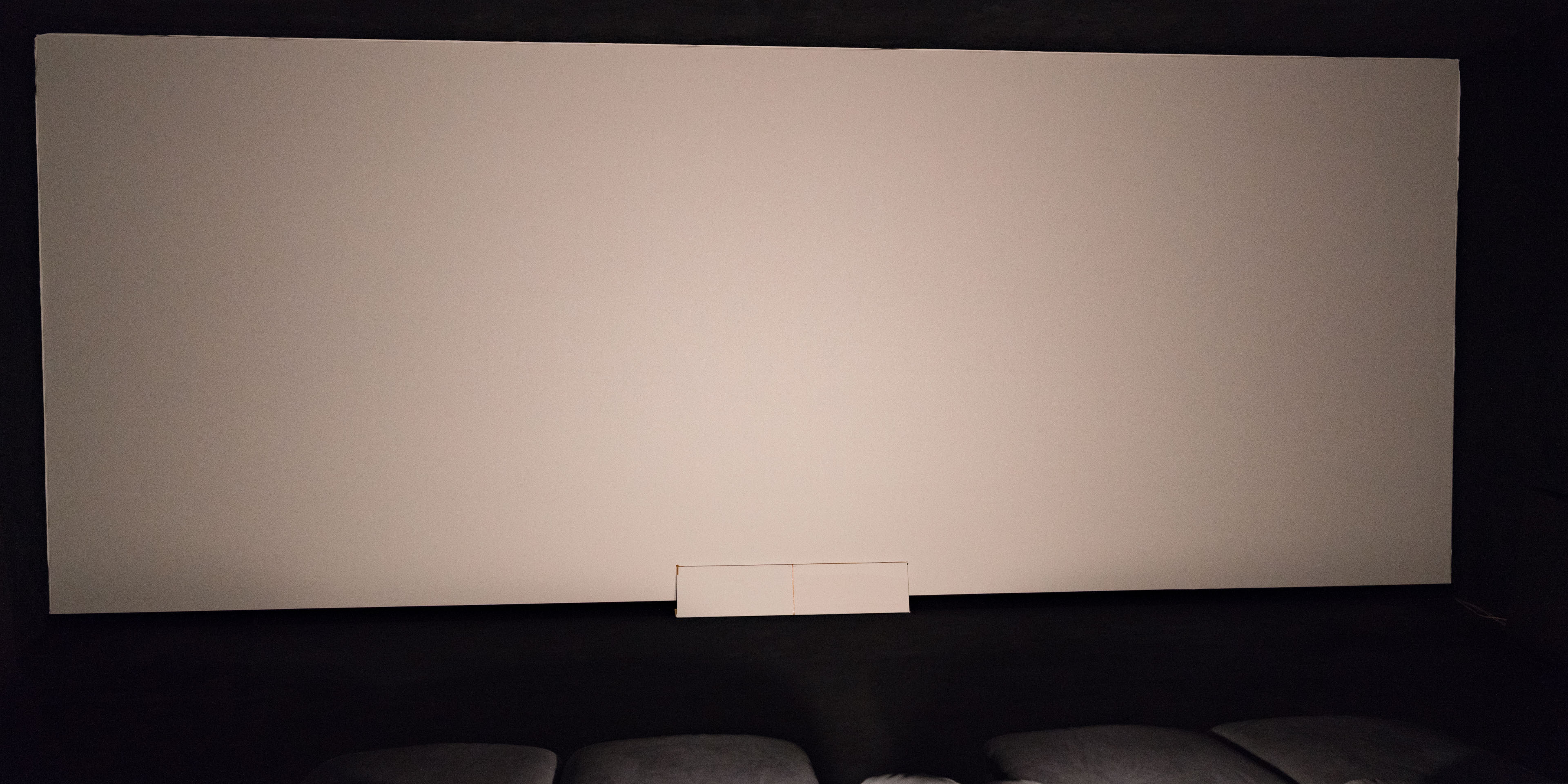

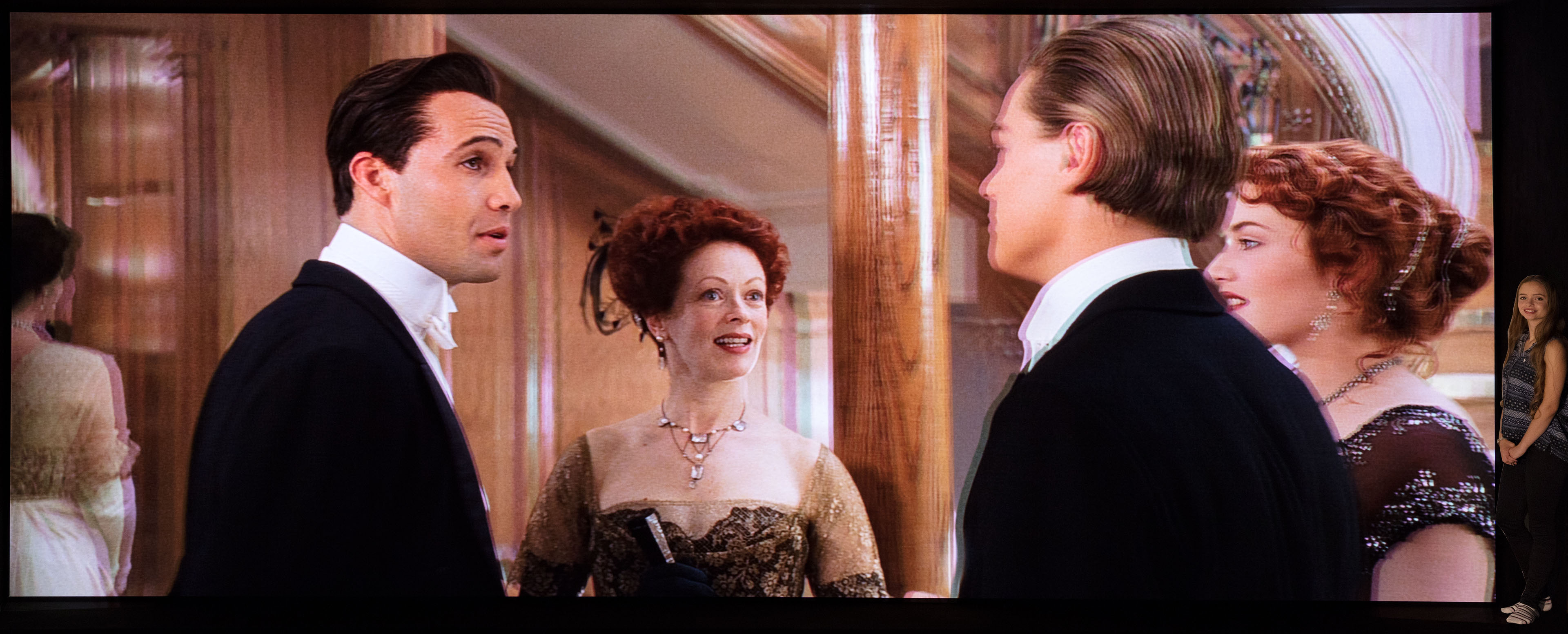

                  • Here a picture of the new finish screen at full 7.3 meter wide the maximum I can do.

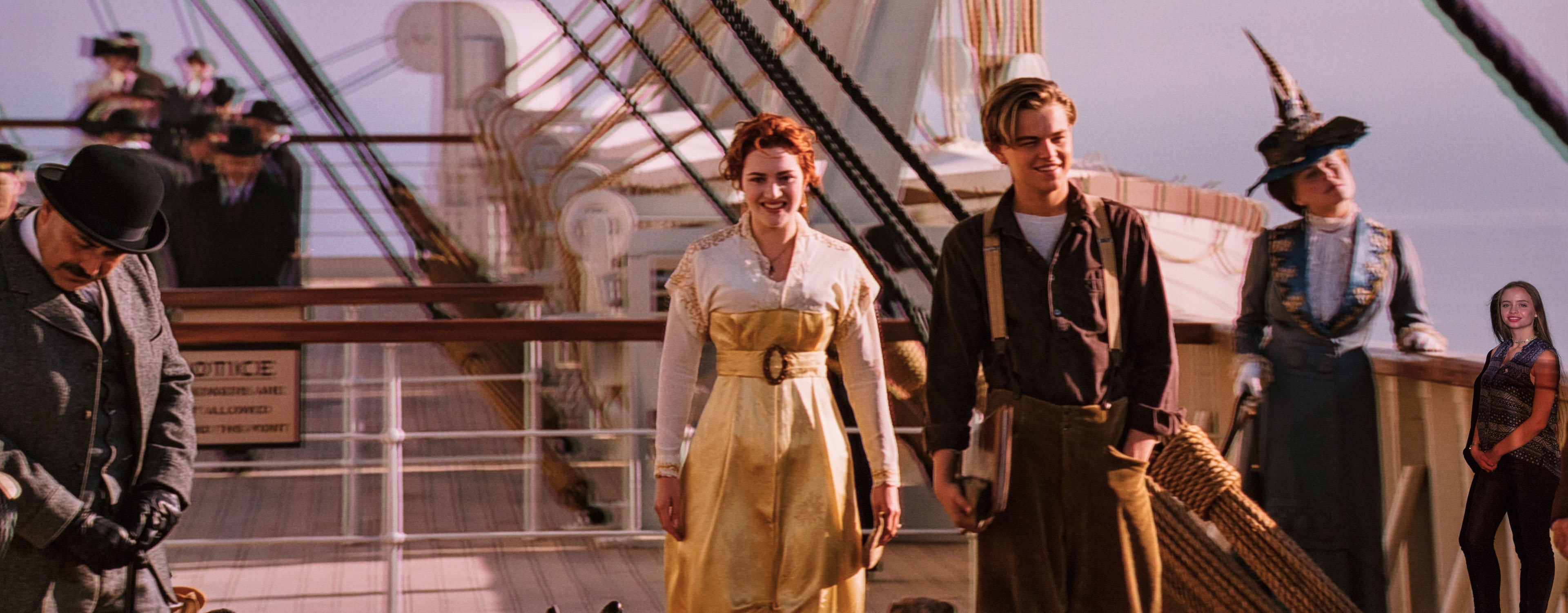

                    • Here 2 more pictures in 2 different versions one with and one without a the boarder but all with the old big guy
                      • Here a last Picture.

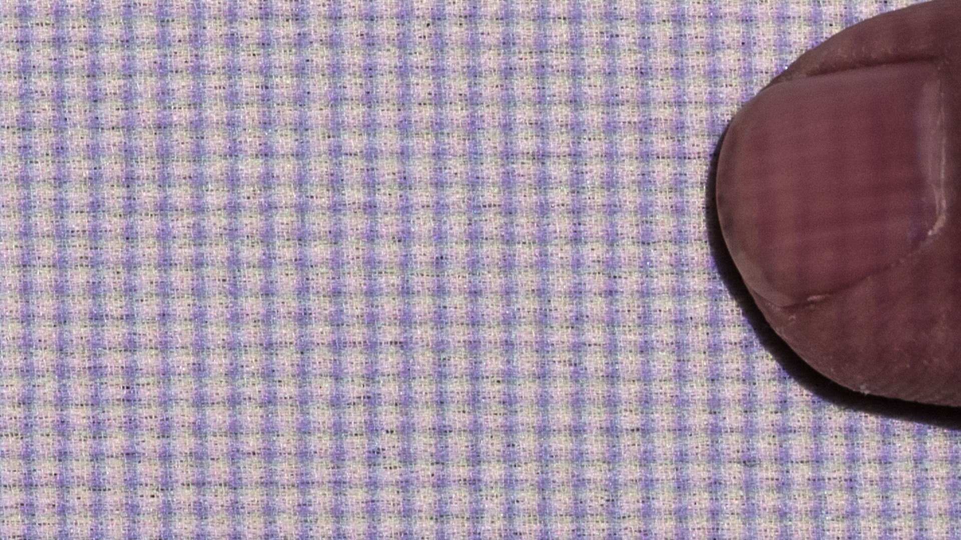

                              • After a 2 weeks trip I am back to Germany.
                                I found a nice picture I like to post.
                                It show the V6 Material under very big magnifications.
                                There you can see the black very very small holes that show the black layer behind the front white layer when you view the full resolution version.
