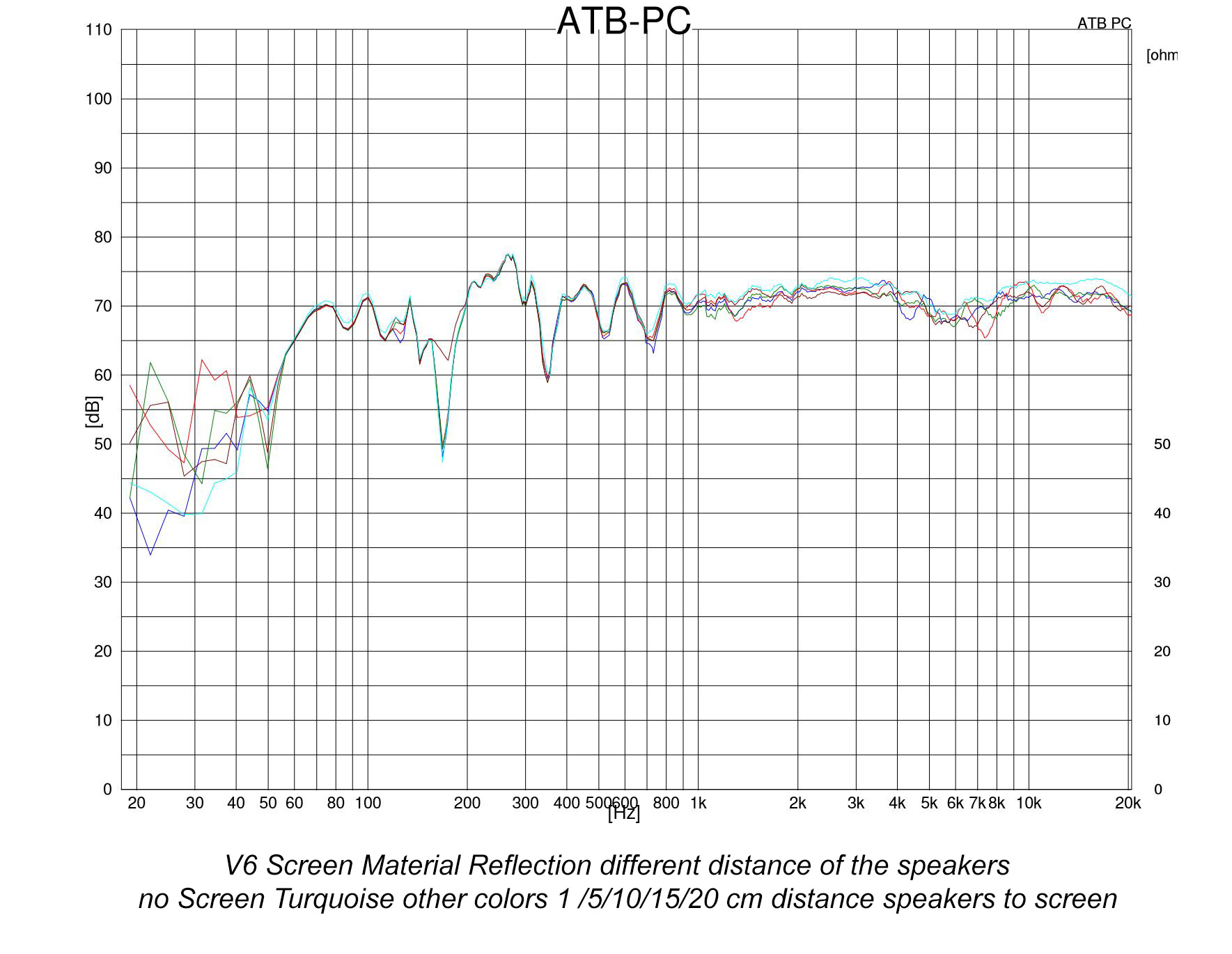

                  Here a measurement that show how the V6 Material act when “my speakers” are behind.
                  Turquoise no screen material the other colors show 1/5/10/15 and 20 cm distance to the screen.
                  The more reflection the more distance.
                  Very nice the screen material was very stable how I use it at around up from 80Hz and the decrease is only 2 to 3 db!
                  Ideal distance is till to 10cm and I plan about 5 cm if this works.

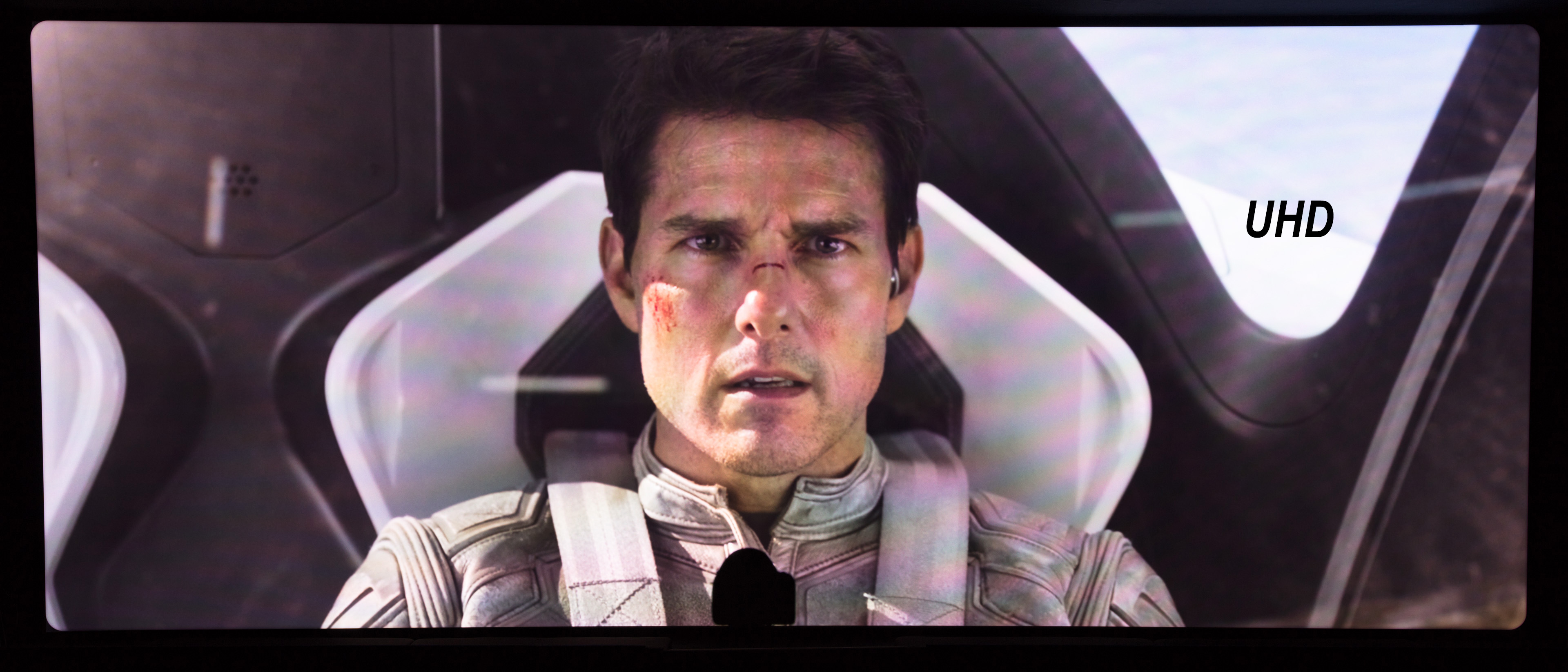

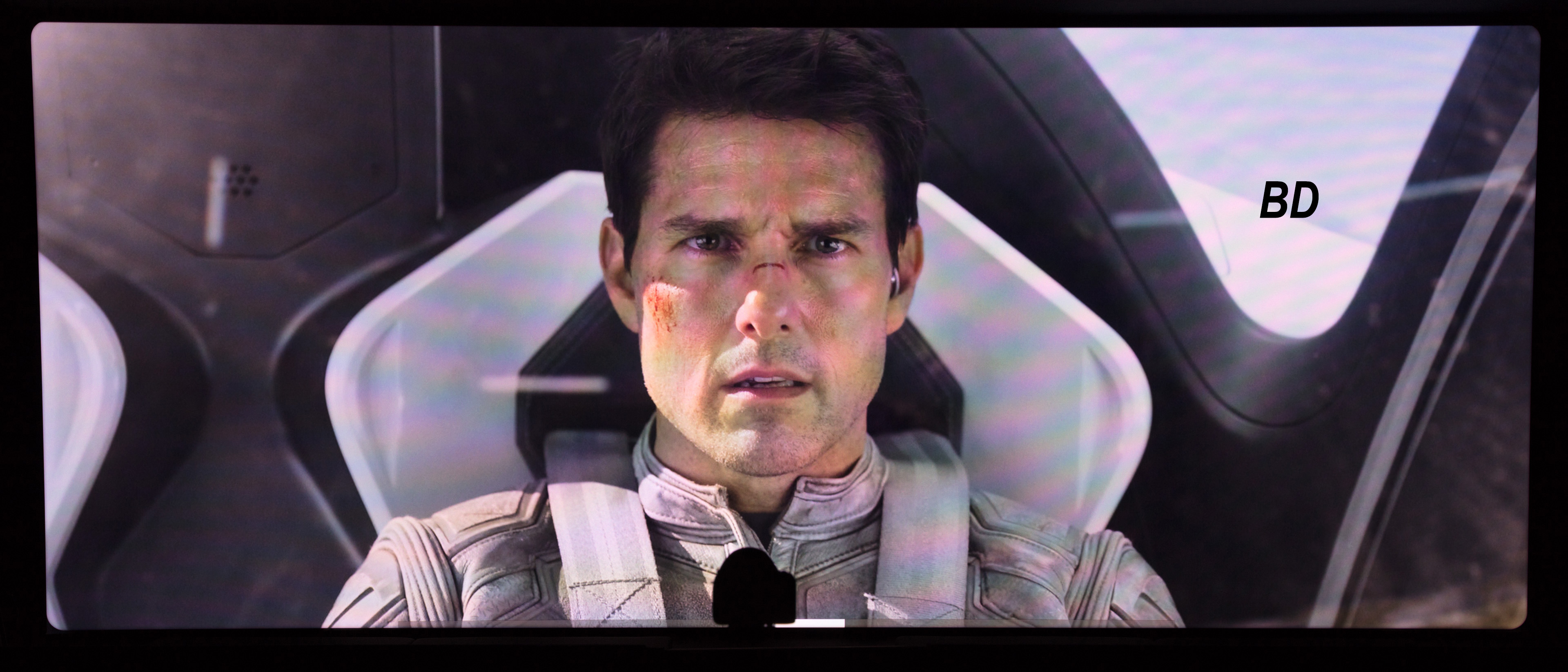

                      I talk about the UHD 4K Disc Oblivion that many people told me that the BD show "more" details than the UHD Version!
                      I doubt it as I can only confirm from he past that most 2K to 4K upcon UHDs are show same Details as BD but never less.
                      But take a look at both pictures!
                      Copy them in full 4K to a Folder and compare it with a 4K Monitor in 1:1 Pixel and you will see yourself.
                      Please note that the Picture Preview not show at all any difference as resolution is to low!
                      So you have to compare the full resolution picture.
                      Pictures was taken in over 8K from the Screen and downconvert to 4K.
                      A bit sad it show some moire effect but ignore it that bug was sometimes there when the Camera is in to good focus.
                      Better move your attention to how much less details are visible with the UHD Version!
                      My Barco Thor had not any processing at all inside and the Oppo UHD Player was output the Signal as
                      "Source direct".
                      Camera had for both pictures fix settings.

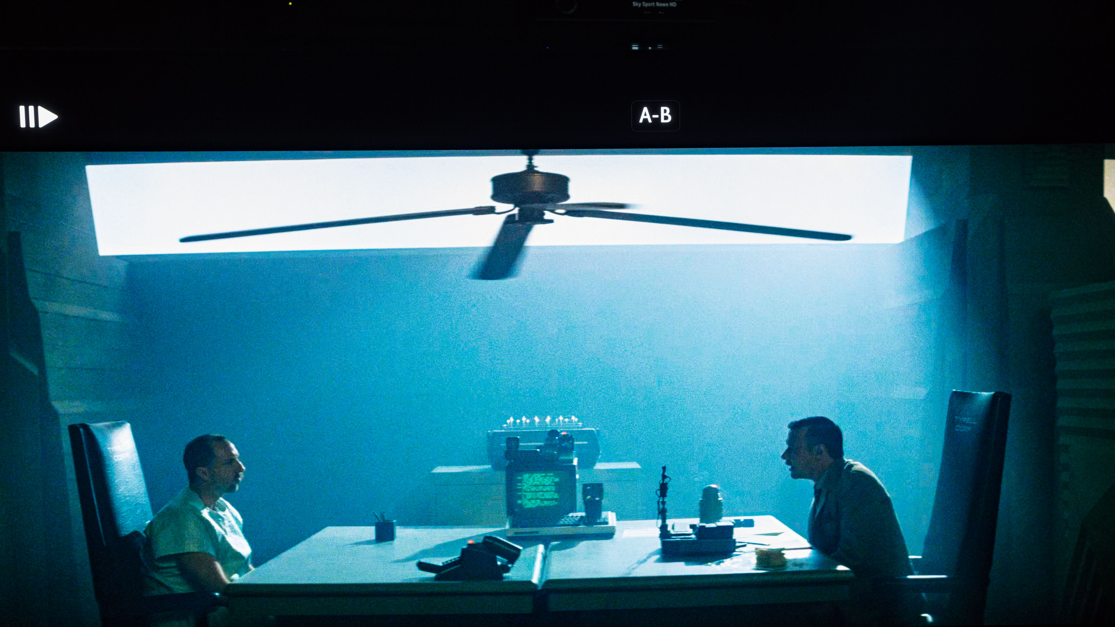

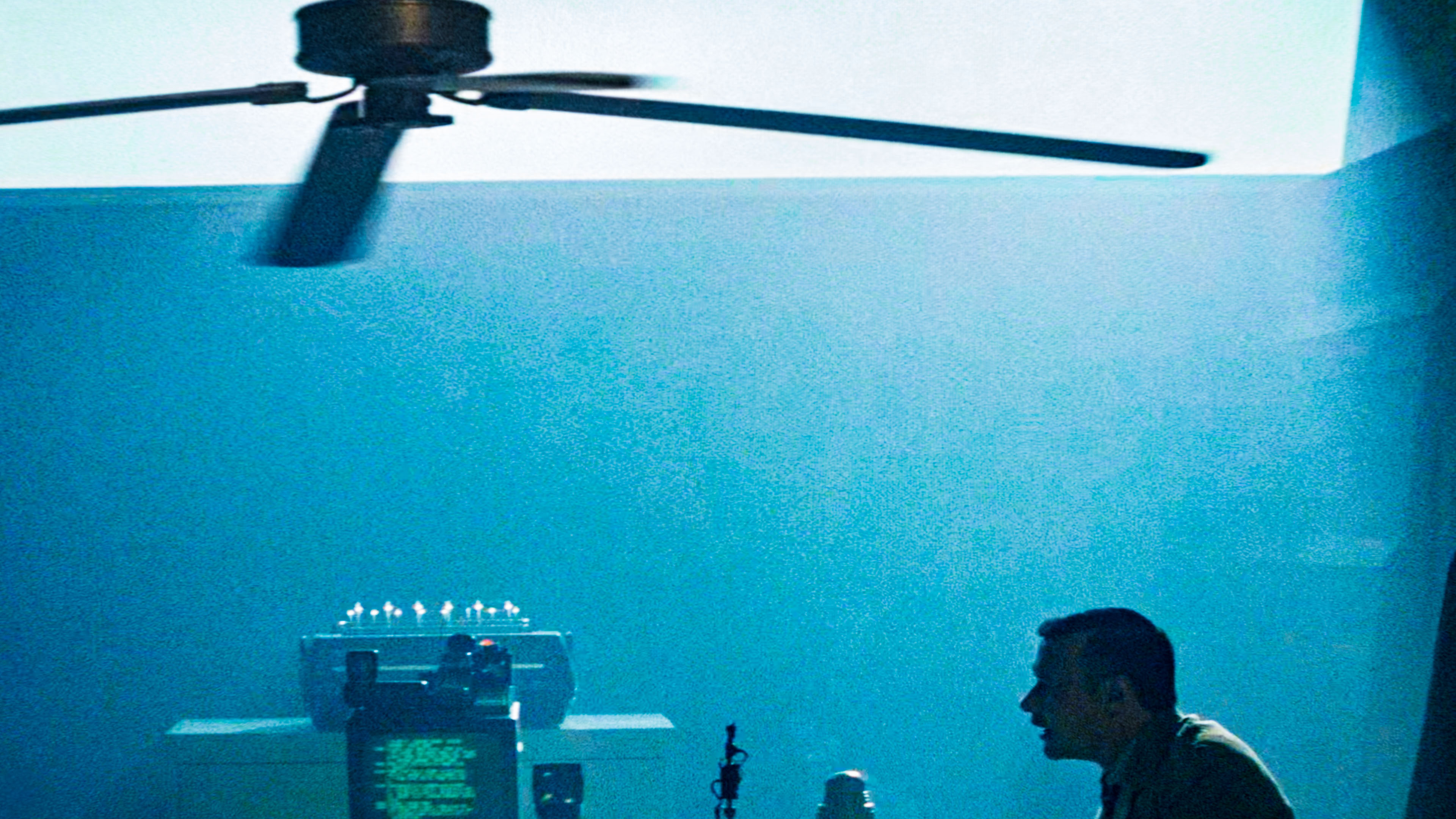

                            • Blade Runner was a very special movie for me.
                              Good 30 years ago I saw it at a big cinema in Munich with the second biggest screen in Germany this time in 70mm and it was one of the last movies I saw in 70mm till today.
                              I was happy to hear this movie comes to UHD Disc.
                              I can’t wait till I got this Disc and final yesterday I try it short first time on my 77" LG 4K OLED.
                              I had hear positive reports about the picture quality and as this disc is one of the rare Warner true 4K Disc I hope for a good picture quality even know that the movie was only shot in 35mm but some parts that show the city was shot in true 70mm.
                              From the beginning on you can see a good picture that show in some seq. a lot of noise.
                              Luckily Warner “NOT” filter this out as it was in the film and it have to be there and visible as otherwise with filtering create other picture bugs.
                              Over all this movie was better than ever before.
                              A lot more details and a much better color.
                              At 7:10 when the this picture comes for about 4 to 6 sec. you can see going at the head from the right person up about 45° to the upper left an area that show in the noise some banding.
                              Hard to capture it in a picture but I suggest to let run a AB Repeat sequence from 7:10 to 7:16.
                              I use the LG OLED for this picture.

                                I wish more UHD Disc have such a Quality or near this Quality.
                                I recommend to buy this disc if you have a good quality setup to see what is possible with a top UHD Disc.
